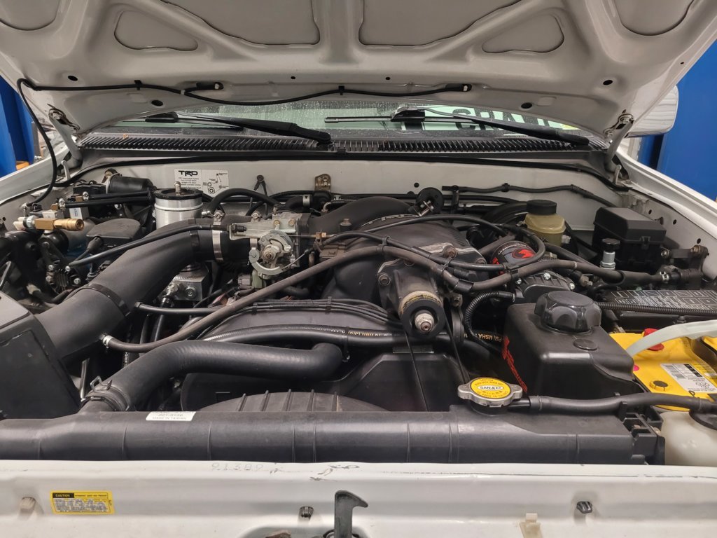

    What do you mean “how are these install typically”
    To me, the install is straight forward. Hardest part is trying to figure out where you want to mount the reservoir, pump, and controller.

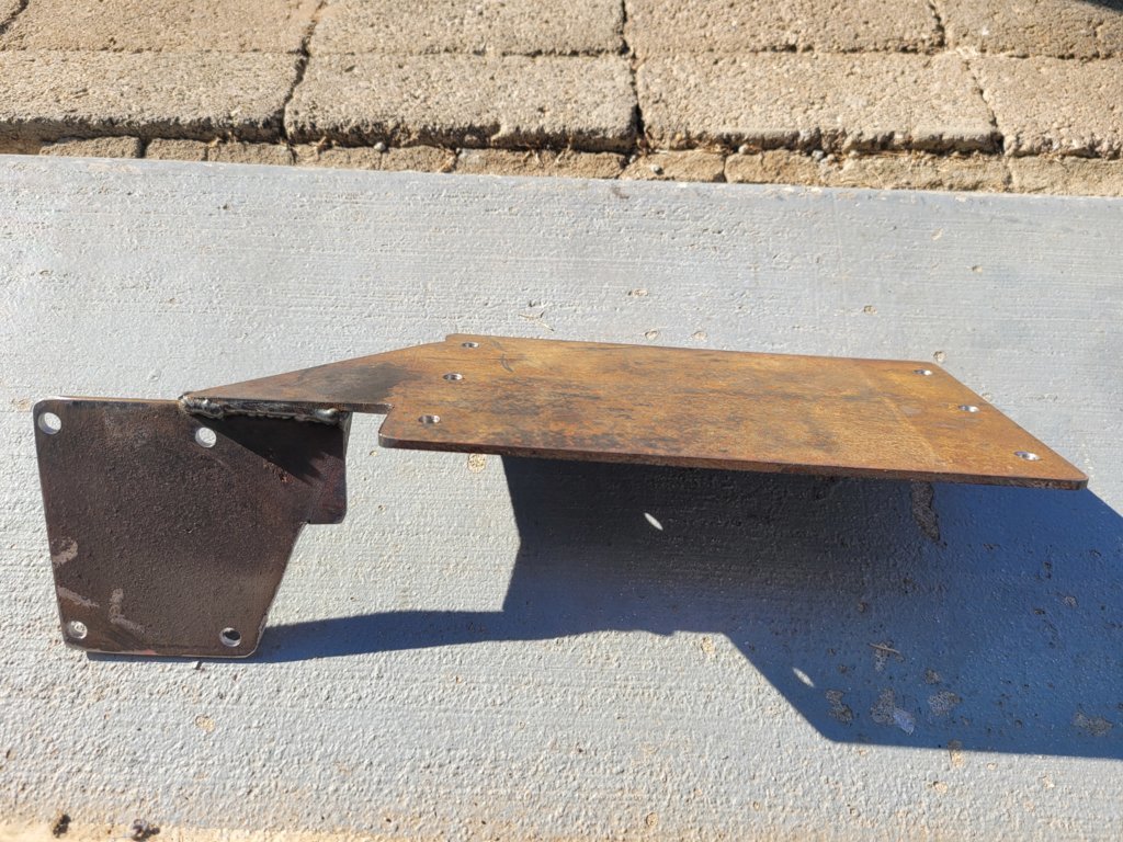

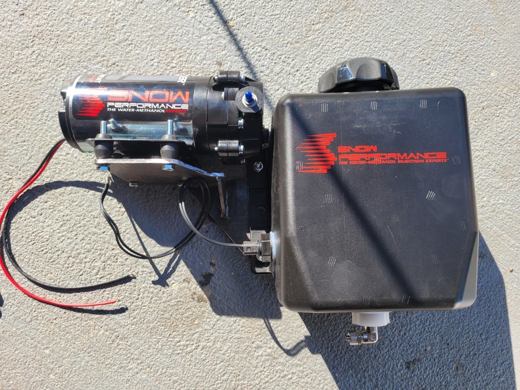

    @TashcomerTexas

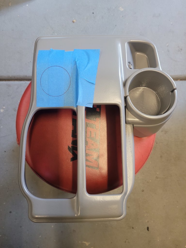

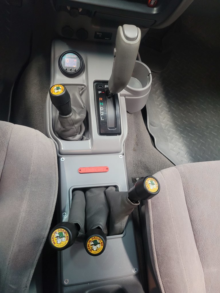

    I opted to fab a mount for the reservoir and pump in engine bay and have the controller mounted on the shifter bezel for easy access.
    The vc50 makes spray adjustment on the fly.

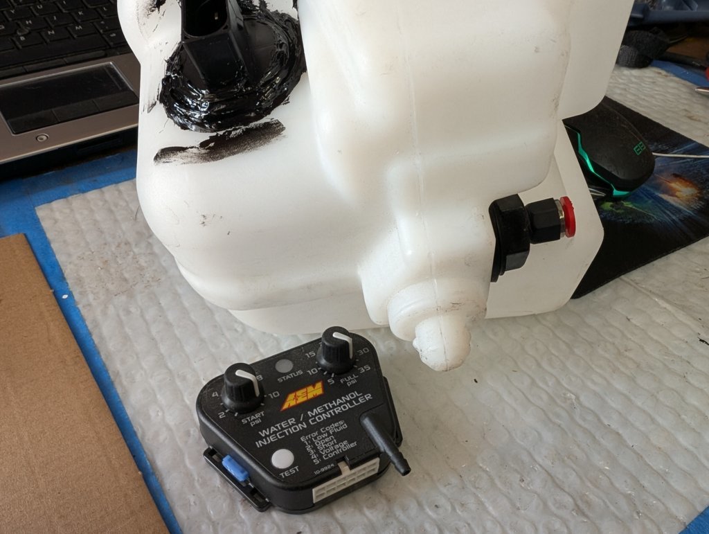

    @TashcomerTexas I drool over the kits that match fuel injection but I ended up getting the AEM water meth kit.
    @02hilux that install is sick, I'd buy that bracket and snow kit in a heart beat just cause of the fitment.

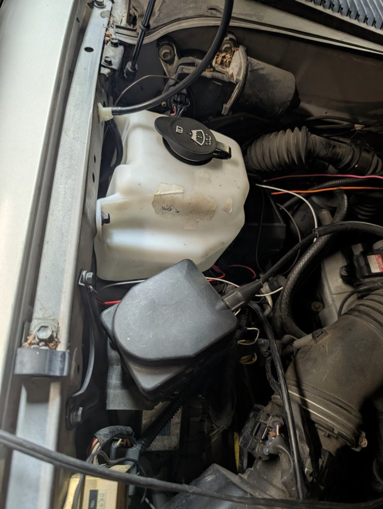

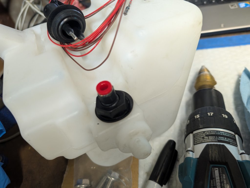

    I ended up installing the AEM pump below the battery on the wheel well metal- I just got a rivet thread chinga in to make it a little better. I bought a pre 01 Tacoma windshield water tank to be the tank and it looks OEM, I really like that. I also bought on ebay another level sensor for the AEM.

    @02hilux in the top right of your engine bay pic you look to have the same add-a relay box I have, do you have brackets of the bracket as well? Mine is on the other side of the engine bay but now that I put the water tank there I'm game to relocate it and hot damn yours looks so OEM and clean with that placement.

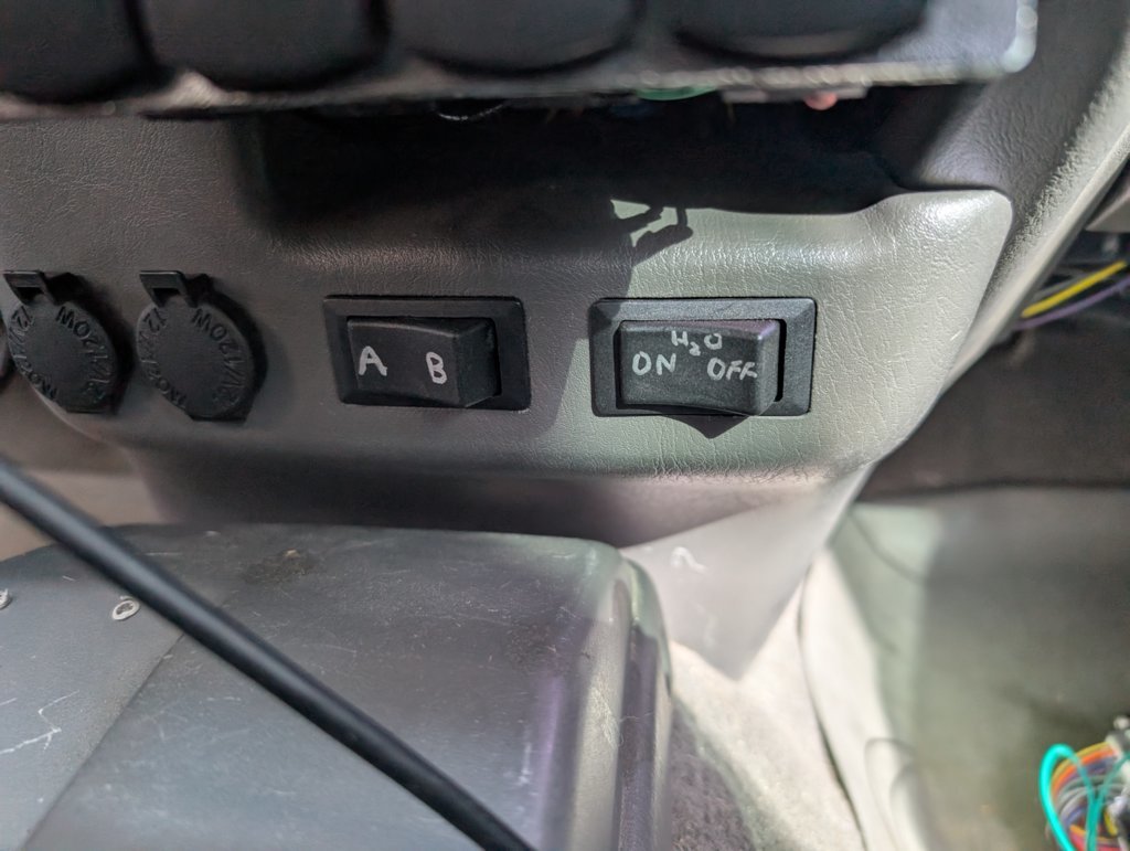

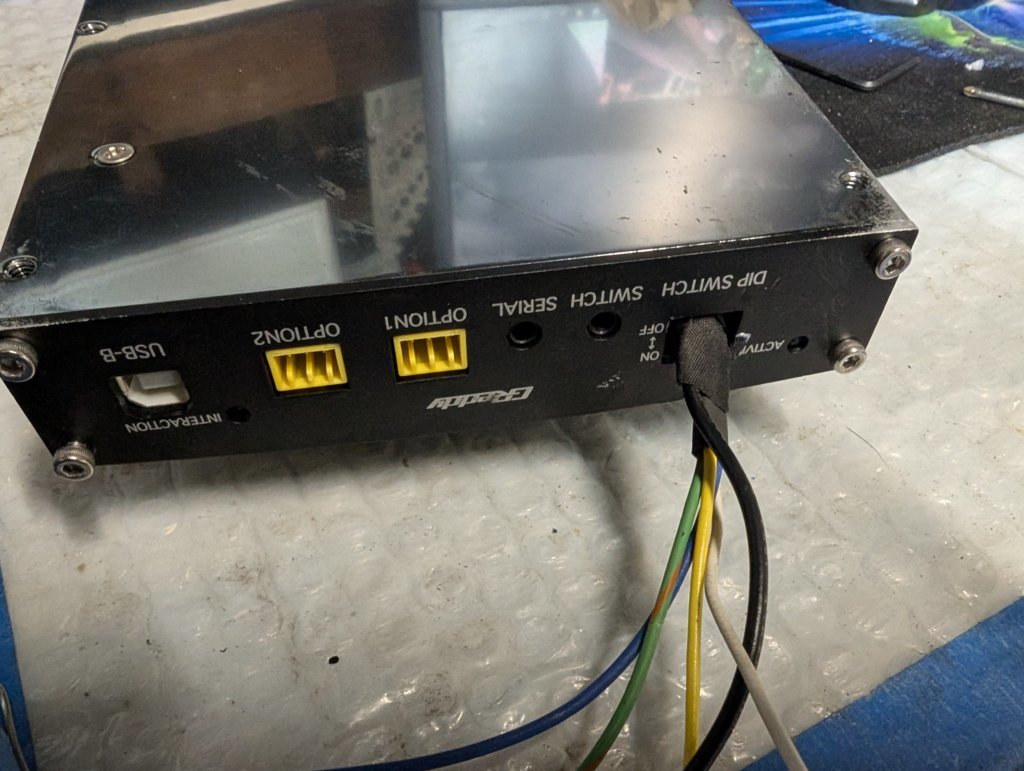

    Oh yeah, not clean but also installed a switch to turn the system off so if I'm out of fluid its not running/pumping dry. ("H2O on/off on the right, on the left is a remove Greddy EMU map switch mod).
    Greddy EMU map switch mod- desolder the board mounted switches, solder on wires to remote switch- can switch from "91" to "E85" fuel and ignition maps.

    The bracket is literally 1/2” wide flat aluminum, bend to shape. I hate the look of random stuff being stuffed everywhere or having exposed wiring harness throughout the engine bay and cab. I like to keep the truck clean looking and original as possible. A pet peeve of mine.

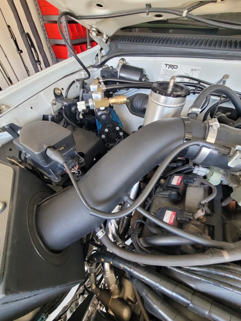

    Here’s my compressor placement. Yes, on 42 and still have cruise control and all the factory accessories.

    That’s exactly where I figured I’d mount it. Nice
