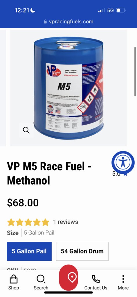

    What supplier do you get yours from? Called around to some auto parts stores that are listed as VP retailers and nowhere seems to have the 5gal of VP stuff.

    #197244
    6,273
    Planet: EARTH

    yea but what I’m getting at is the 5 gallon is available so I’m not sure why the vendors you’re calling are saying otherwise.
    try to have them order it?
