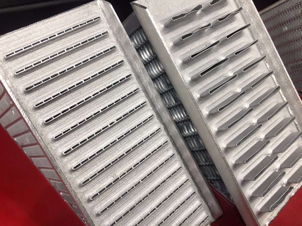

    It was a special radiator that I had made with what is called EXTRUDED TUBE DESIGN,
    the aluminum is extremely thick and weighs around 35 pounds compared to the stock radiator at 10 pounds.
    It can handle any heat situation and keep the truck at 175-180 degrees and will probably outlive the truck

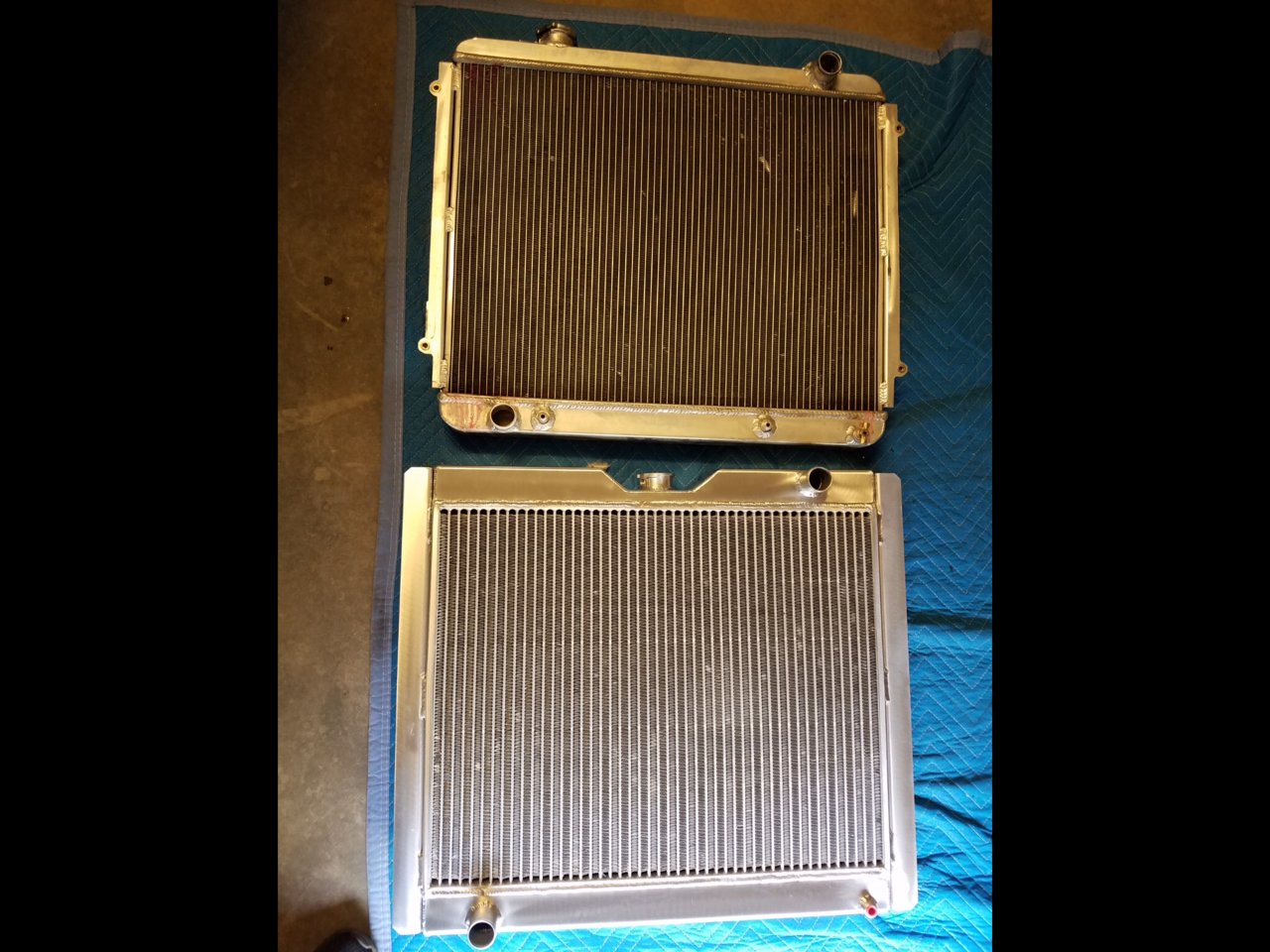

    Got to ask, how much you paid for the custom radiator?

    More than I should have,
    but you should be able to have one made (not extruded) for around 600-700

    The bottom one, has a thick U channel all the way around and the top and bottom tanks are welded to the channel frame too
