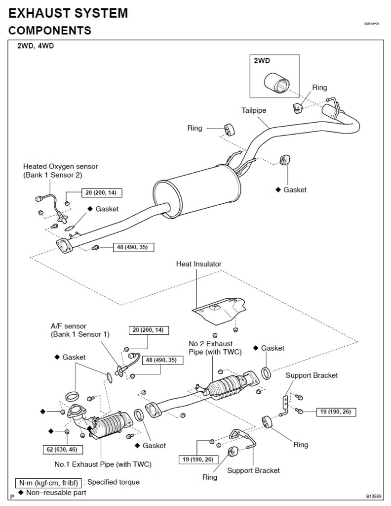

    Where do people suggest having the new AFR sensor bung welded in? Near Bank 1 Sensor 1?

    Pre-cat

    Innovate says 24" from the turbo. Both of my bungs are about 18" after the header collector, well ahead of the CAT. I suspect there is some flexibility so find a spot along the down pipe that is easy to reach for maintenance yet out of harms way at the same time.

    Hmm okay. I guess I was thinking if that's where Toyota put the factory O2 sensor it would be a good place for the AFR one I'm getting from AEM.

    Mine is a couple inches in front of b1s1. Also note the sensor has to be angled almost vertical to avoid any sort of condensation forming on the sensor.
