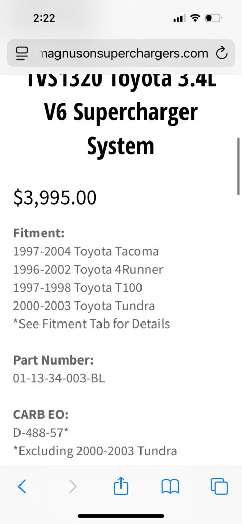

    Crap kinda hosed here. Just did a smog check and the guy says i didn't pass because the carb eo number is for 1995 to 2000 year Tacomas and printed out the carb d-425-4 section 27156 letter saying as much.
    Is there any updated doc or maybe something from Magnuson that addresses this should be applicable all the way up to the 04?

    The Magnuson CARB EO is D-488-57 not D-425-4.
    D-425-4 pertain to TRD, not the Magnuson.
    https://ww2.arb.ca.gov/sites/default/files/aftermarket/devices/eo/d-488-57.pdf

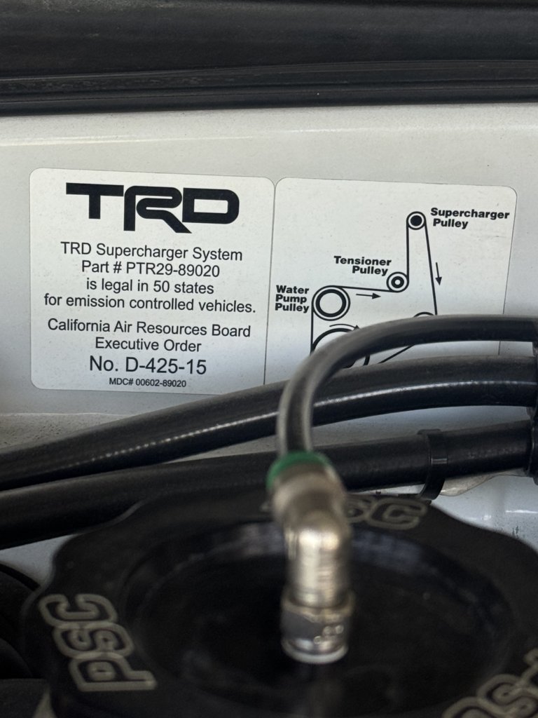

    D-425-4, which is for a 1995-2000 TRD SC:
    https://ww2.arb.ca.gov/sites/default/files/aftermarket/devices/eo/d-425-4.pdf
    D-425-15, is the updated TRD SC for 1995-2004:
    https://ww2.arb.ca.gov/sites/default/files/aftermarket/devices/eo/d-425-15.pdf
    Image is from my 2002 3.4 SC

    My blower has TRD in the cast so i need to get the TRD applicable sticker in your second post as this smog guy has the tism.
    Like im not even mad, dude is doing his job at 100%. Technically I've been riding dirty all this time.
    I am peeved that when providing that additional EO number he said it doesn't state it supercedes the prior one and for suggesting i go to the BAR like thats some Sunday stroll.
    At a dealership now trying to get the new sticker and will also print out the d-425-15 as well and cross my fingers.

    You won’t be able to obtain the sticker from Toyota as the part number is obsolete. eBay or other site like Etsy will be your best bet but you don’t need the sticker, a printout from CARB with the appropriate EO # is efficient.
    I would visit another smog place.

    Man, I need a CA BAR to get me that in writing. With the D-425-15 letter not matching the D-425-4 sticker he is wanting to see the -15 letter specifying that it supersedes the -4 letter/sticker. At this point I'm thinking of just going to any other place as no other place for the 20+ years this truck has been getting smogged with this blower has ever had an issue.
    Edit: "Part number" for the carb EO sticker that applies to all year model 3.4s among other kits as well: the MDC number (Materials Distribution Center) is 00602-89020
