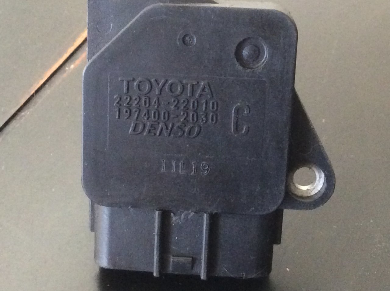

    Well I think there is a problem with these sensors not being OEM.
    I bought one from this seller two years ago and had no problem and it was 45.00 or so.
    I bought two last week at 16.00 each and put one in yesterday and the truck was running great.
    Today I can’t go over 4000 rpms without the engine boggling down and my AFR is at 9.5,
    Screaming rich.
    I put back the old MAF sensor and the truck is running excellent except the trims are high.
    I open up the 2nd MAF sensor that was going to be a spare and it had a sticker that said MADE IN CHINA.
    I’m thinking he’s selling fake one now, not OEM DENSO that he had before now and the stamping is different from the original DENSO I got before.
    Maybe one is defective but I’m returning them both.
    I not sure DENSO made these in China tho?
    Guess I might bit the bullet and go get one from the local dealer.

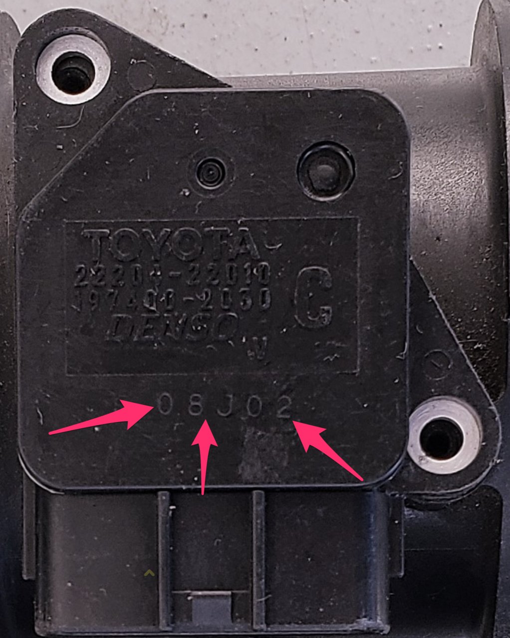

    The fake DENSO electronics usually don't have a date/serial code stamped into them.
    1997tacomav6[QUOTED] likes this.

    This is the one that I got, says made in CHINA on the bag.
    Truck will not run over 4000k with this sensor without bogging and stumbling

    Man these fakes are getting good. That big C on the one you got that is problematic seems a thinner font than the "authentic" one I posted. Pretty much a shit show out there to find reliable good DENSO parts these days :(

    Interesting, yup the “C” is smaller on mine assuming the photo you posted is an ORIGINAL is thicker.
    Didn’t notice this till now,
    Oh well off to the dealership

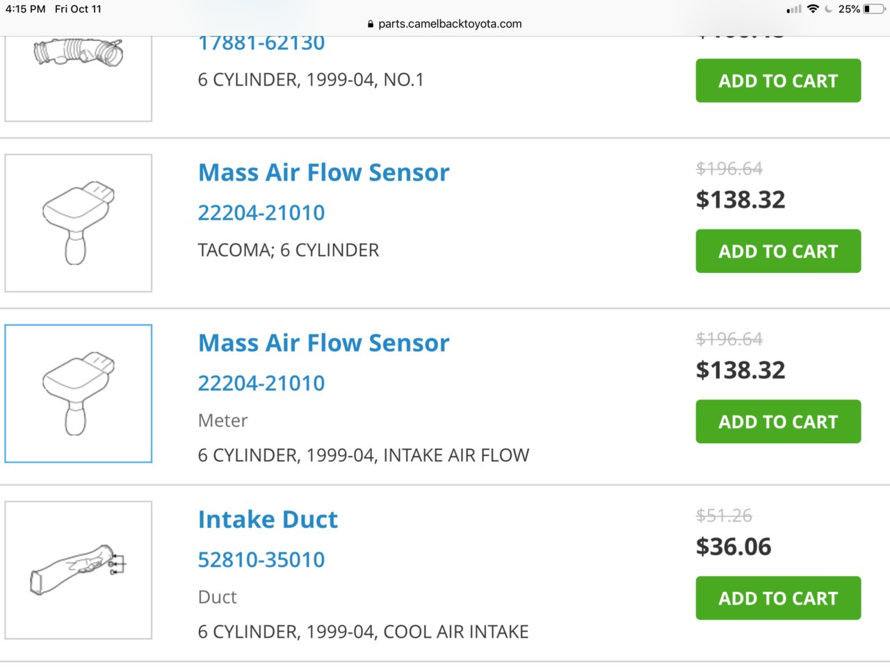

    $220 At Stevinson Toyota East

    I know. I was going to pull the trigger on that. But I’m just going to put back my original sensor after I clean up.

    Camel back has them for 138.00.
    If there’s one thing I know it’s best to have OEM sensors for these trucks

    That’s a better price than $220.
