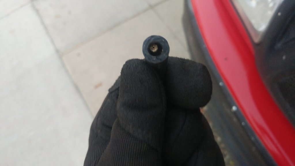

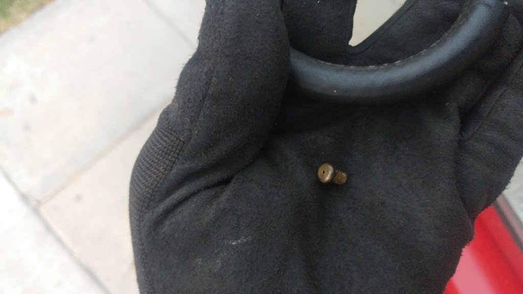

    The restrictor jet? We have those, I pulled mine out because it was lodged in the vacuum line sideways. Slightly better throttle response with it out though some people say it makes you more likely to run rich I think.
    Its in one of the vacuum lines going to the bypass valve, I pulled it out with a pair of needle nose pliers. Over time it got loose and lodged sideways so it wasn't doing its job anyhow

    I found the photos of when I pulled it out...you can see it stuck inside the line
    I had to cut the line to get it off but it was still long enough to reattach. Just pulled that sucker out and set it aside.

    Connects to the bypass valve if I remember right. Mine was sucked halfway down the vacuum line but it should be adhered at the front of it
