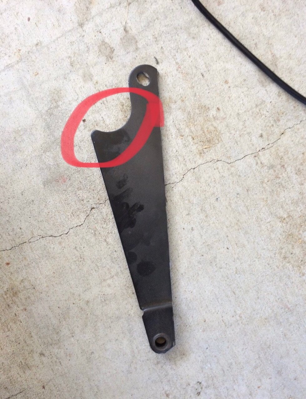

    Originally on my supercharger the grey unit, it came with a bracket of some sorts like that, dont remember.
    I removed it when I updated to the dynamic tensioner

    Is that belt tensioner bracket available still?

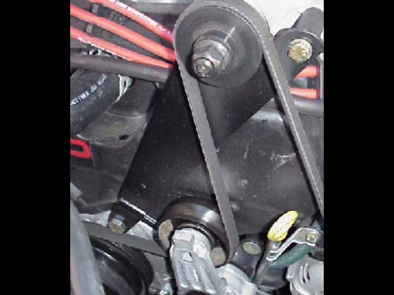

    I got one of the brackets and modified it to use with my dynamic tensioner, for nose cone support. If you think about it, there’s quite some leverage from the belt/pulley to the point where the SC bolts to the intake.

    Yup, I know, running a 2” pulley I could use one,
    where can I find one??

    i need to find a bracket because my block wont take the tensioner.. its the whole reason im building a new engine.. the bolt hole for the dynamic is rotted out.

    I think I have this bracket on my truck. I’ll take a picture tomorrow.

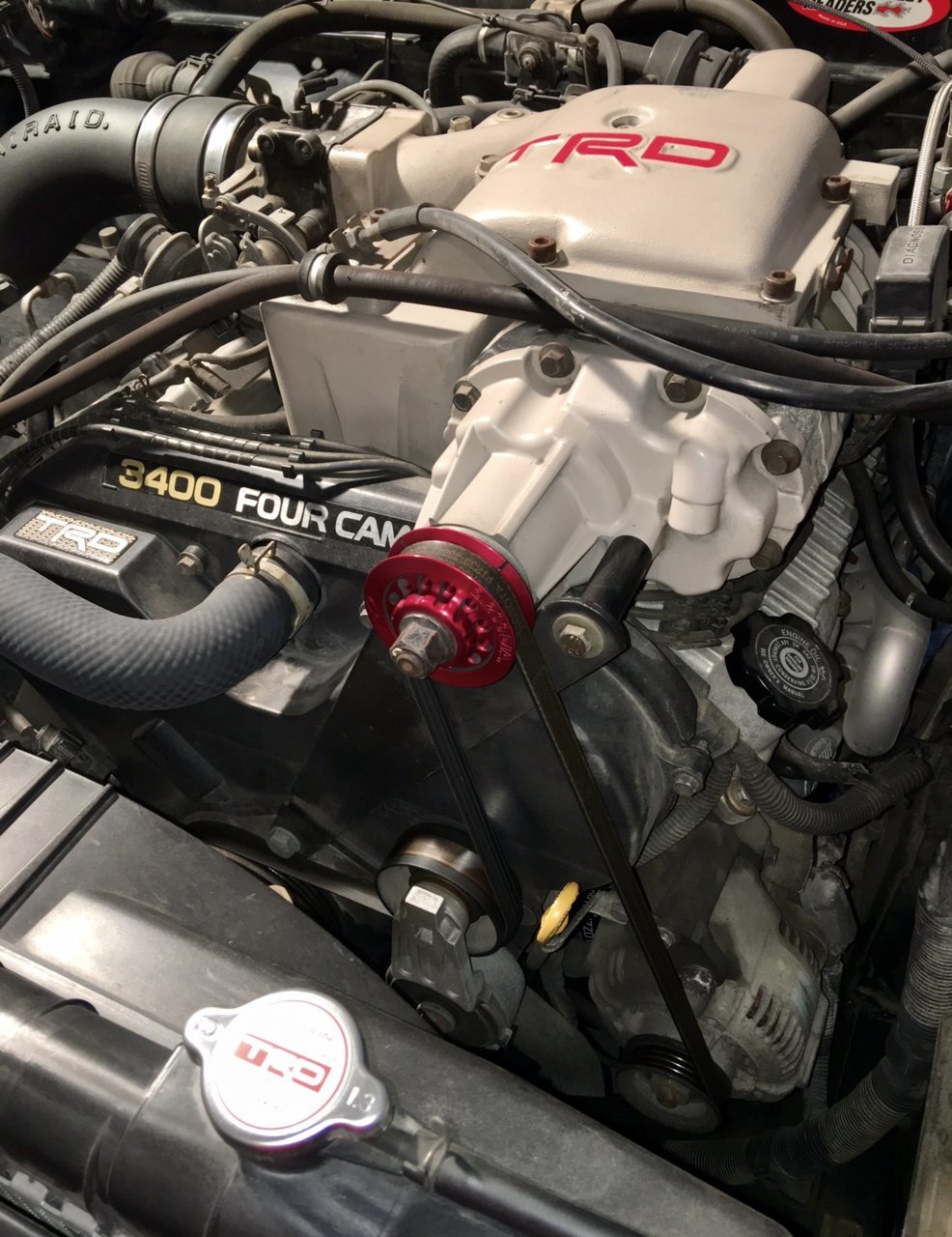

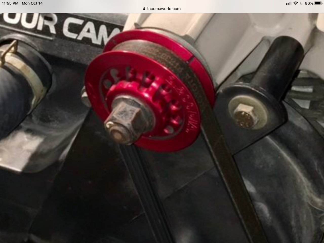

    Actually I’m very surprised because all these supercharger should have the added support because the nose sticks so far out and is held on by those small bolts with 12 pounds of torque.

    yea i believe it would help over time to have it supported. the belts under some good tension too. its gotta be hell on the snout over time

    It would definitely help out the pressure on the bearings too.
    This is my goal to support the front of the supercharger now essentially cutting the one side off of the bracket

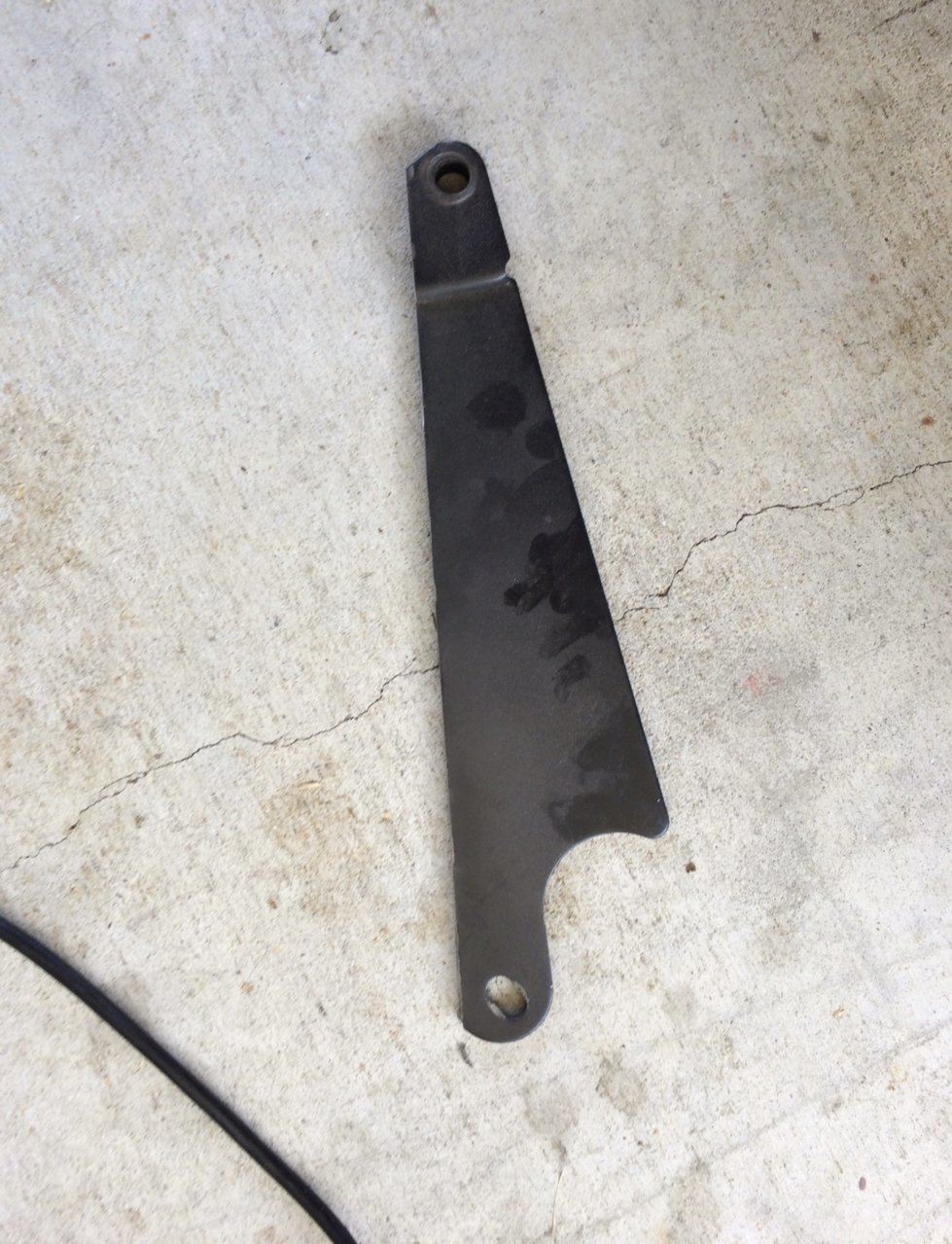

    I believe his is complete.
    Does the the inside valley actually touch the snout for support under the nose
    or is it just the support at the bolt that goes into the snout housing.
    I can see one could put a rubber gasket inbetween that area

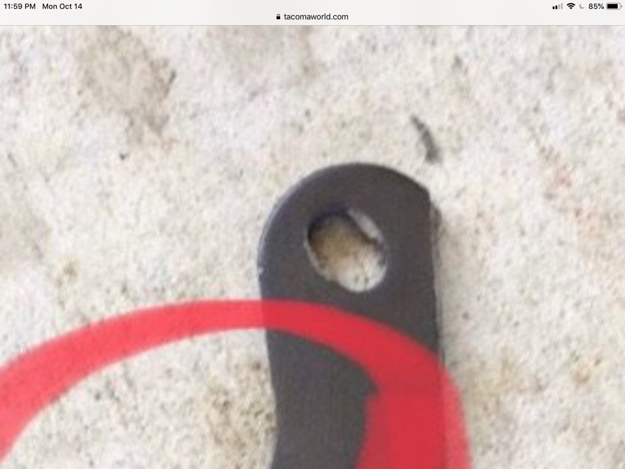

    Does the bracket with the curve actually touch the nose section and give it support or is it just supported from the bolts?
    The bolt hole looks oval like there mine some small adjustment to push it up against the snout?
    I’m thinking that with that pre made valley under the snout it could easily do that with a rubber gasket too, fuel line cut in two as a gasket fitted in the valley on the bracket
