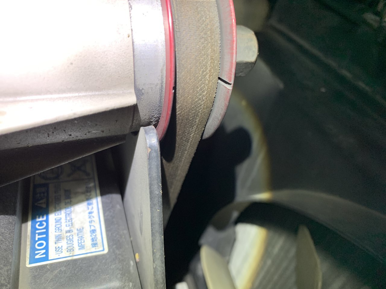

    I believe it does touch or is very very tight. Not sure if it was designed to rest on that part of the bracket or use the upper bolt to support it. I will check when I leave work. However, I bet it’s slotted at the top to accommodate small variances from vehicle to vehicle. That way the bracket isn’t pulling down on the nose cone just to get the bolts through.

    Ok thanks, I definitely like this support, I would think with the curve was put there for a reason for possibly adding support, cuz there would be no reason for that added section at the top, but who knows.
    Regardless this support will definitely take stress off the supercharger.
    The belt tensioner is like
    INSTALLATION TENSION 120 lbs
    SUGGESTED TENSION RANGES 60-80 lbs

    Please take measurements of the bracket and post here so we can make clones!

    Actually there is a small gap all the way around.

    I like the idea of support. The new setup doesn’t have it. BC68E627-2578-4466-8FF2-7EC1D0D2F5FA.jpg

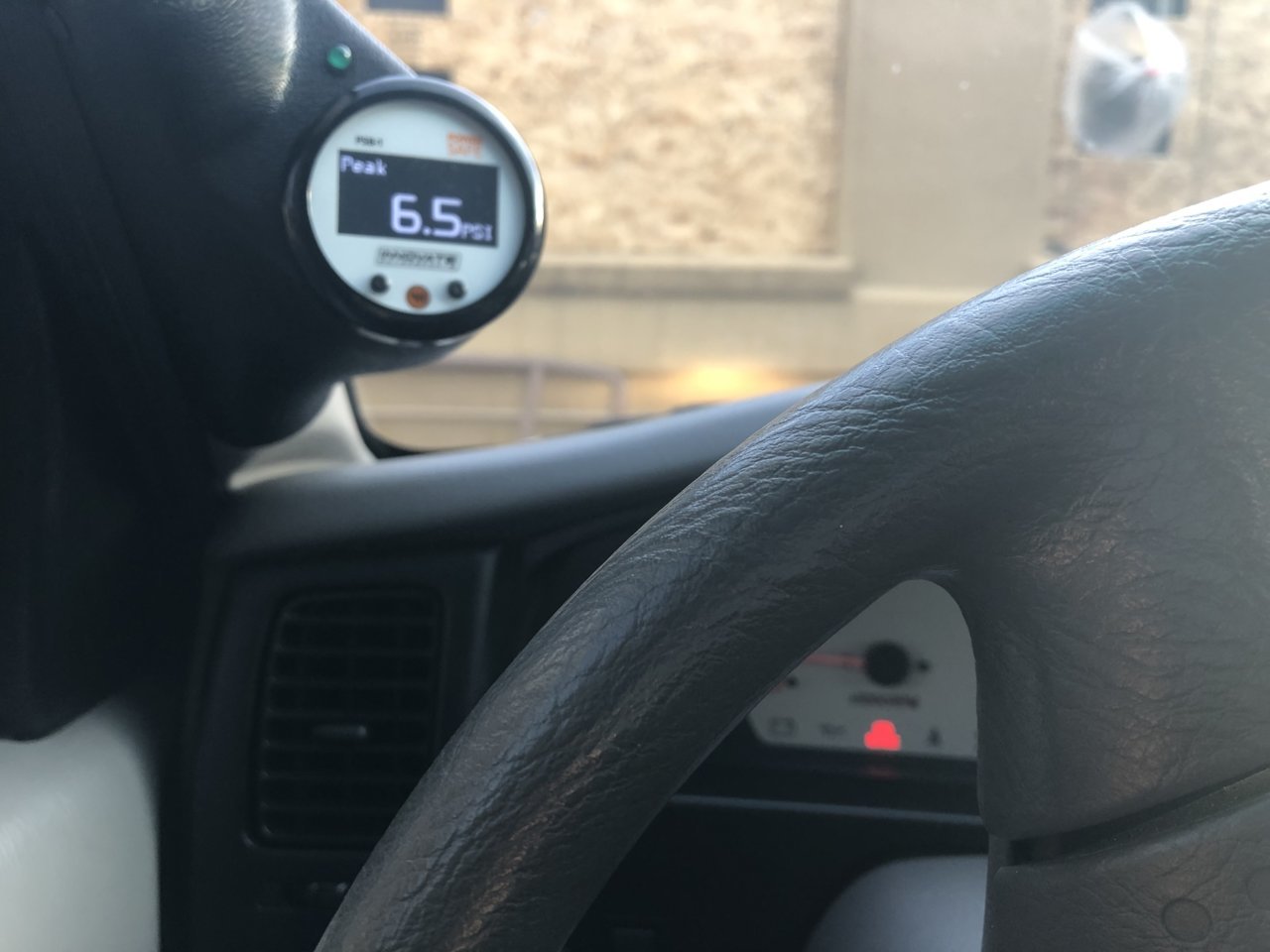

    I’ve been doing 6.4 PSI BTW on stock pulley and I think I can do 7. My AFR is 11.5 to 12. ECU still adjusting so it’s running better and better.

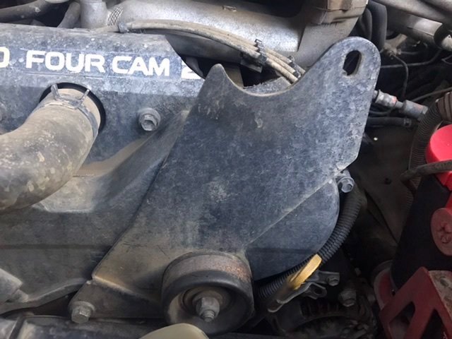

    I took a pic of the bracket on my truck. This probably doesn’t help much but here it is.

    I got the idea tho.

    It’s got to be more than the 1 bolt at the bottom. I could of sworn there were 2? Maybe I’m wrong.

    There are 2 before the bracket is modified.

    Your ECU will adjust,
    The boost will vary a little with the weather conditions.
    For you Cooler days you will get more boost 6.5,
    Cooler wet foggy day or rain maybe you will see 7.
    Hot days maybe 6.
    If you drive up to the pass 10,000 feet maybe you will be at 4.5-5.
    Guessing because each truck is a little different
    This is how altitude effects a supercharger unlike a turbo.
    A turbo compensates for altitude so a turbo if it has 8 pounds of boost at sea level it will
    also have 8 pounds at 10,000 feet too.

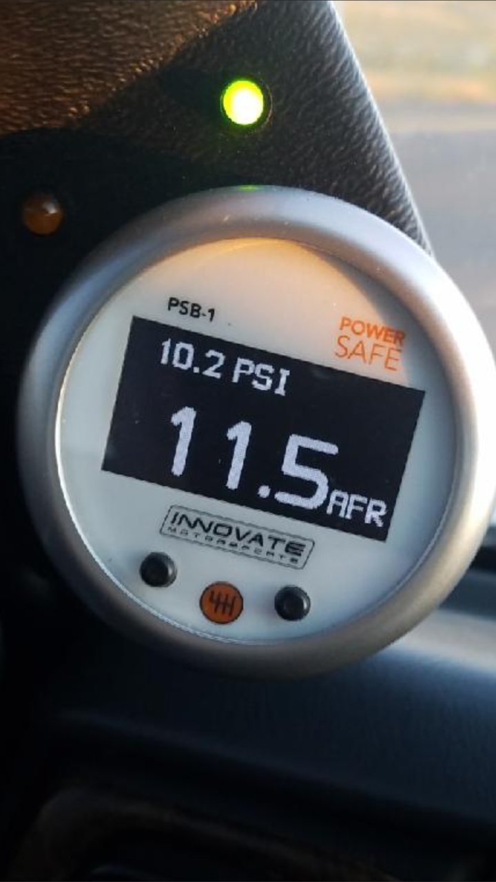

    Right on. I’m 200 miles into it after the reset of the ECU and the AFR went from 11.5 to 12 in boost. It’s all still adjusting. I can see it in the AFR. It’s getting better and better. Truck is running better and better.

    79FBB04B-6301-4C35-9629-855F37285000.jpg Broke the record for me that is.

    Thats a great start on a stock pulley. :)
