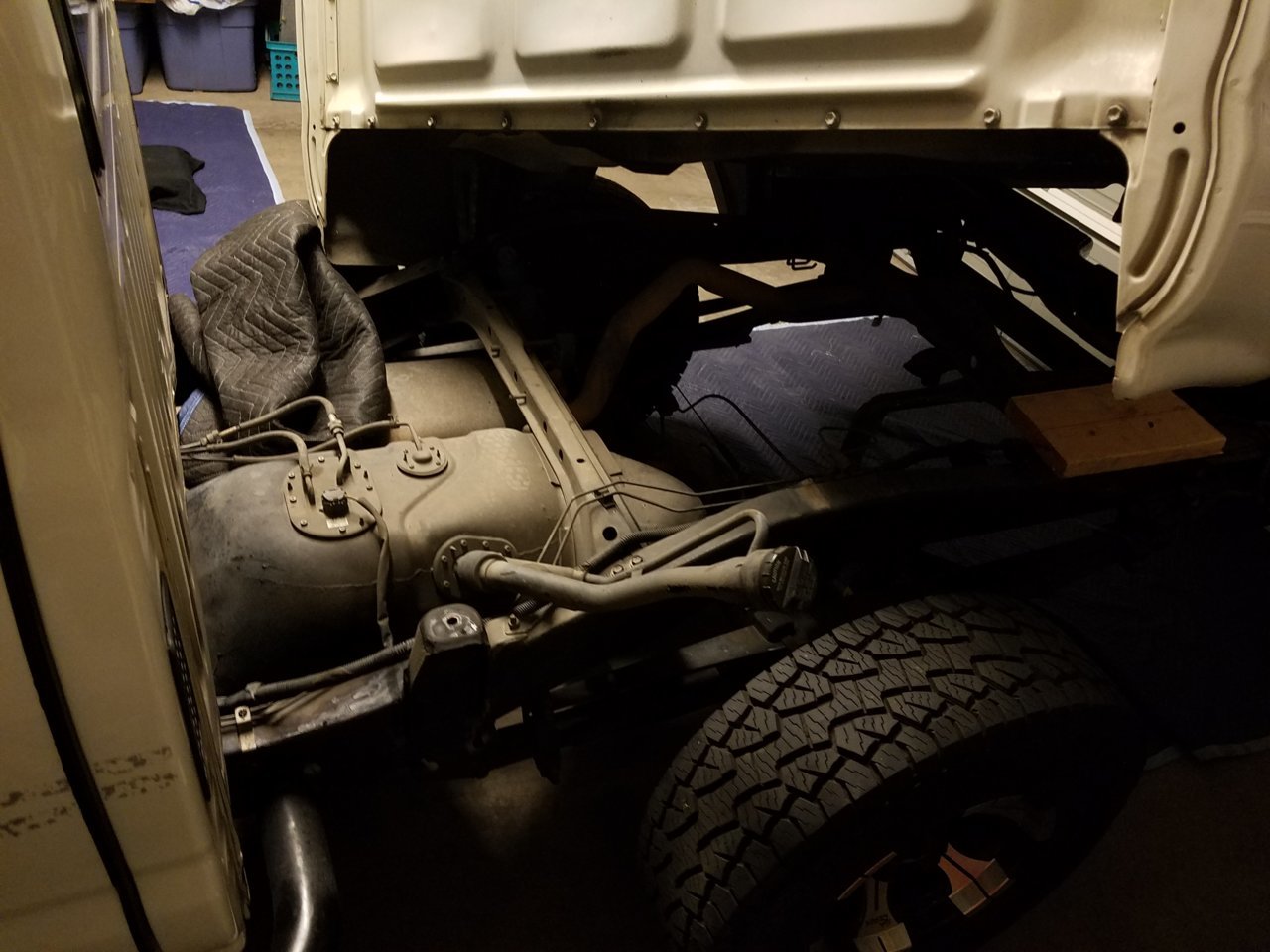

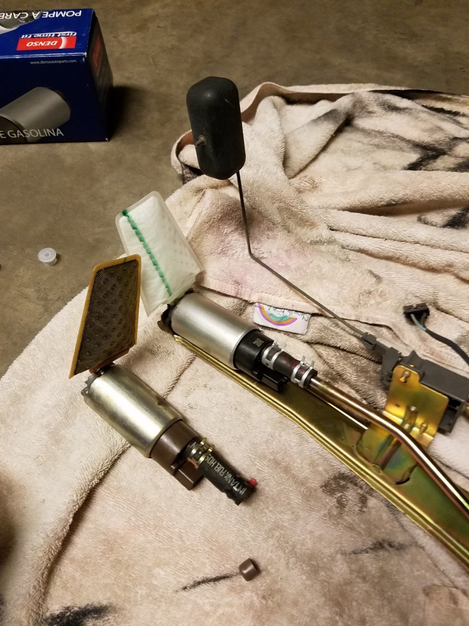

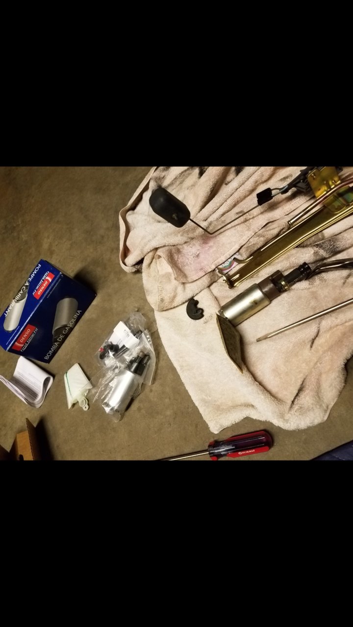

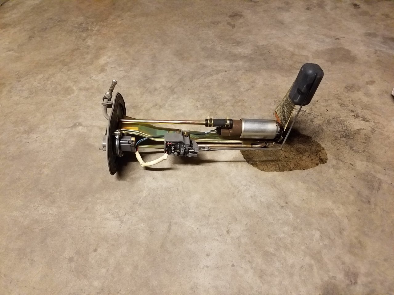

    So I’m pretty sure my issue was a failing fuel pump. It worked fine at idle and had good pressure but at speed or boost it would run lean and long trims were at +25 where before they were -+5.
    I got a MAF lean code today so I said to myself this evening it’s time to replace that pump.
    4 hours later taking my time it’s all done and my fuel trim are much better at -4.
    I reset the ECU so it will take a while to see the final numbers when it’s relearned.
    So my problem was the fuel pump not the MAF.
    I ended up just tipping the bed on its side at an angle after removing all the bed bolts.

    your running a stock fuel pump with the blower and dont have issues?

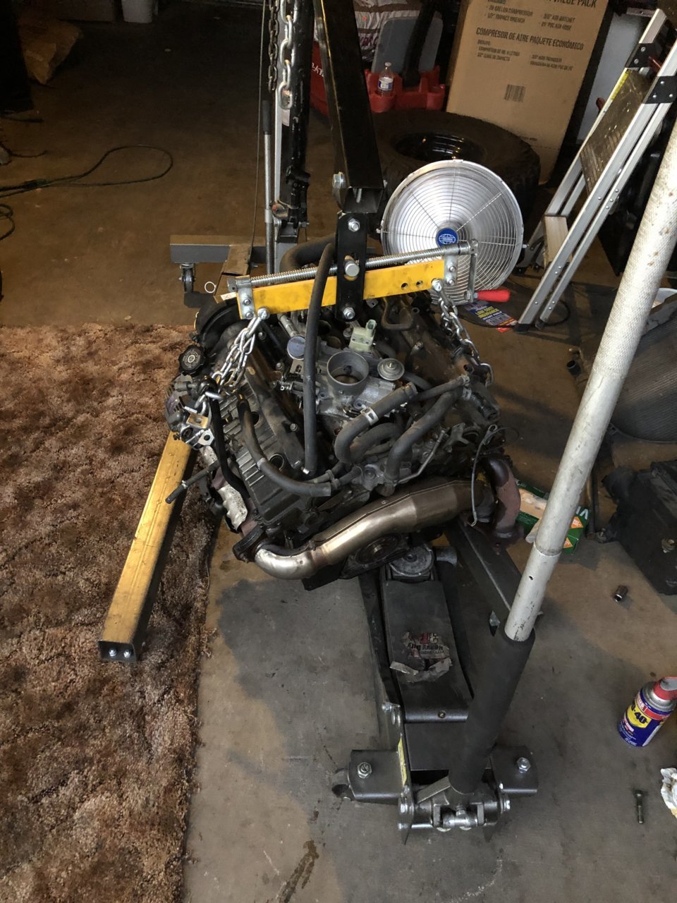

    Punched 1st and spun a rod n bolt(more likely) went through the oil pan, just my luck
    Was on meth and 2.1 pulley,urd o2 calibrator

    No issues for 600k miles,
    I’m running methonal that fills the gap when I went to the 2” pulley and 10 pounds of boost

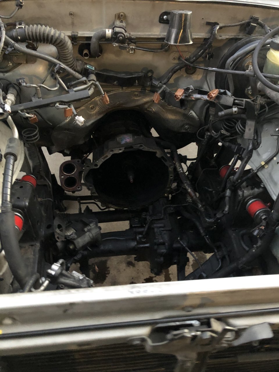

    Yea got a backup motor so I’ll be good , motor is out and putting in the new motor this weekend,waiting on new clutch, water pump TB kit 5A004D13-9D19-4B07-A4C8-B27F71015AD0.jpg 78D1291F-9FD4-437A-B2C1-DE102344ABDB.jpg
