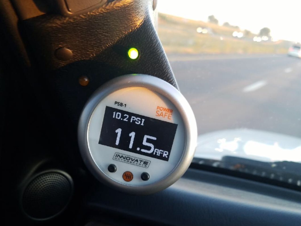

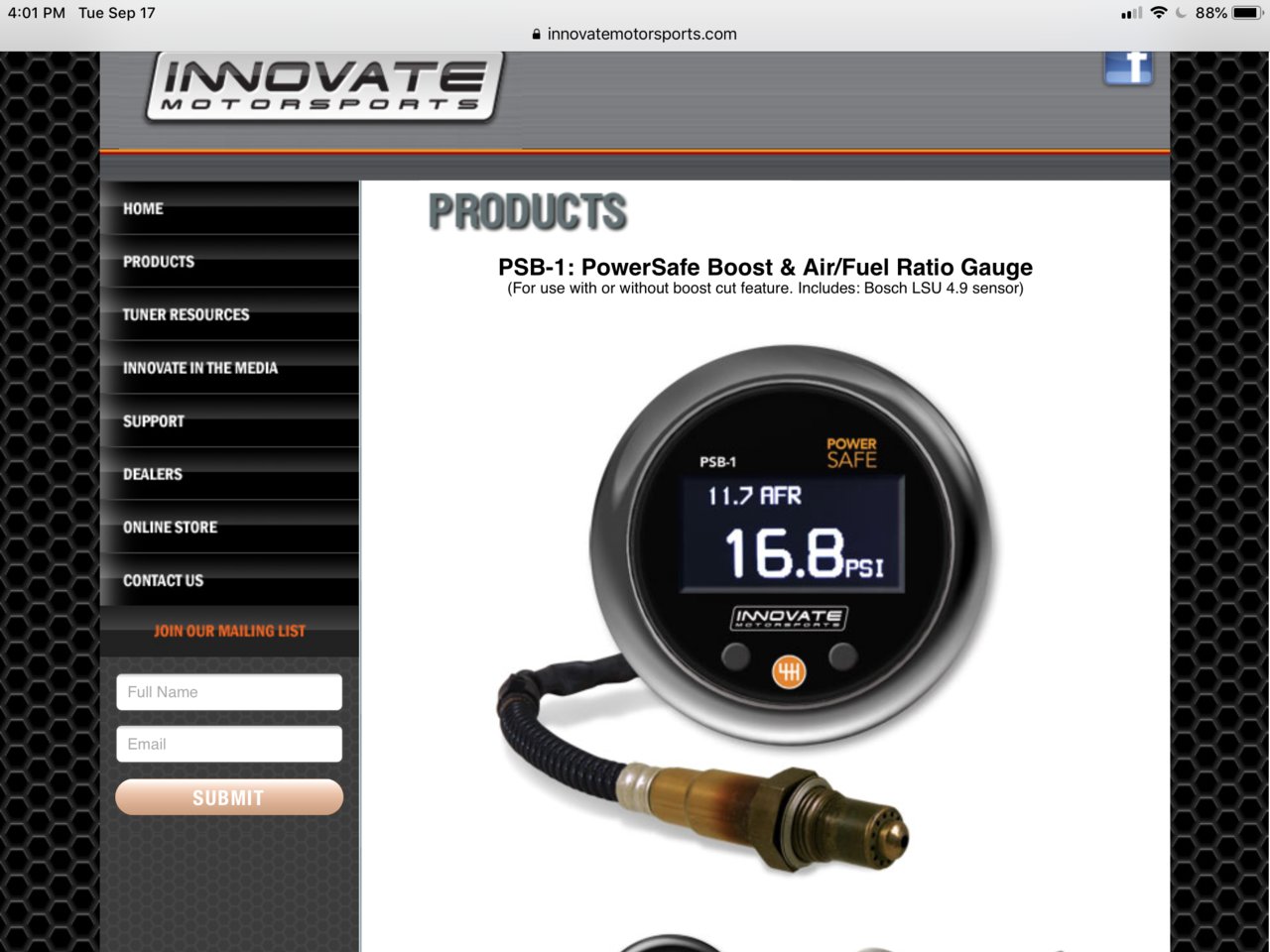

    The nice thing about the Innovate gauge I have is it has both the AFR and the boost and vacuum all in the same gauge.
    You can switch to have either boost or AFR as you lead position and either or as the 2nd position or switch them the opposite or have just one as your lead screen.
    You can have a white or black dial.
    A light will comes on if your AFR is outside of the safe AFR ratio that you program.
    Also has a button setting that keeps tabs of you max boost between each time you turn the truck on and off
    As you saw it’s a slick gauge with lots of options.
    https://www.innovatemotorsports.com/products/psb1.php

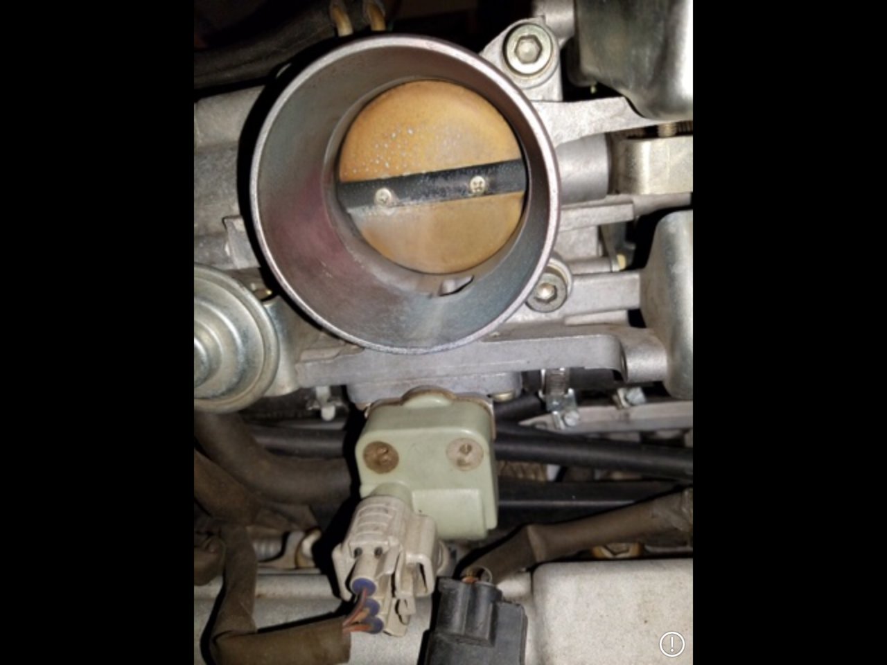

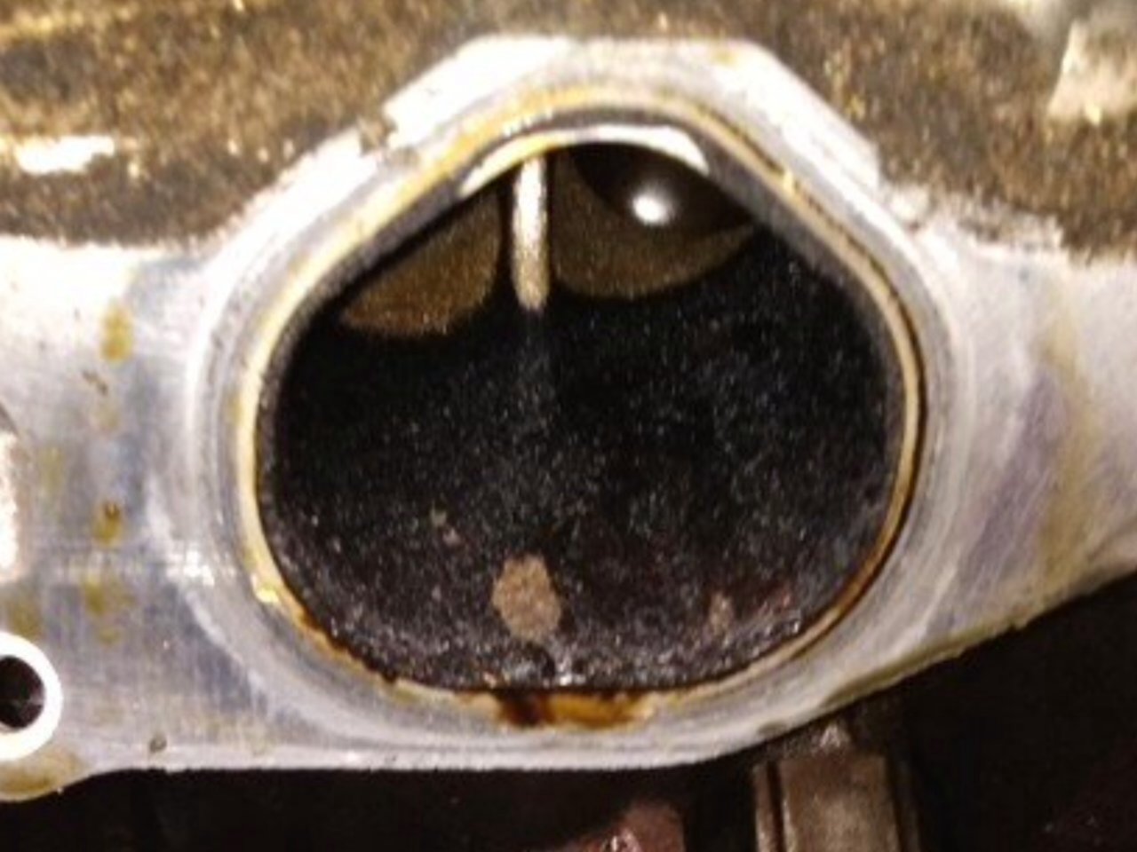

    Methonal is the best of both worlds because it cools the supercharger, adds octane to 110 and cleans the intake of your motor for carbon free deposits, but more maintenance.
    Here is my throttle body and valves, all squeaky clean, will never have to clean either one of these again, top of the pistons and cylinder would be the same too.
    AND ANOTHER members 3.4 valves that you can barely see with no methonal with carbon choking the valves. The chocked covered valves on this motor I think had 125k miles or something, essentially it’s a low mileage engine.
    Valves chocked with carbon will make your engine ping happy and more

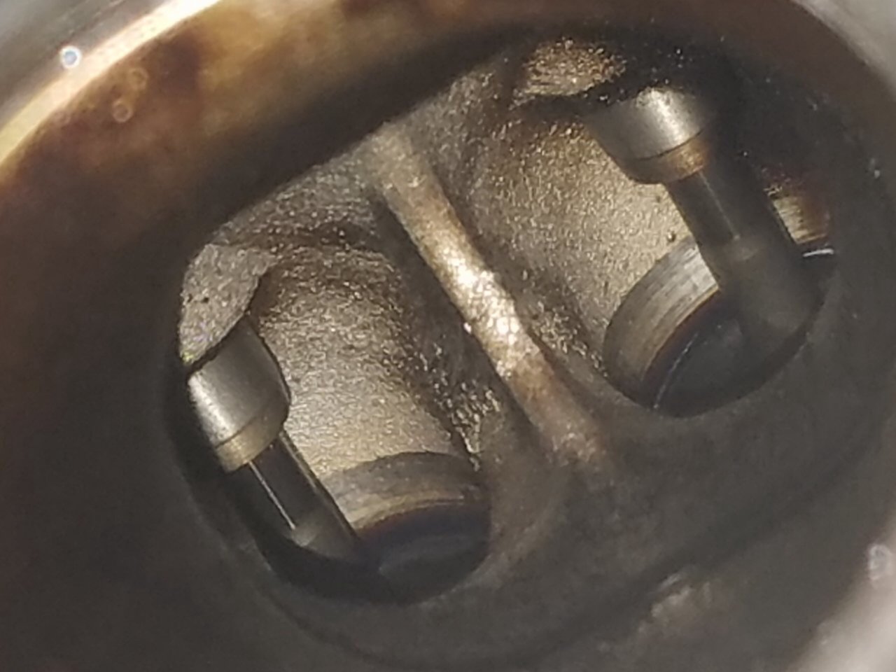

    When the supercharger is installed you should have them take a photo of the valves and throttle body inside to see if you have carbon build up.

    This model is no longer available new. You might be able to still get it on eBay.
    New model comes with a gauge with built in boost gauge.
    If you choose to get the new model
    You will no need a combination gauge from innovate (AFR and Boost) just an AFR.
