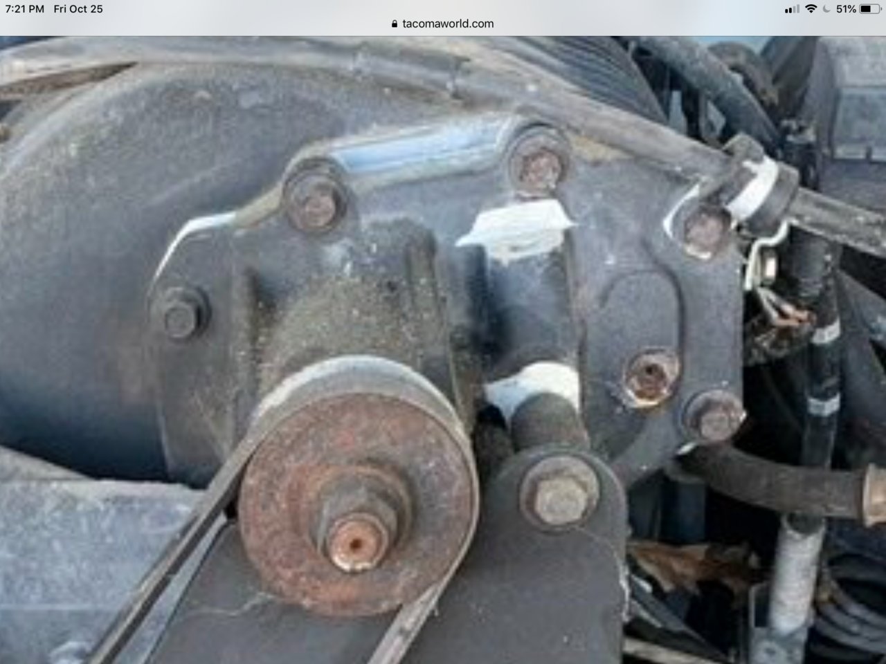

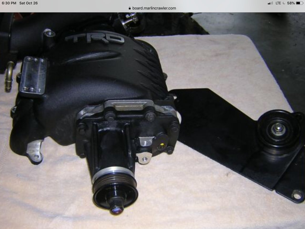

    I'm in at $75+Shipping. The lower bolt hole looks ovalized. Is it just the photo?

    Me neither

    I don't think it will be too hard to drill and tap in place. It's Aluminum.

    It would be easy, just take the snout off if nothing else and have it tapped at a machine shop

    No, just the photo angle

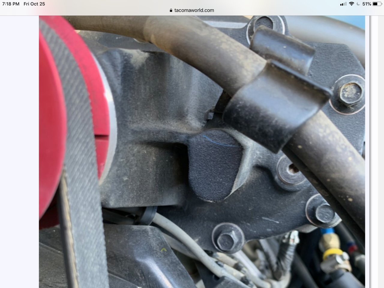

    Nose cover looks the same just with no bolt hole

    I’ll give Magnesun a call Monday and see what’s up. “Hey where did the bolt hole go?”

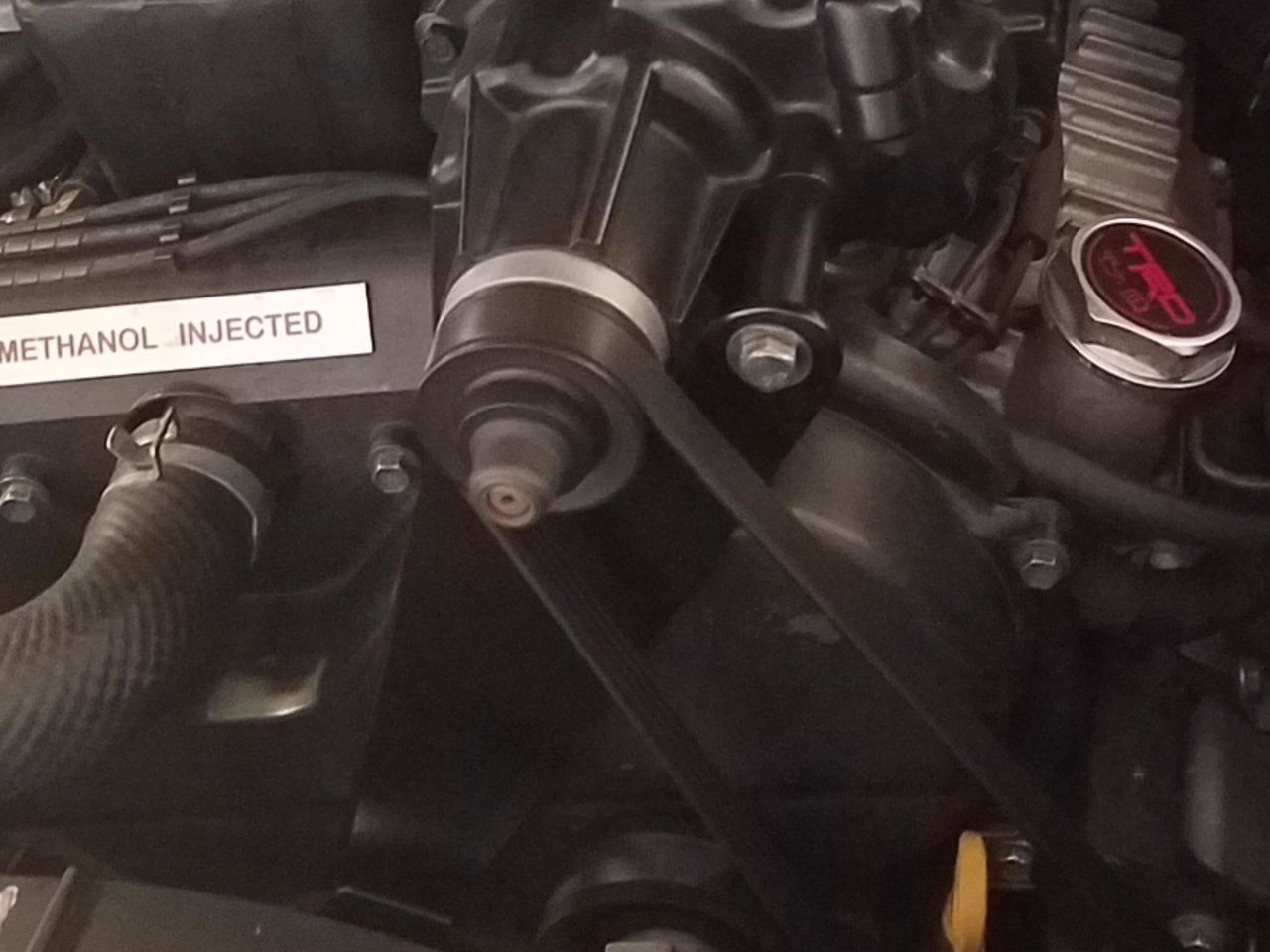

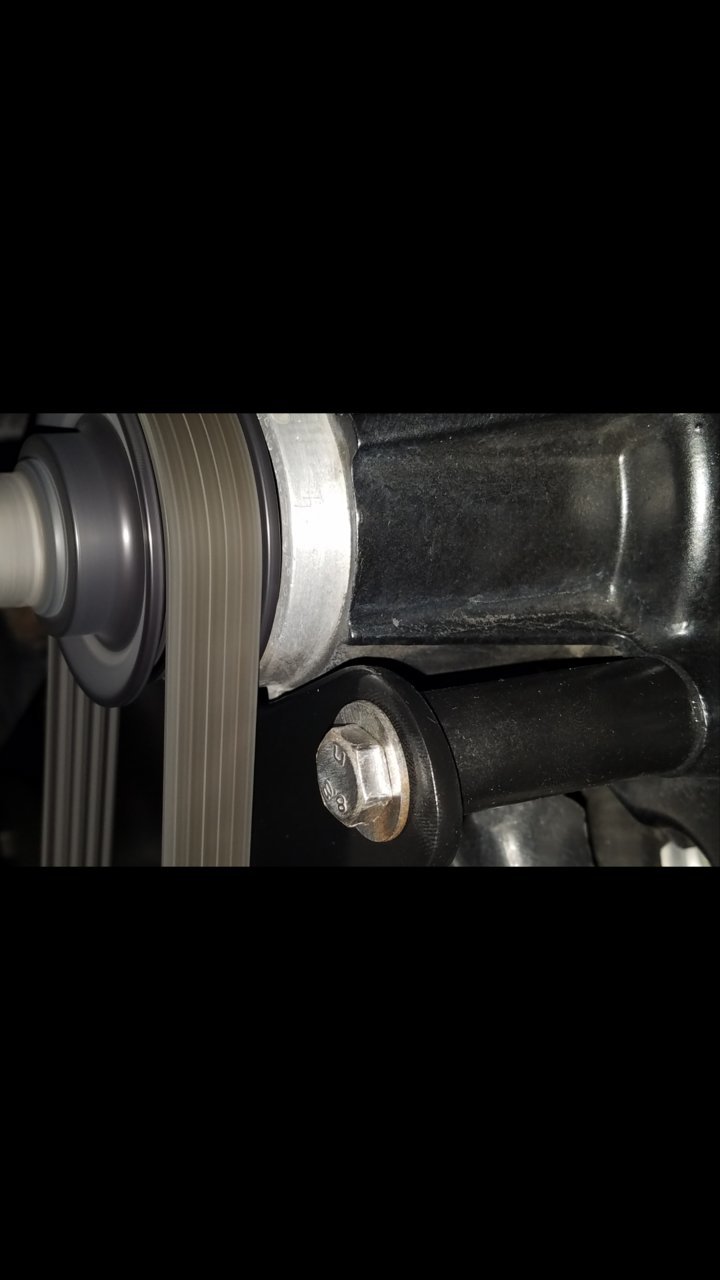

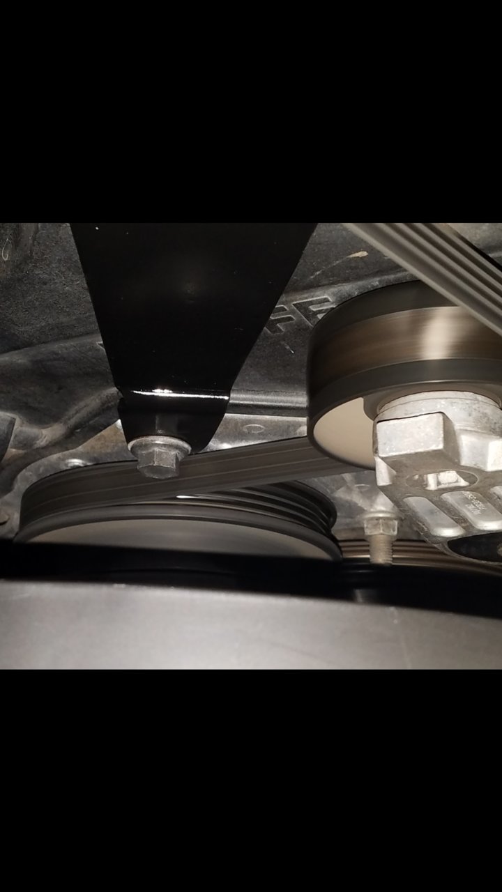

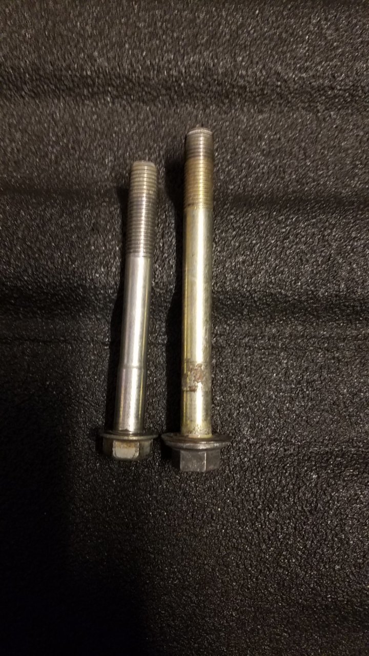

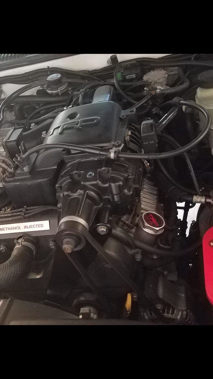

    Got it all done, Looks like an OEM part now
    My advice is see if you can find a member that has one of these older brackets WITH THE bolts and spacer that will trade for the newer tensioner.
    The bracket fits perfectly but there is probably 1/16” gap between the bottom bolt and hitting the supercharger belt. This section fit extremely tight.
    The bottom bolt is also a different length than the stock bolt as it has to be longer.
    kigmob and JasonLee like this.

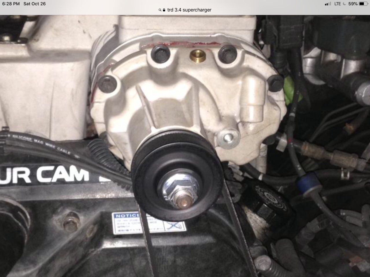

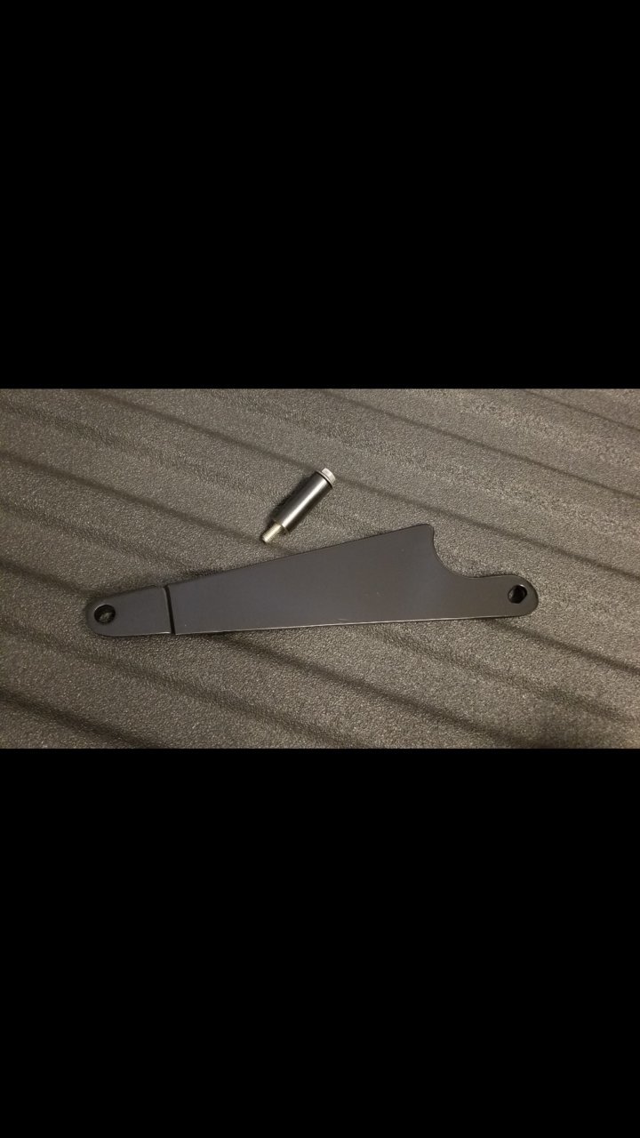

    I’m going to say the 3.4 TRD supercharger was originally designed with the bracket to
    support the nose and added the pulley as part of that bracket killing two birds with
    one stone. The 1st gen grey supercharger and the earlier redesigned 2nd gen black TRD supercharger both had the nose supported with this same bracket.
    Probably when they went to the dynamic tension pulley they lost sight of the nose support
    as it was a replacement item. So if your supercharger is newer the bolt hole will not be there.
    Because of the distance of the nose pulley sticking out as far as it does away from the intake superchargers 5 small 15 pounds of torque intake bolts with 80 pounds of leverage it would be great to add this if possible.
    It would take a lot of stress off the bolts and bearing of the supercharger.
    When you consider this supercharger is spinning at 10-15,000 RPMs (depending on pulley size)
    with 80 pounds + or - of fluctuating stress depending on load pulling the nose down, it’s a win win option.
    Possibly @mechanicjon Can make a CAD of my bracket for others to have.
