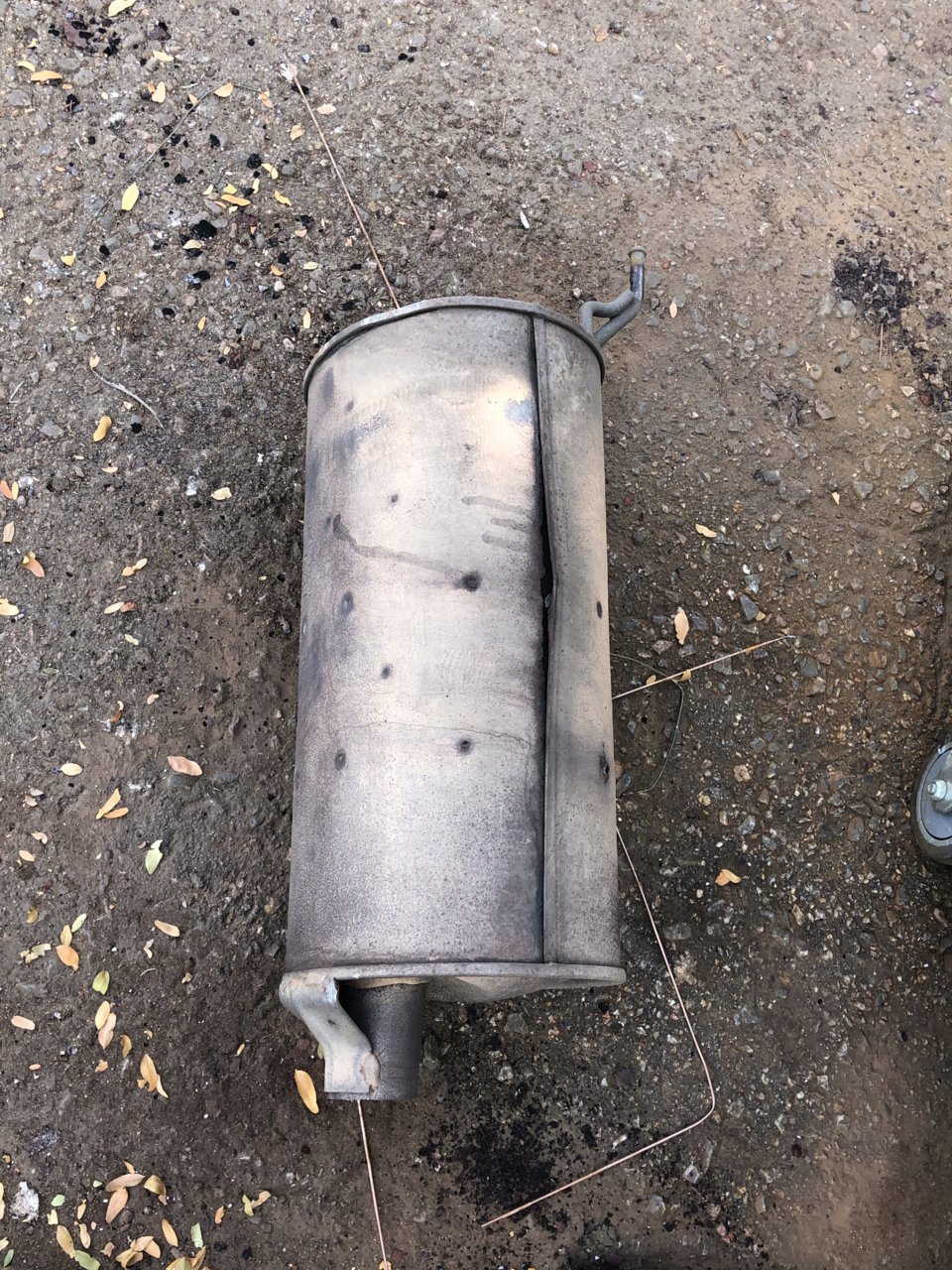

    Could be. 1997 runs a 2.0 pulley with meth and his numbers are 11.5 WOT. I would check for exhaust leak. It’s cold out right now where we are. You may just be able to see it if you look underneath.

    533EF75C-AC82-4A28-A550-916574F7BBE7.jpg This was my muffler which was split open/rusted out. I didn’t have an AFR at the time but felt like something was off. As soon as I replaced it. It was very noticeable and the exhaust was cooler, like my exhaust tip stopped being super hot and black. Basically started running right.
