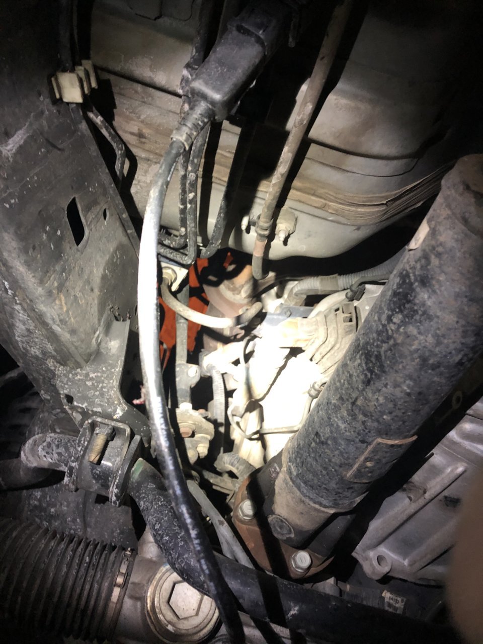

    Hangin chord there next to shit that moves.

    1800 help. I guess I’ll tape it for now.

    Hard to make out if anything is loose or disconnected in the photo...might just be that it needs to be zip tied into place. I had to zip tie the wiring harness for mine in several places along the bottom of my truck through the engine bay before it went through the firewall into the cab.

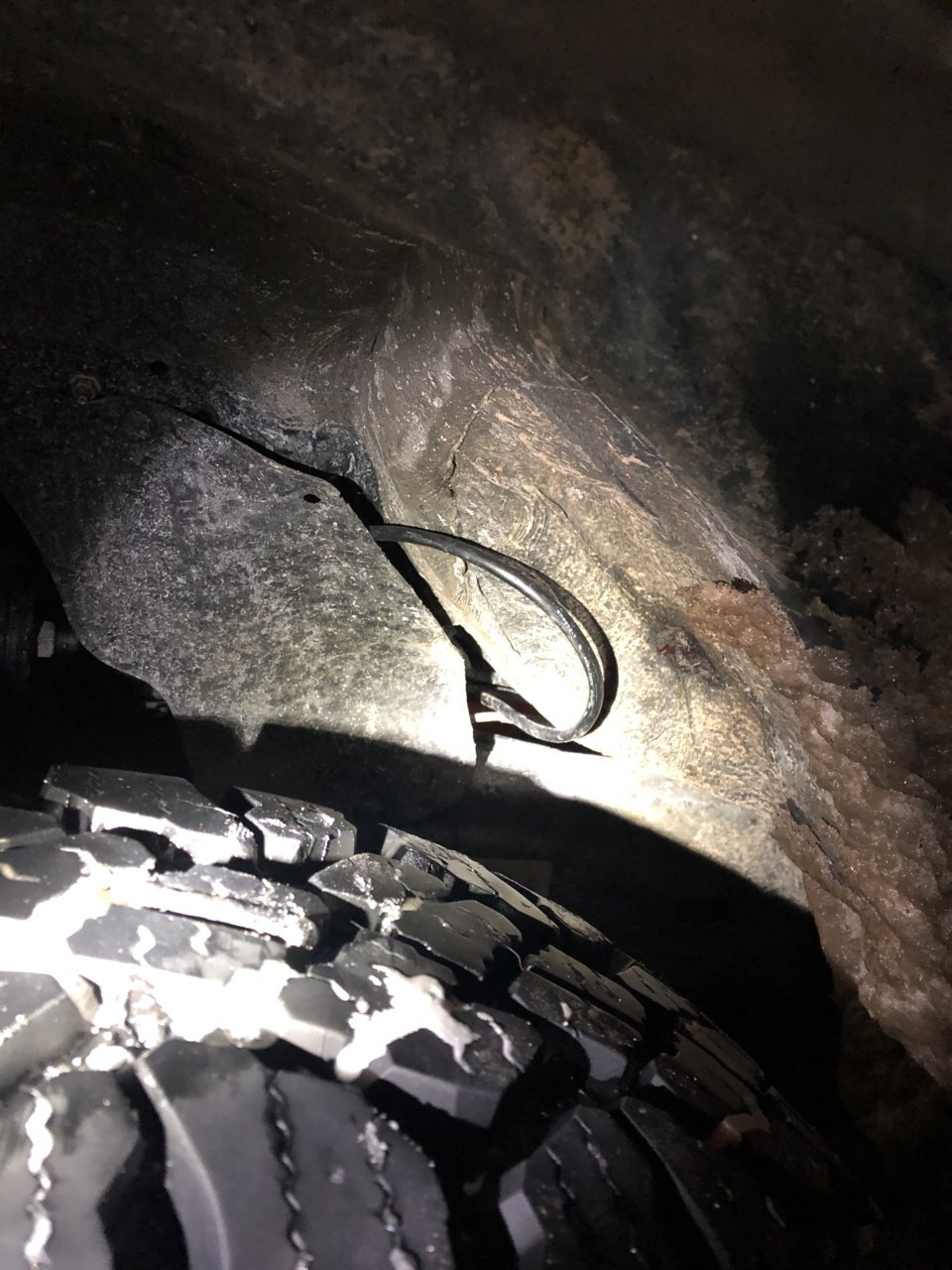

    That’s the driver side wheel well

    Hmm yeah the guys that installed it didn't do a very good job of keeping the wiring in place lol. If you take it back to them to check out the issue with the gauge, I'd have them clean that up

    Will do. I just can’t trace it back all the way to the top.

    Looking at this more closely, those guys did not run that wiring well when they installed your AFR gauge...looks like it's going underneath your sway bar?

    I got like 3 feet of slack. Something is up. I just cant see too well right now. It’s dark and 2 degrees and the wife is asking what the hell im doing.

    You need to tell Mike that the guy that did this work needs to clean up these wires and zip tie them and run them higher up, not below the roll bar.
    Show him photos,

    When I go back, I’ll ask for a redo. I’m sure it will be cake for them with a lift and some heat and light.

    There was a bit of slack in mine too, think they make the wiring harness long because it isn't designed to fit any one vehicle perfectly in particular. I had to wind mine up inside the engine bay and zip tie the slack against the firewall to keep it neat.

    Thanks John! I’ll have them redo. They are nice over there. I’m sure they will take care of it.

    They will, all they need to do is run it a different direction and take out the slack, it won't be hard to do
