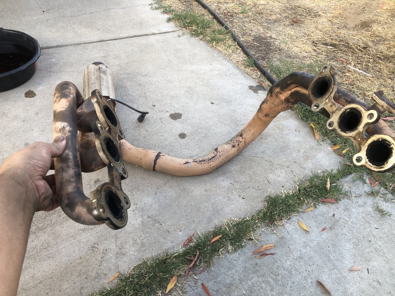

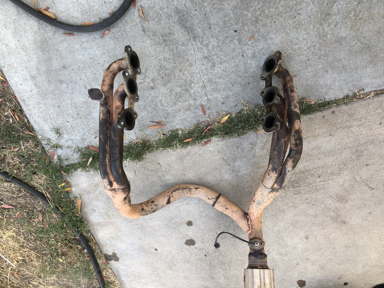

    Anyone looking for some header lmk located in Fresno ca good upgrade with your SC!
    $200 pickup
