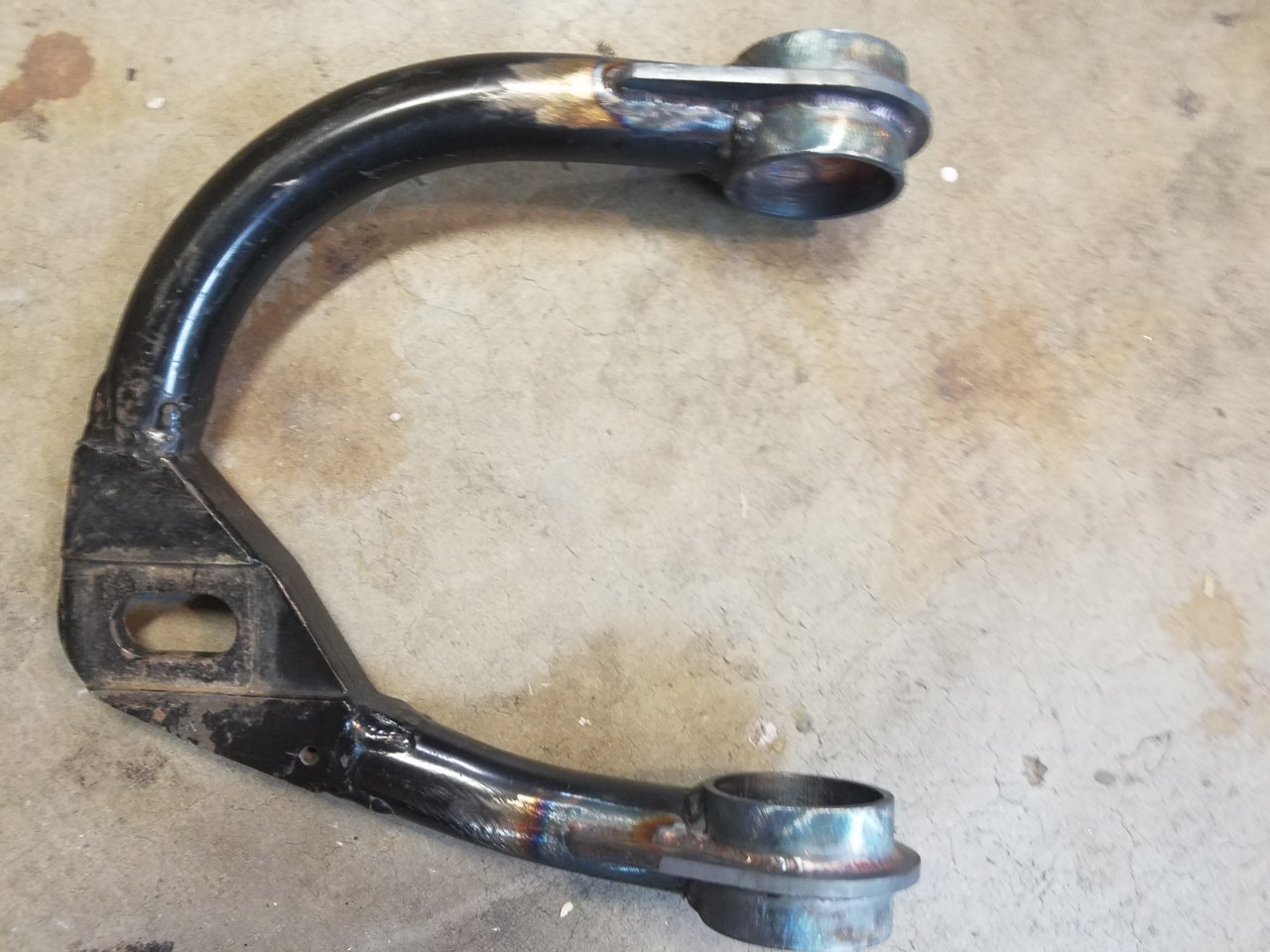

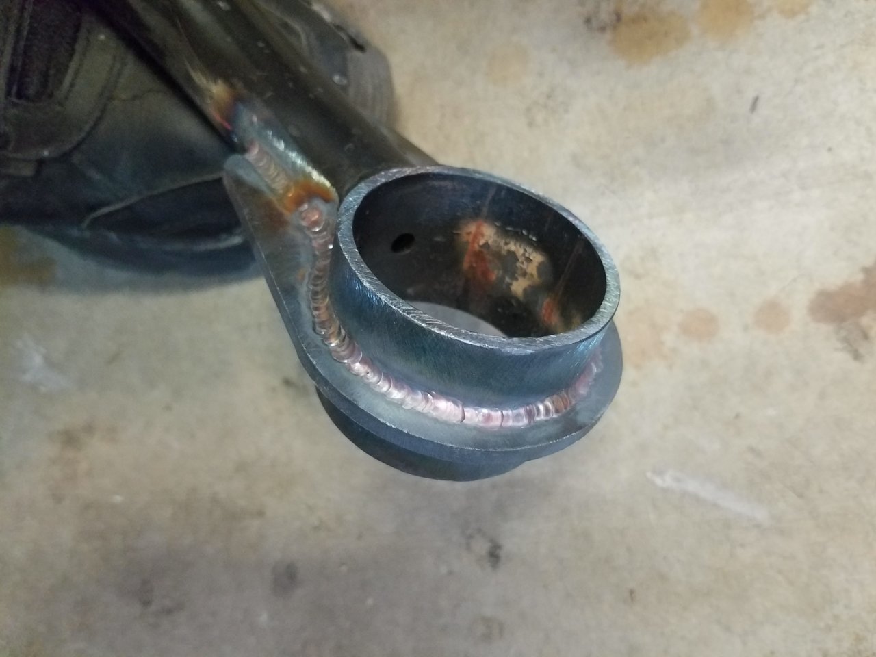

    Fixed my SPC's no breaking problem now.

    Nice looking welds, but why was this needed

    Older SPC arms had a design where the arms would crack, something to do with the bushings I don't remember exactly why. That issue was resolved by SPC years ago though
