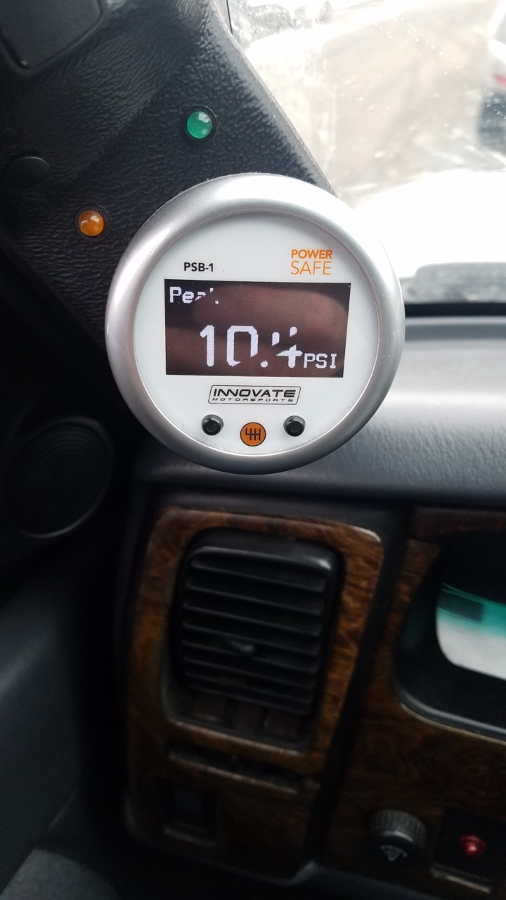

    HAS to be OEM, what a difference paid 150.00 for it and worth every penny, have new found smooth power, put the OEM one in yesterday's and reset ECU and 200 miles driven today, its like a different power for the good and hit my highest boost too. I went through 3 different MAF with mixed reviews this last month.
    1) eBay looked liked an OEM but was fake, didn’t work so well paid around 20.00
    2) Napa DESNO, made the fuel trims run rich. Paid around 100.00
    3) EBay, DESNO, worked good then fuel trims went bad, Paid around 20.00
    4) OEM from the dealership, fuel trims are great and power is great. Paid 150.00
    OEM is the winner for me.
    And returned all the others.

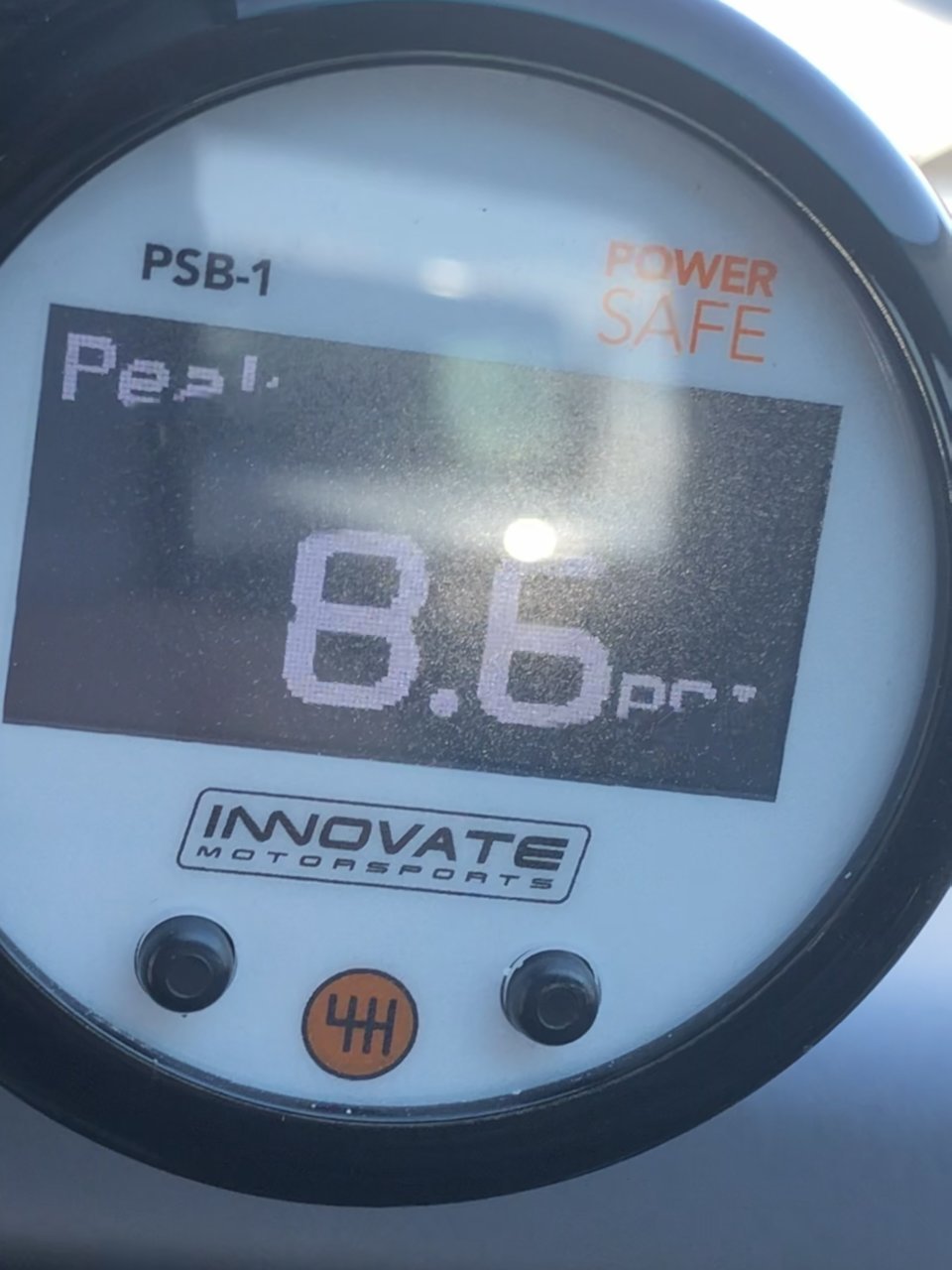

    Ok. So here’s the update. I put on the 2.2 pulley. It’s a different truck now. No fuel mods even though I have the methanol kit. The truck doesn’t need any fuel mods based on the dyno. So now I have this methanol kit. After speaking to the shop manager that tunes and drives a sick Chevy and some scary fast vehicles, We are considering a distilled water only injection system with no added fuel for the summer only. This will cool things down and provide denser air. So it will run cooler in the summer. The system can be purged and winterized in the winter. The shop never done that before but there’s a first time for everything. I’m running a 2.2 with 11.5 AFR to 12. It’s spot on. The torque is awesome.
    here’s what the truck sounds like now.
    https://youtu.be/DW-WAX9Wpg0
