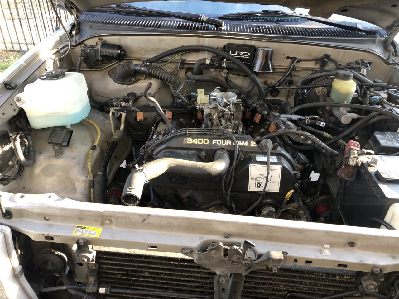

    Rod bolt broke and went through the oil pan , had 192k

    I see some URD stuff. How much boost were you running?

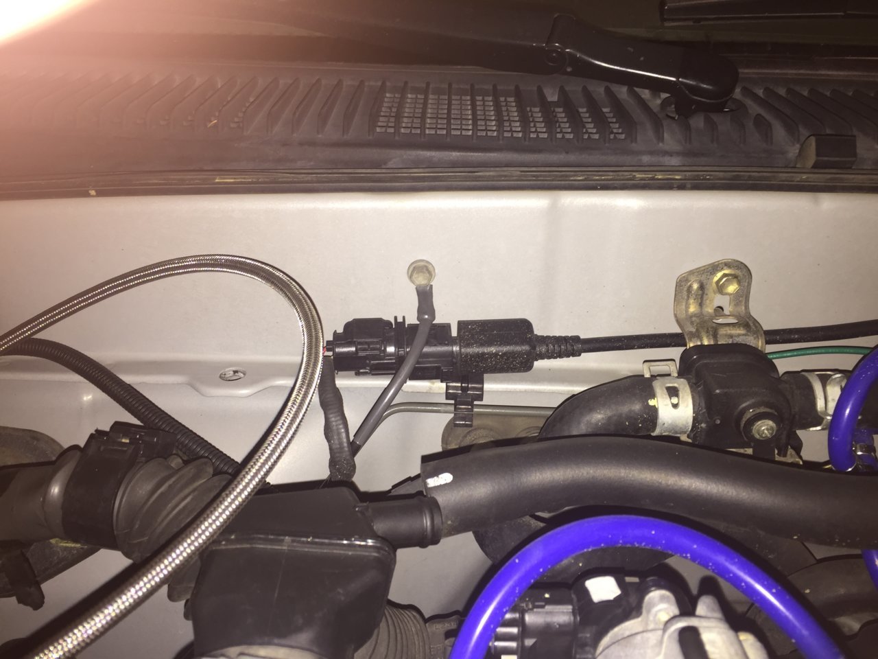

    I left my slack behind the dash and my plug is in the engine bay.

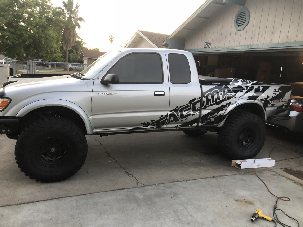

    lunar mist metallic yo
