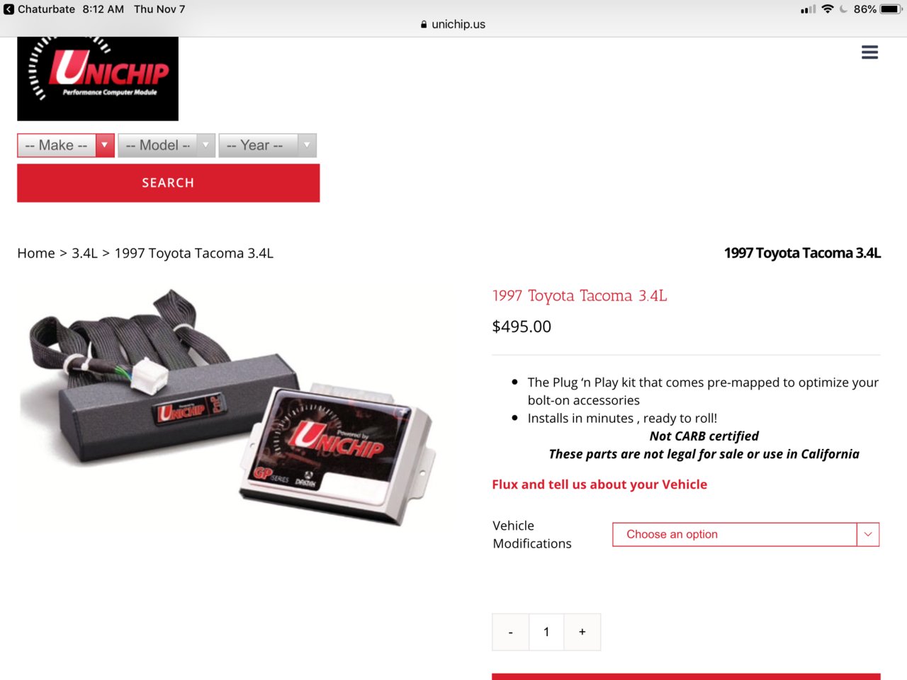

    Damn thing is sounding like an Atari game.

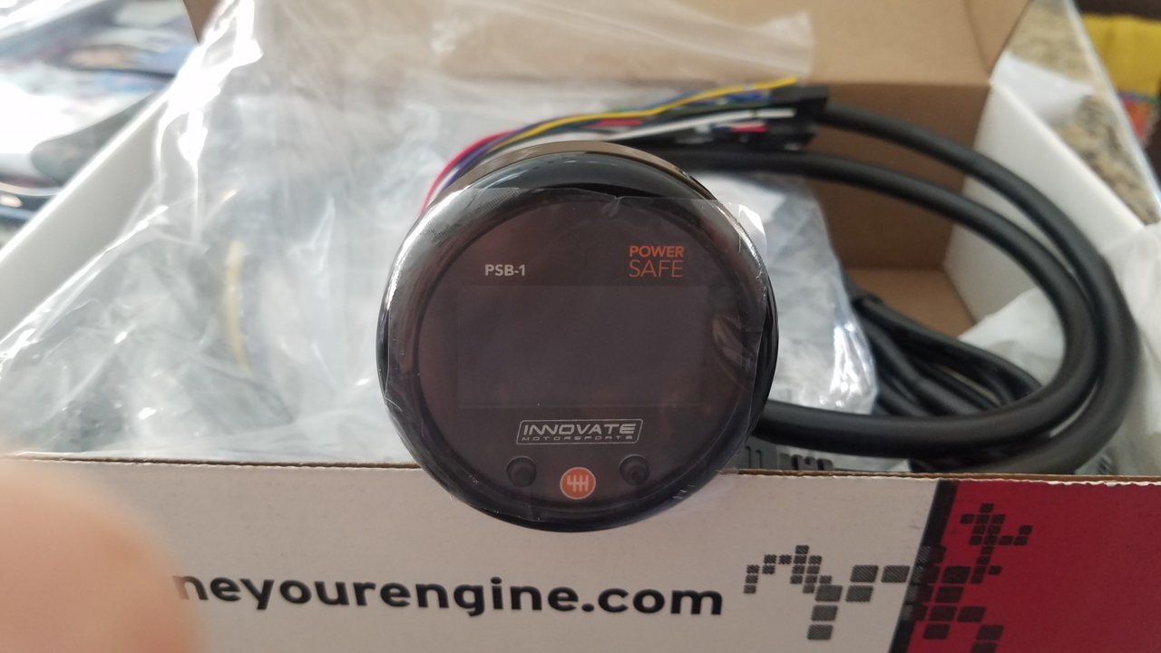

    Speaking of rabbit holes. The USPS delivered me a shovel.
