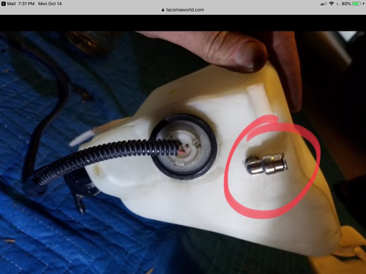

    Forgot to ask where is everyone installing their methanol containers?

    Using the wiper tank

    do you get the vapors going into the engine bay? can you smell the methanol? i have mine in my cab area, and i need to relocate it. i just dont like knowing its there

    There are NO vapors when it’s hooked into the windshield tank.
    Nothing to smell even with the hood open
