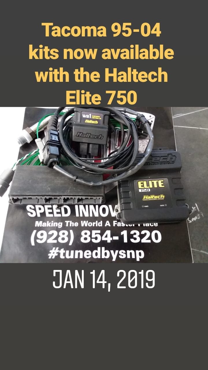

    49590133_279925176007754_873265530932767_081d59db310e290af31e71acdc1a90a31985de57.jpg

    nice. Looks exactly like the URD dual ECU kit. Glad someone finally did something for first gens.

    Ouch. I just found the post. $2100.
    Now offering adapter kits for the 95-04 Tacoma 2RZ, 3RZ, and 5VZ trucks. As always our kits come with the Haltech Elite 750 (upgradable), adapter harness that plugs into your factory harness, the new Haltech wideband, and a start-up base tune. The robust Elite series ECU's are waterproof internal datalogging, boost control, and has and internal MAP sensor good for up to 30 lbs of boost and gets rid of the over sensitive non adjustable MAF sesnor. As with all our systems, we supply the newest wideband from Haltech that is now also waterproof and even faster then before. Retail price on these is $2100.00
    https://www.instagram.com/p/Bsn4uWgn65K/

    shit. Just base tunes so Nevermind. Hopefully OVtune can do something that makes more sense for a very mild supercharger.
