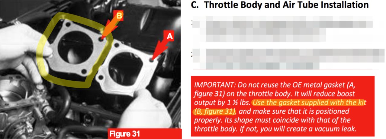

    Don’t forget you need Denso 5310 IK22 Iridium Power Plug,
    Cooler plugs will help reduce ping issues with the supercharger.
    These are one step cooler plugs, a must have item.
    I probably would pickup a new intake gasket just because it’s probably original and that’s almost 20 years old now. I don’t think it comes with one in the kit.

    Yea, I was talking about the gasket between the supercharger and the engine on the intake.
    But that’s a good point I forgot to mention, the stock throttlebody gasket actually is shaped like a big D, you don’t want that one, if that’s with the kit you want the one that’s totally round that URD sells.
    I don’t know what shape gasket comes with this kit.
    Or you can cut it out round.
    The stock gasket actually blocks the air.
    I would think it comes with the round one tho.

    The supercharger kit should come with the right gasket (the O shaped one), I ordered an O shaped one when I was taking my throttle body apart to clean it thinking maybe the PO put the wrong one in with the supercharger, but to my surprise there was already an O shaped one in there.
    I got the thicker density one from LCEngineering though that's supposed to withstand heat better and installed that one when I cleaned my throttle body.
    BassAckwards and 1997tacomav6 like this.

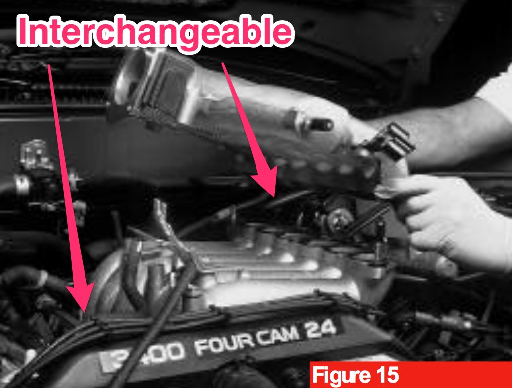

    Oh, I misread / didn't fully process as I'm at work.
    Step 24 states (of the gasket you mention between the Supercharger and lower mainfold
    Inspect the gasket. If it is in good shape, reuse it; if not, replace it with a new one (Toyota part # 17176‐ 62040).
    They also state:
    The gasket between the surge tank and the manifold (figure 15) is intercangable for use as the supercharger’s intake manifold gasket (see section B‐2).

    Yup it is, just better to put a new one in because his is 20 years old,
    If you get a vacuum leak there supercharger will run like crap, and you'd have to take the whole supercharger off again, I replace head gasket every time I take my supercharger off just for insurance, those bolts holding it on I only like 15 lb or 18 pounds of torque or something like that
