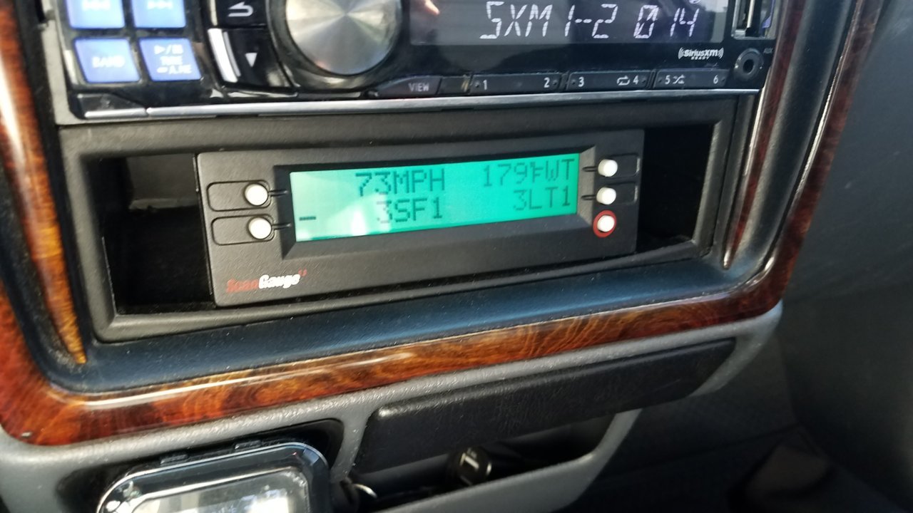

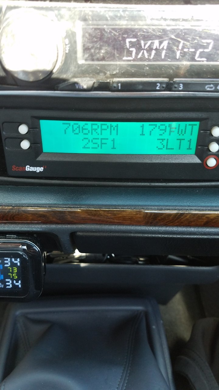

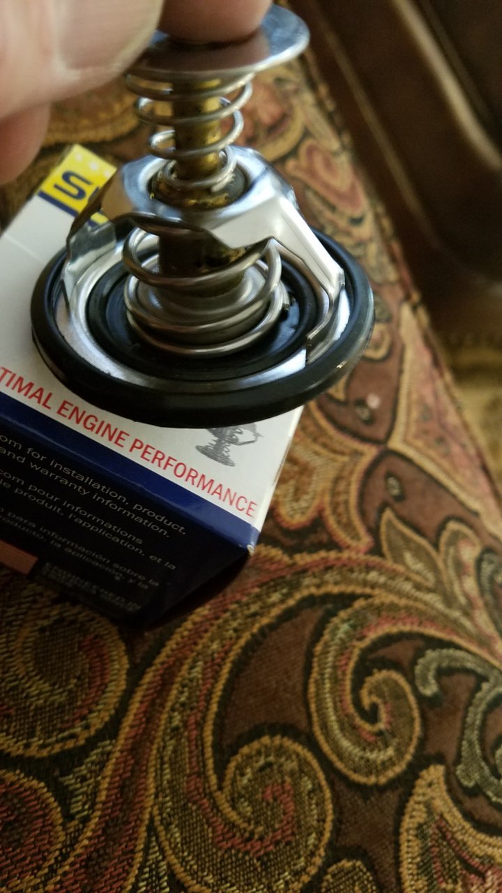

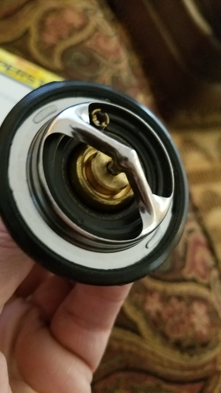

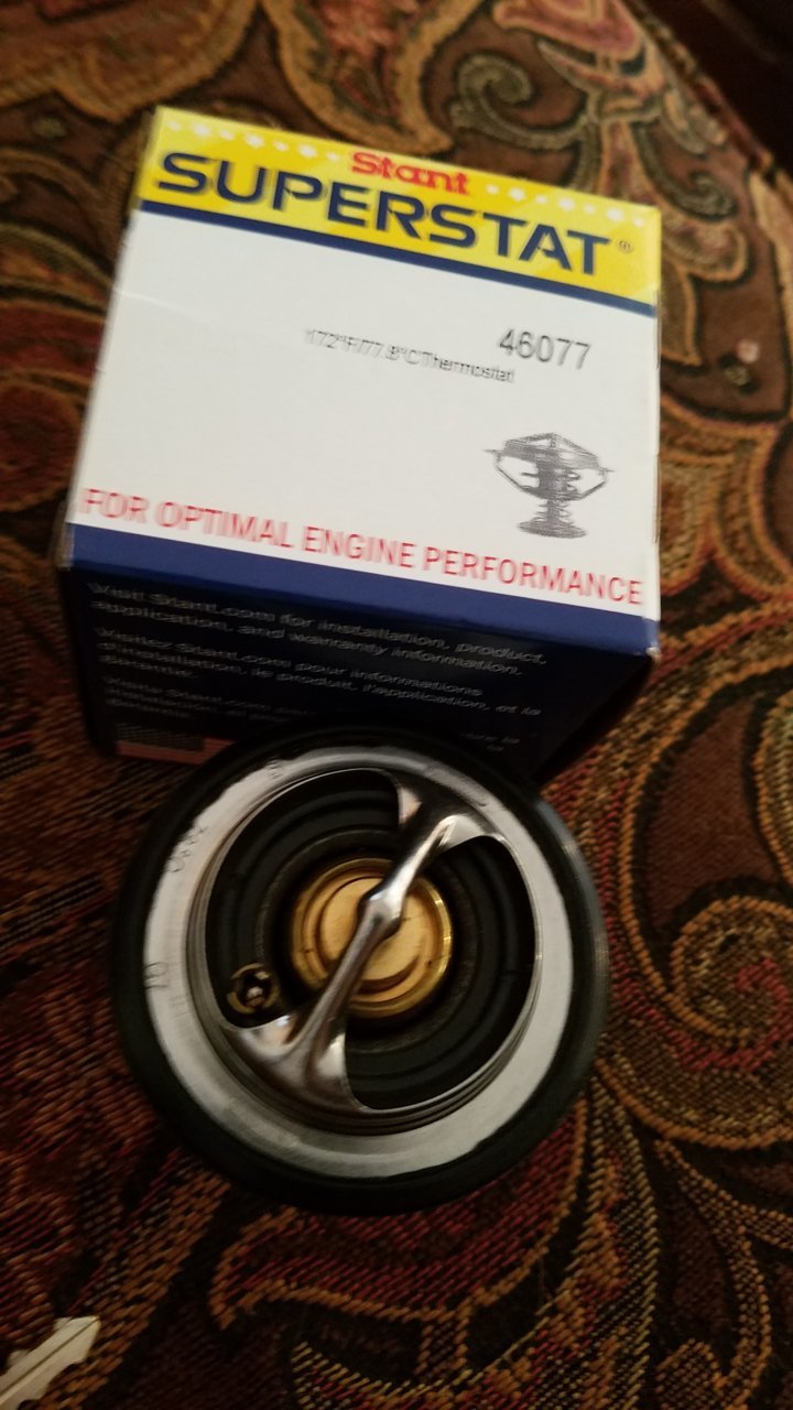

    Got a 172 degree thermostat Stant Superstat installed today for the supercharger. Helps Keep my motor at 180 degrees or so.
    A good thermostat for a supercharged vehicle can make a nice difference if the radiator can keep the temperature lowered even by 5 or 10 degrees less. We will see how it does going forwards. I had another 170 stat that went out on me after 6 months. So hopefully I will have a better review on this one. The quality specs look very impressive and has a jigger valve too
    Just passing some good information hopefully on a better item.
    Some info below.
    Unlike conventional thermostats that continually open and close to achieve the proper operating temperature and flood the engine with coolant, the Stant SuperStat® thermostat has a unique v-notch, non-linear design that reduces cycling by precisely metering the amount of coolant needed to maintain proper operating temperature.
    The v-notch provides a small initial flow. As the engine heats up, the v-notch gradually opens wider, metering coolant into the system until the desired engine temperature is reached.
    Stant's SuperStat® uses a high flow venturi for maximum cooling capacity during high temperature, high load operation and employs a unique Weir Valve® for precise flow metering during cold weather, light load operation to ensure stable temperature control under all conditions.
    The high strength stainless steel flange is burnished to a bright finish for additional stress relief and added corrosion resistance.
    The Stant SuperStat® thermostat is also thicker than most competitor thermostats and our standard reverse poppet thermostat for added strength and longer life.
    The power element of SuperStat® is comparable to those used in heavy-duty trucks. Its actuator piston is larger in diameter than the standard thermostat and competitive product. This larger piston delivers 1 1/2 times the power of our standard thermostat and almost 2 1/2 times as much power as the competition for enhanced durability and longer life.
    The opening spring of the Stant SuperStat® thermostat is designed with a load that is 50% stronger than our standard reverse poppet thermostat. This heavy-duty spring helps return the thermostat to the closed position and prevent cold running, even under the most adverse conditions. Features and Benefits
    Upgrades over OE equivalent thermostats offer more efficient temperature control resulting in faster warm-ups, better fuel economy, and longer engine life.
