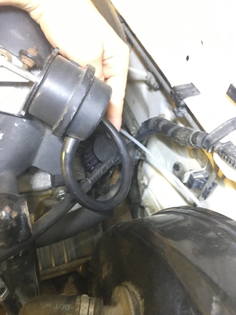

    I think I understand now. Plugged the PVC intake on the S/C and you’re venting atmosphere.

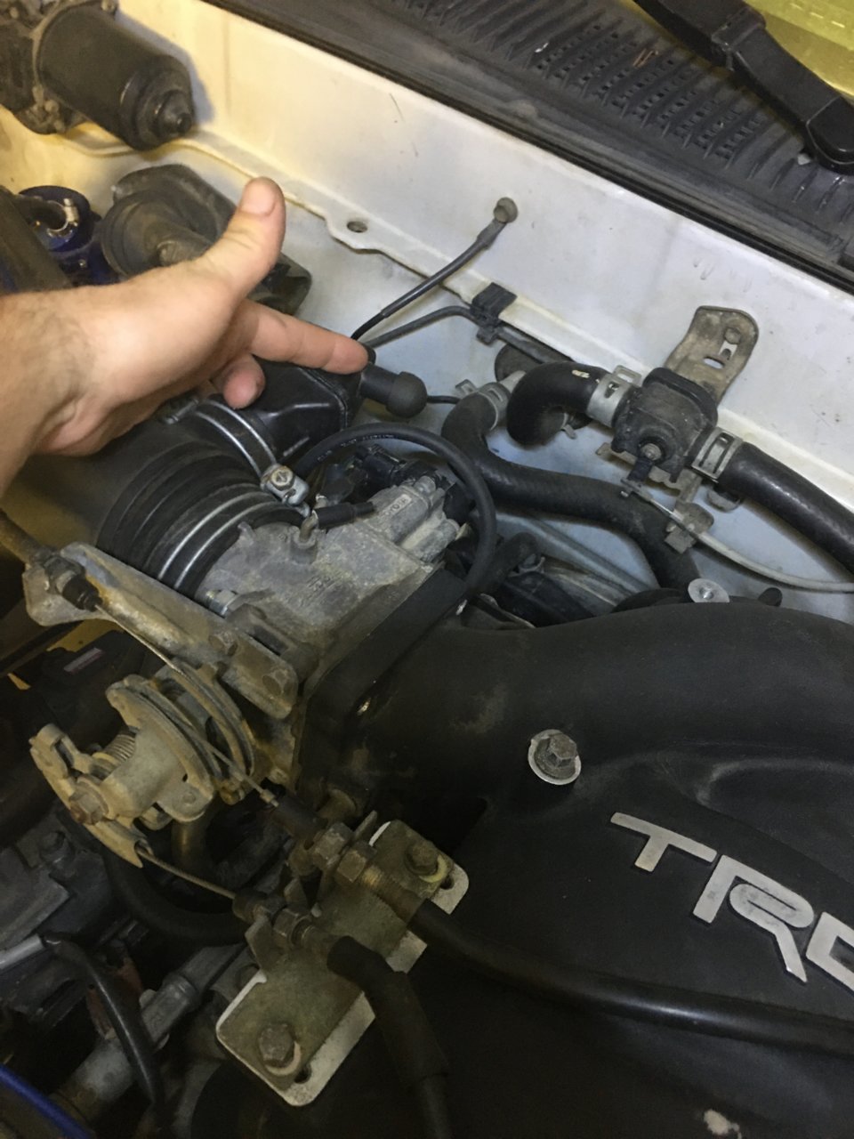

    It may be different for some trucks. But im referring to this connection to the intake. The stock hose runs behind the supercharger to the driver side valve cover.
    This is the filter I put on the drivers valve cover vent im referring to.

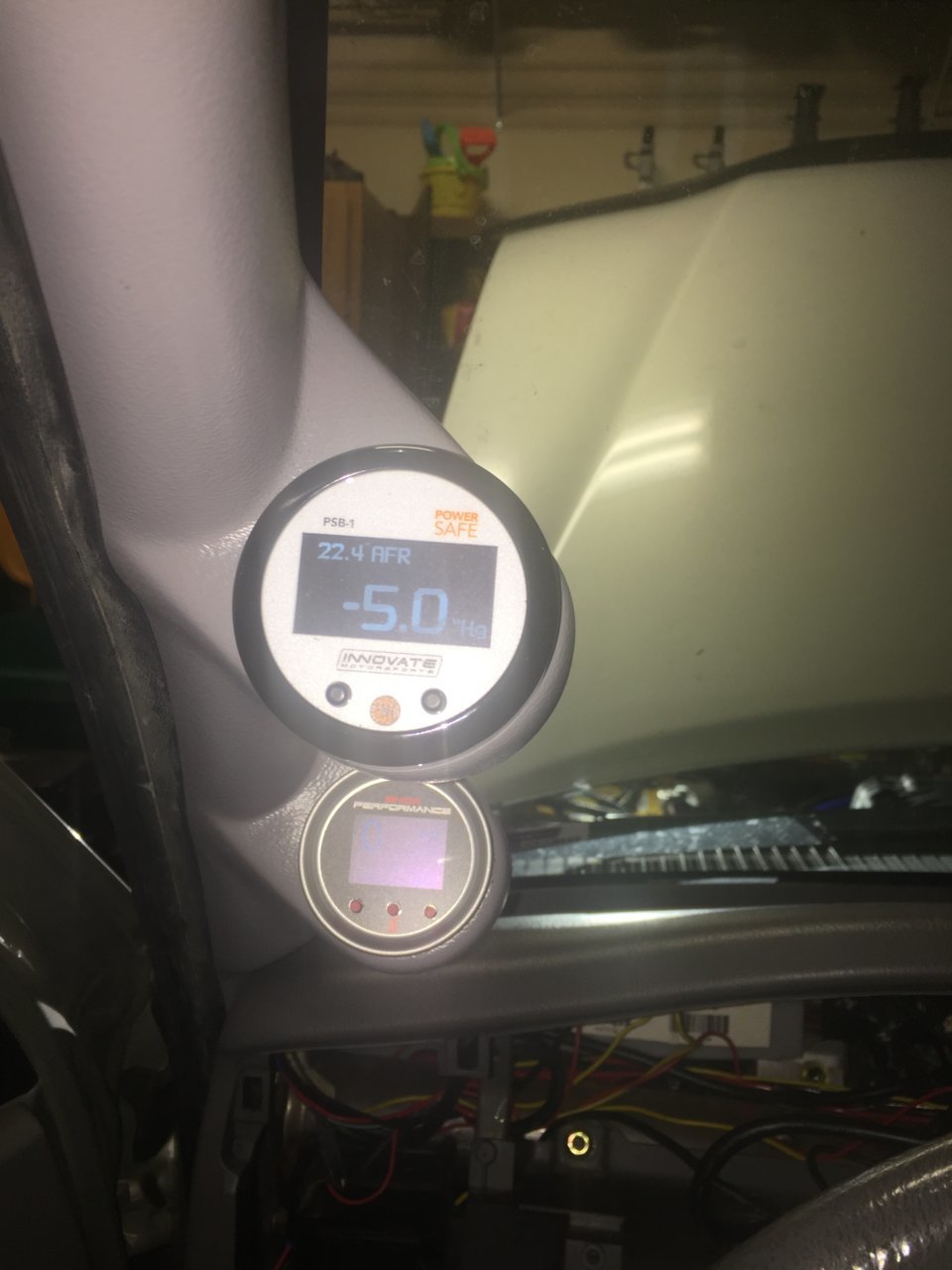

    Daaaaamn. What’s the second gauge?

    Snow methanol controller.

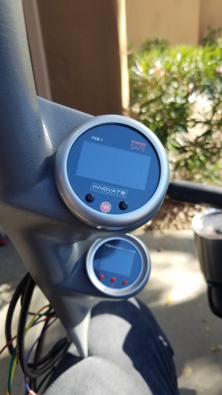

    That looks familiar !
    Awesome man!
    It’s a lot of work right

    That's a nice looking pod setup...does it get rid of the grab handle though? I couldn't get rid of mine, I use it too much when offroading. I would probably grab the gauge pod by mistake and pull it off
