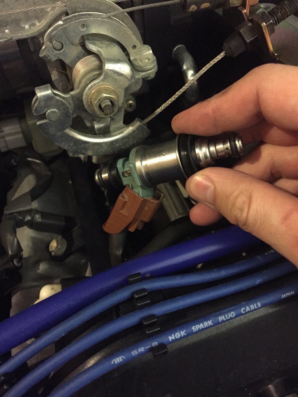

    Engine Performance upgrades: Supercharged (Magnuson) FIC/6 Champion Radiator Toyota Corolla thermostat 168° JBA Headers JBA cat back exhaust Upgraded fuel pump Volant Cold Air Intake With custom plexiglass cover TransGo Transmission A340F Valve Body upgrade B&M Transmission cooler Methanol Injection 2 inch pulley Future Plans Supra Injectors Light weight crankshaft pulley Leather seats Off-road upgrades 3” rough country lift 33x12.5” Dick Cepeks Other upgrades: JL Audio 12W6 Sub in custom box JL Audio C5 Mids and tweets all the way around Sound dampened whole cab Transmission temp sensor Gen Tex rear view mirror (temp and compass) Blue instrument panel, a/c control panel lights, shifter, ashtray, glove box. Blacked out badges Blackout bumpers and grill MariMoto Projectors with demon eyes LED Taillights Second generation leather steering wheel with audio controls Custom leather wrapped automatic transmission shifter 3rd gen 4 Runner key ring light (blue) 3rd gen 4 Runner hood scoop
    Oh yeah baby, plug and play Supra injectors, thanks @BlackPearl
    Now I just need to save up money for an FIC, fuel pump and boom sling
    @BlackPearl and I are crossing our fingers that they fit under the fuel rails
    @1997tacomav6 suggested buying a use stock injector from a junk yard for measuring ..sounds like a good idea!
    Thanks everyone!
    Hoping it works out!

    So plugging in Supra injectors will work just fine no problems without any tune for them?
  9. Nov 18, 2019 at 7:34 PM
    #1149
    Rldanie
    Rldanie Punisher78
    Jan 28, 2018
    #242763
    830
    Colorado
    2002 Supercharged, 2” pulley, FIC, Methanol, Transgo Shift Kit
    Not sure
    I’m with you on this point until someone reputable on here says otherwise
    Waiting until I have the FIC and harness
    And we shall see
    I am however going to install a bigger fuel pump ASAP
    Fuel pressure regulator should hold the bigger fuel pump at bay until bigger injectors and FIC are installed .
