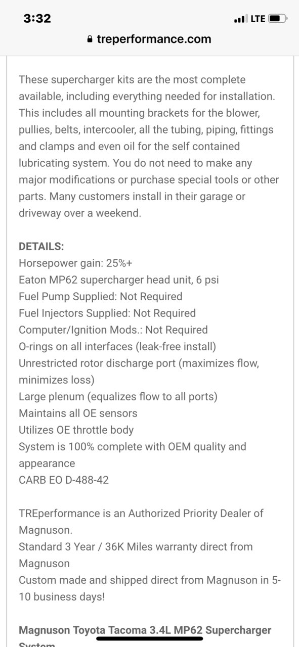

    Which kit? It came with the 7th injector or all new fuel injectors? I haven't heard of a supercharger kit that comes with new injectors and a fuel pump, got a link to it?
    Usually they just come with the supercharger, belt and 2 step cooler spark plugs (IK22)

    I’m reading this right?

    I don't think it comes with those things, there's no need for a new fuel pump or new fuel injectors with the stock setup and that's what they mean when it says ' Fuel pump supplied - Not required ' ...just an odd way of wording it
    The URD 7th injector kit comes with a new fuel pump but that's because there's a greater demand for fuel delivery when you add the 7th injector.

    I’m calling them.

    I just called. You are correct. Just S/C. No pump and no injections. She did say it’s meant for stock vehicles with stock fuel pump and stock injectors

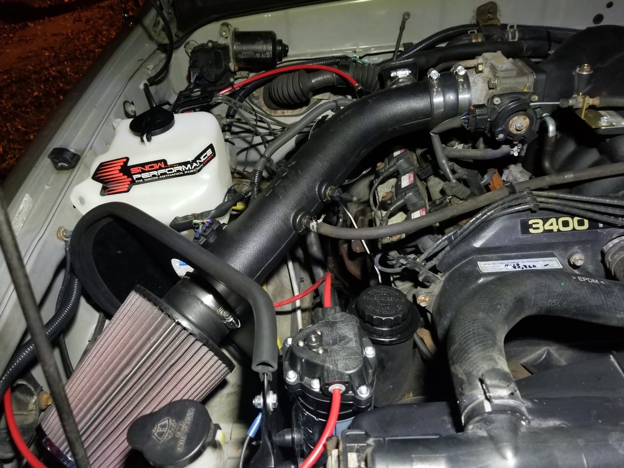

    So for @1997tacomav6 & @04yota - what's your setup? No piggyback or aftermarket ECU? No 7th injector or 6 bigger injectors?
    Just running a wideband sensor controlling the meth spray?
    I'd love the easiest setup for the biggest win, which is seeming like base supercharger (no 7th injector/piggyback/tuning) + meth + wideband.
    Is the meth controlled purely by boost and you "tune" it by watching the AFR gauge and adjusting the spray controller?

    If I were to do it over thats how I would go...just a simple methanol injection setup, no piggyback or injectors to worry about tuning or fuel pump to upgrade. Plus the added benefit of cooling which none of the other options provide.
    Unfortunately for me, meth kits are a no-go in CA if you want to pass emissions. Well, neither is my 7th injector but that's a little easier to hide.

    V6 5sp,RegCab,TVS1320 Supercharger, 56mm pulley, methanol injected Haltech ECU, AC Tvs1320 supercharger,(MUST DO) every 125,000- 150,000 needs rebuild Projector headlights HID 5 speed manual Amsoil for all drive train Smaller 56mm custom pulley, (MUST DO) 2004 DESNO fuel injectors, zero ping ping, 2004 side door mirrors Dick Cepek Rims, Michelin tires LTX, ATM Pathfinders Dynopro ATM ( that last 100,000 miles) Now running Dynopro ATM mud and snow tires KN cold air intake Cat back dual exhaust with ss exhaust tip, Raised exhaust tail pipe to 2" below body line Optima*dry cell battery,red top Alpine sirius radio, 200 watt amp, focal is165 split door pod speakers Focal door speakers Subwoffer behind seat Viper alarm, Electric Locks Dark tinted windows, bucket seats corbeau lg1 Tacoma Rubber floor mats TRD fender extenders, Bilstien shocks, King shocks JBA UCA trailer iv hitch, electric brake control, Drilled slotted brakes, High carbon steel (MUST DO) EBS green stuff 7000 series pads(MUST DO) TRD engine oil cap TRD stick shift, Marlin crawl shift kit. Rear sliding window 2002 4Runner functional hood scoop cut into Tacoma hood, 4Runner dual overhead map light Gentex Auto dim + Compass + Temp, garage,rearview mirror Snow Methonal kit stage 2 Custom 3 core aluminum radiator Linex bed liner Haltech stand alone ECU, Intake supercharger gauge. Stainless steel brake lines, Custom leather wrapped steering wheel, Haltech stand-alone ECU,
    As I said if you're in the Denver area 6000 feet you do not need to worry about the engine pinging or fuel issues with the stock pulley so you do not need to change your fuel pump you do not need to change the fuel injectors you do not need to do anything with the stock pulley. Stock pulley in Denver will put out 4 lb maybe 5 lb at sea level level it'll put out six maybe seven pounds so that's the difference. If you go to a smaller pulley 2.1 in particular you will need some type of fuel upgrade or you will have to drive the truck without the high RPM or without lugging the motor,
    You need to upgrade the spark plugs put in a new fuel filter and you'll be good to go, You do not have to get an air fuel ratio gauge with a stock pulley. But they're nice to have so you know what's going on.
    If you go with the 2.1 or 2 inch pulley you will need the methanol injection for the added fuel, you will not need the 7th injection or a larger fuel pump or piggy back, it's a very easy straightforward installation with the least amount of work and better benefits but it will require more maintenance and adding boost juice into your equation or methanol that you make

    My setup is similar to @1997tacomav6 no piggy back or aftermarket ecu. The only difference between my setup and John's is that he is above sea level and I am at sea level. I do get some pinging in high gear low rpm if I floor it ( usually around 2500)
    I usually go thru a tank of methanol in 2000 to 2500 miles using #2 nozzle because I'm not always in Boost. I average 26mpg to 30 mpg on my daily commute :D
