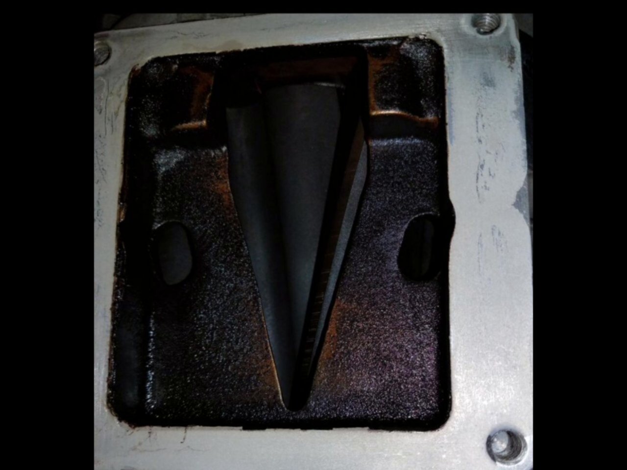

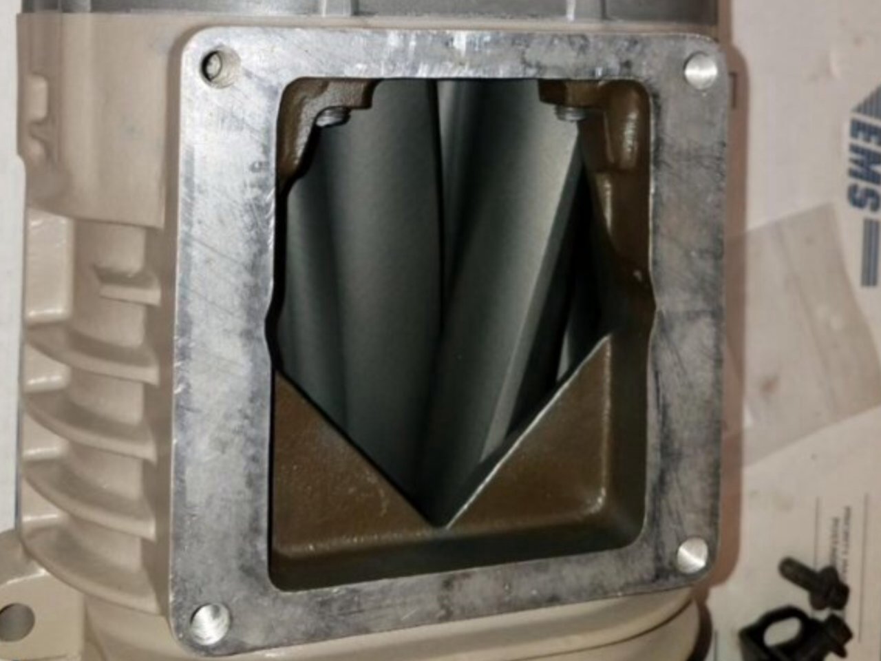

    I had my 1st gen ported as shown below,
    1st gen can be ported inside the intake because it’s a two section, 2nd gen in one piece and can’t be opened up, So the 1st gen can make more power at higher rpms and doesn’t stall out or go flat on the power curve like the 2nd gen supercharger.
