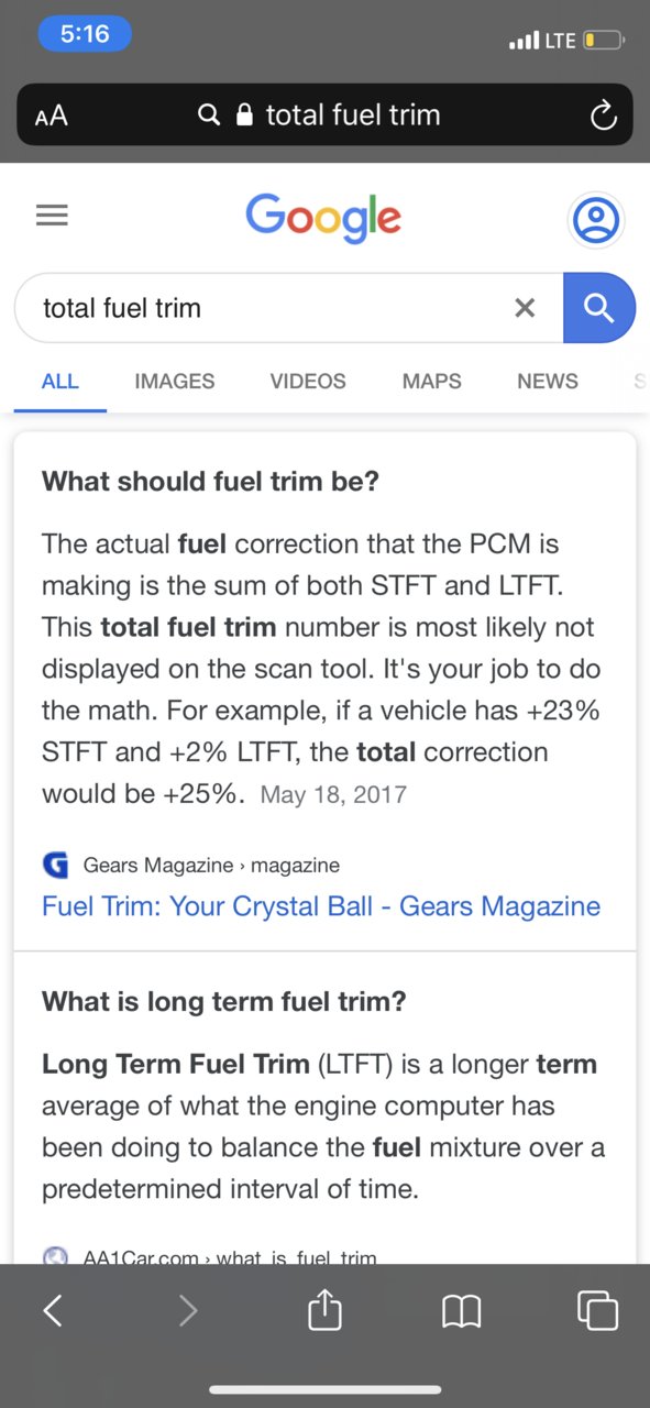

    It's less Tacoma and more mod
    I've never seen anyone total those two numbers, in fact I'm almost 100% sure you aren't supposed to since one directly influences change on the other

    Good to know, I wasn't aware of that. Yeah the short trims are usually around 0 - 3 and the LTFT never go higher than 7. So all in all I'm close to 10 total

    Hmm I'll have to look into this I guess lol

    The way I had understood it was the LTFT were the averages of your fuel trims long term, so I thought it was it's own number apart from the immediate or short term trims.
    I'm not constantly monitoring them, only when I hook up the Torque app/OBDII plug in.

    Basically the ECU uses LTFT keep the STFT short and tight.
