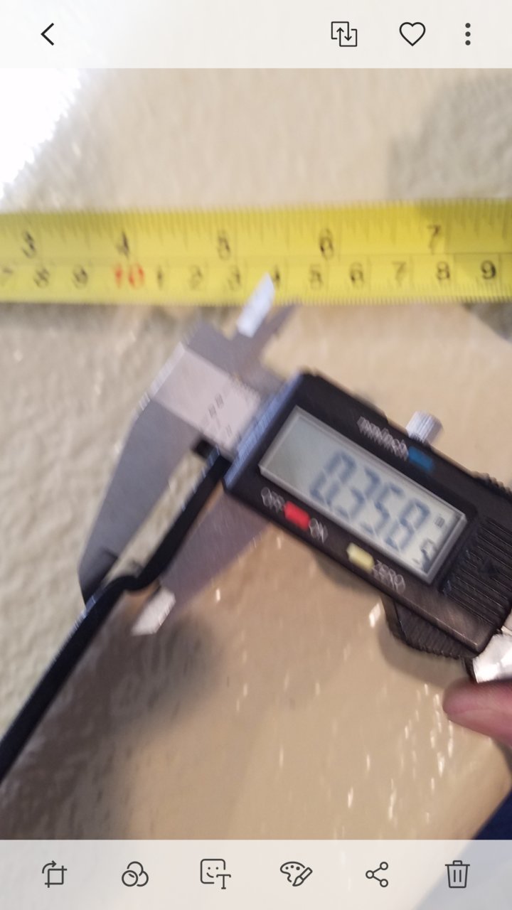

    V6 5sp,RegCab,TVS1320 Supercharger, 56mm pulley, methanol injected Haltech ECU, AC Tvs1320 supercharger,(MUST DO) every 125,000- 150,000 needs rebuild Projector headlights HID 5 speed manual Amsoil for all drive train Smaller 56mm custom pulley, (MUST DO) 2004 DESNO fuel injectors, zero ping ping, 2004 side door mirrors Dick Cepek Rims, Michelin tires LTX, ATM Pathfinders Dynopro ATM ( that last 100,000 miles) Now running Dynopro ATM mud and snow tires KN cold air intake Cat back dual exhaust with ss exhaust tip, Raised exhaust tail pipe to 2" below body line Optima*dry cell battery,red top Alpine sirius radio, 200 watt amp, focal is165 split door pod speakers Focal door speakers Subwoffer behind seat Viper alarm, Electric Locks Dark tinted windows, bucket seats corbeau lg1 Tacoma Rubber floor mats TRD fender extenders, Bilstien shocks, King shocks JBA UCA trailer iv hitch, electric brake control, Drilled slotted brakes, High carbon steel (MUST DO) EBS green stuff 7000 series pads(MUST DO) TRD engine oil cap TRD stick shift, Marlin crawl shift kit. Rear sliding window 2002 4Runner functional hood scoop cut into Tacoma hood, 4Runner dual overhead map light Gentex Auto dim + Compass + Temp, garage,rearview mirror Snow Methonal kit stage 2 Custom 3 core aluminum radiator Linex bed liner Haltech stand alone ECU, Intake supercharger gauge. Stainless steel brake lines, Custom leather wrapped steering wheel, Haltech stand-alone ECU,
    The step back is .358

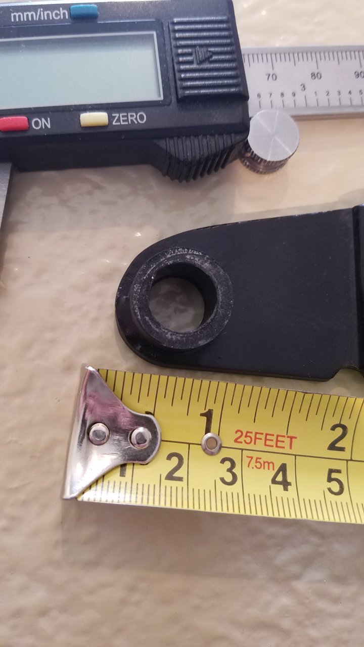

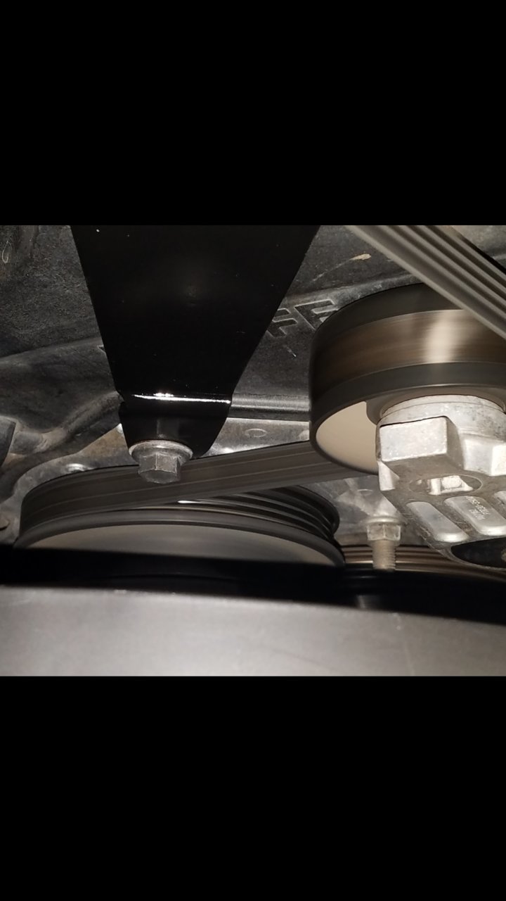

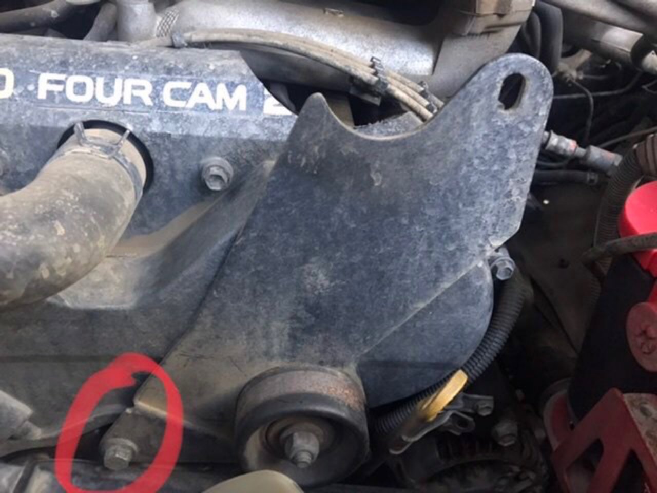

    The very last picture was what i was looking for. To get the step back , I'm planning on just overlapping the 2 pieces. I wanted to make sure it cleared every thing.

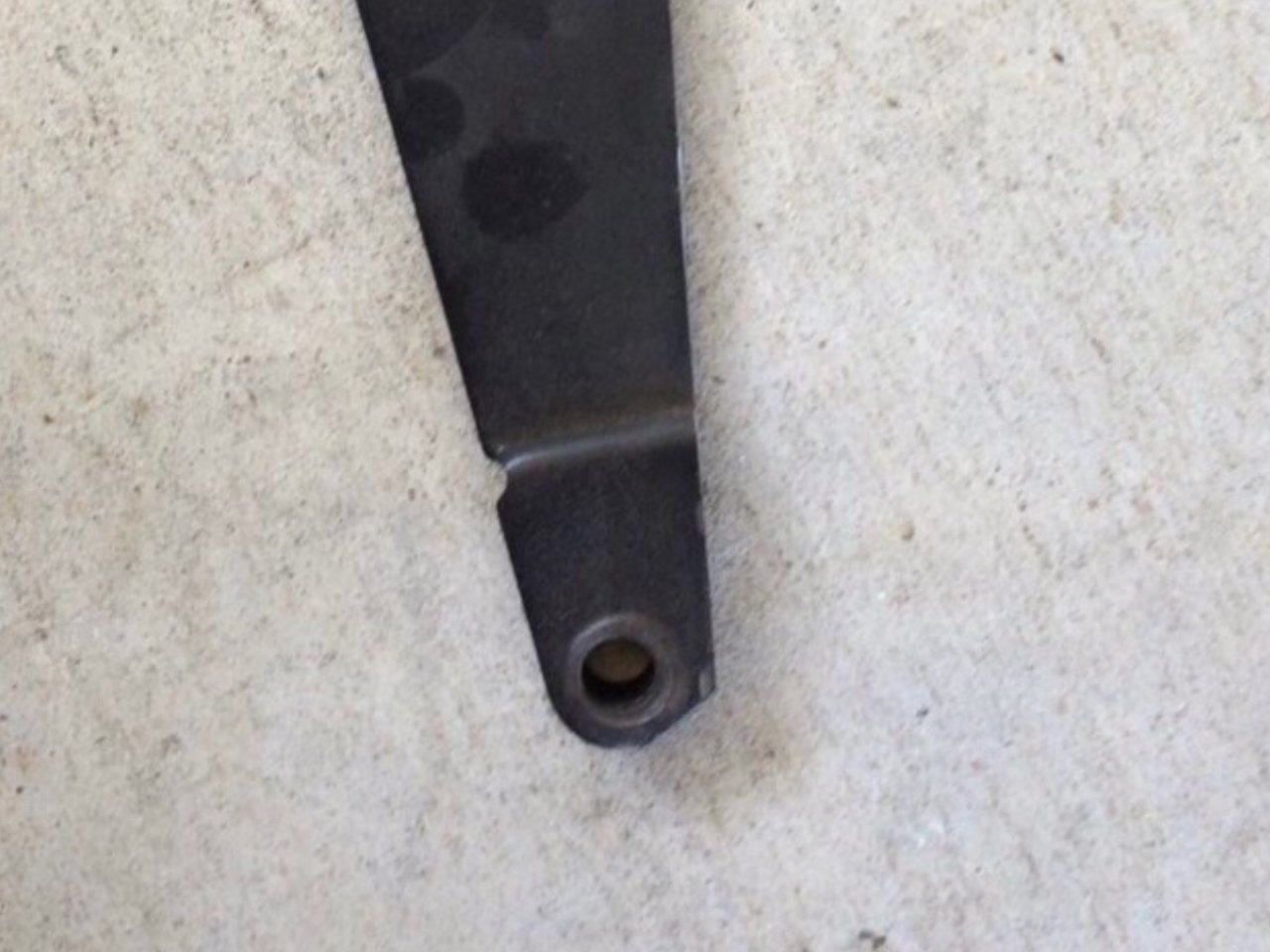

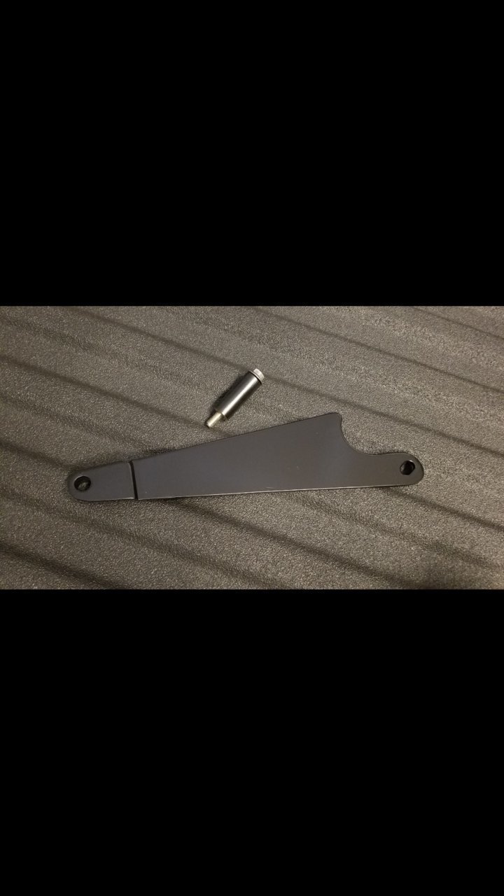

    Okay here it is. The dfx file to use to plasma cut your own out from 3/16 mild steel. It's 2 pieces so they'll need to be overlapped and welded together. The spacers I've sourced from speedymetals.com.
    Another option is I can make a handfull of them and sell them at a competitive price.
    Anyone interested in me making them up?

    I can make up the supercharger brace bracket and sell them for $90 shipped with all the hardware necessary to install. But I need a minimum of 5 pieces to do it at that price. 10 pieces I can do it for $80
    Like this one but unpainted.

    What's the material?
    What's the construction for the bend? Press brake or two separate pieces welded?
