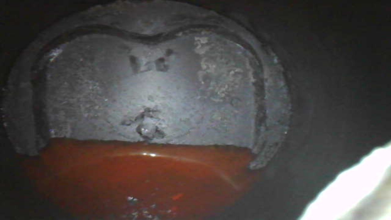

    RIP Taco. Not sure what the metal shaving looking things are..

    Damn. Have you inspected your rotor pack and housing??

    That my next move.

    What area is that photo? Where did you find shaving?
    Is the engine running?
    Take a magnet to see if they are steel or aluminum, supercharger is made of aluminum.
    You can take the top supercharger Plate off to look inside without removing the supercharger to see the rotors

    That’s a piston with coolant sitting on top. The shavings are probably from the S/C. Just curious why it would commit suicide like that.
