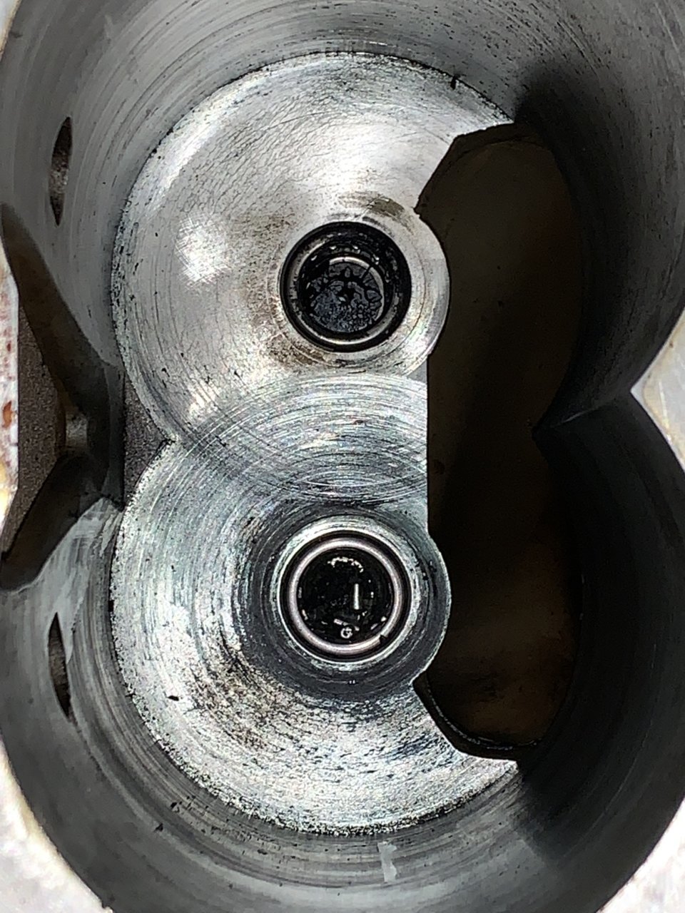

    I was approaching the 150k mark. Was planning on a rebuild. The SC has consistently sounded the same over its life. The head gasket issue was something I have suspected for about two years now. Rough start after sitting for a while, etc. This just confirmed the head gasket issue. But also if you go back to my previous posts in this thread I got a loud knocking noise from the engine last week. It sounded like the supercharger. So I immediately turned it off and had it towed home. Pulled the SC and it seems to rotate ok by hand (maybe some very light resistance here and there as I rotated it, but I’m not sure how it felt when I first got it). So No real smoking gun. Also I scoped down the intake manifold and didn’t really see any shavings. I am going to try to recover some of the coolant and see if I can get some of those shavings to come up with it. I’ll keep you guys posted. Anyways I think I’m gonna start searching for a low miles used engine to drop in.

    Pulled the rotor pack. One of the needle bearings is destroyed. I’m not an expert on the SC internals but the rotors look ok to me?I can make the rotors hit each other. One feels kind of loose. Is this normal when the rotors are removed and not support on the back end?

    the needle bearings control radial movement of the rotors. The rotor plate bearings control horizontal movement the rotors. Either one being out of spec will cause the rotors to contact. Your rotor pack is bad as evidenced by the rub marks on the back of the casing. You need a complete rebuild.

    Anytime a bearing is going bad the temperature of the case around it will go up. Do you think it would be beneficial to use a Tempilstick to monitor case temp around bearings?
    A tempilstik is a paint crayon that melts away at a set temperature. They come in 300,400,500......degree crayons. You'd just need to know what normal operating temp of case around the bearing. Then select the next higher Tempilstik and put a mark as close to the bearing as you can get, while still being visible.
    Just thinking out loud here.

    Well typically you will hear that something is not right with a different noise coming from the supercharger before a bearing actually totally crashes,
    That’s your warning sound.

    They sound should alert you for sure. The temp stick would just be another layer of info.

    Best to inspect the rotor pack every so often for scuffing of the plate, and housing. And also definitely rebuild before 100k.
    From what I’ve seen on YouTube they can make some marble noises and growling when they’re bad but these blowers make so much noise it can play mind games with you. As they wear they get louder as well.
    I’ve seen posts on here where people say theirs is silent at idle. I think you would have to be deaf to not hear the normal amount of noise that it makes. I may have some vibrations going on that makes the straight cut gears noisier but oil analysis shows that everything is fine and even taking it pretty well with less wear than expected for the miles go between changes.

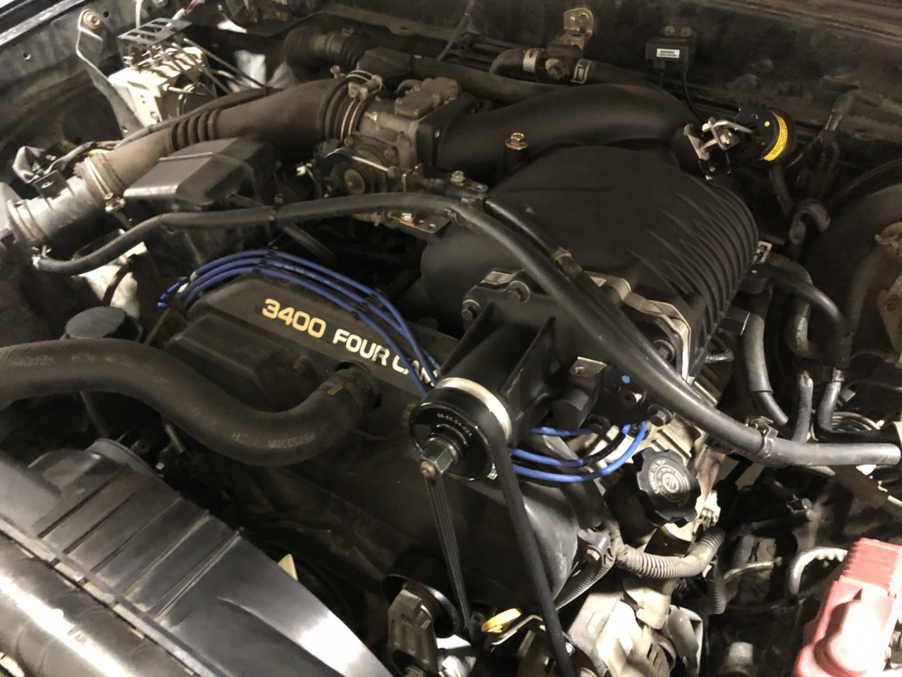

    Ill share my setup, AEM methional injection, URD 7th injector, 2.2 pulley, custom DIY cold air intake. only issues, it would hit 10psi at one point, now only about 6psi. thinking it is belt slip. but runs like a beast. Vpp5pdRdotAaWj8vEwd1p0Zdc6YmluUM-yRVIqfC_1eeaebac8a49aa1eab7be0133bcd76374b4dd673.jpg

    probably. Mine slips bad right now. Gonna try a contitech belt next. I’ve been through to many Gates belts.

    i only have about 3k miles on this belt if that, do you have the urd tension pulley? wondering if that would help

    No. It’s just a pulley. Does not include an updated tensioner. So it won’t help with slip, was designed to keep the belt from jumping off with a lot of off-roading.
    The problem with this design is the tiny 4 rib belt and the poor amount of pulley wrap you get. Belt slip is just part of it, you just have to learn to drive around it.

    ahh sounds good, cant do much about it then I guess. power at WOT is still pretty impressive I can feel my whole front end lift up when accelerated :)
