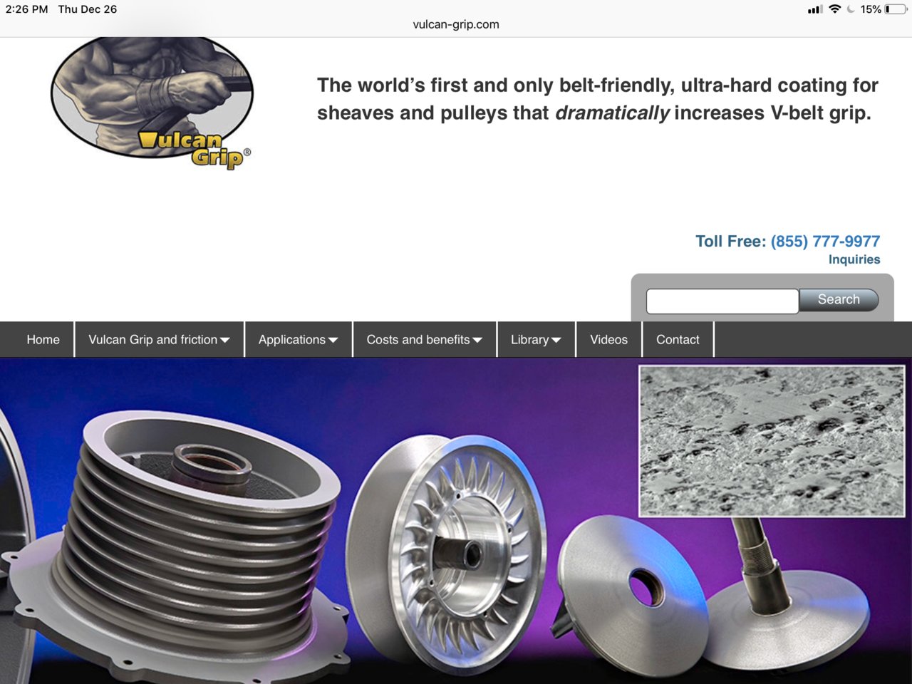

    Speed shops will address this with different types of finishes applied to the pulley.
    There are actually different types of course coating that can be applied to the pulley if it’s slipping to help.
    NOT this company but the same idea.
    Vulcan grip coating
    I forget the actual process but I googled this.
    http://www.vulcan-grip.com/

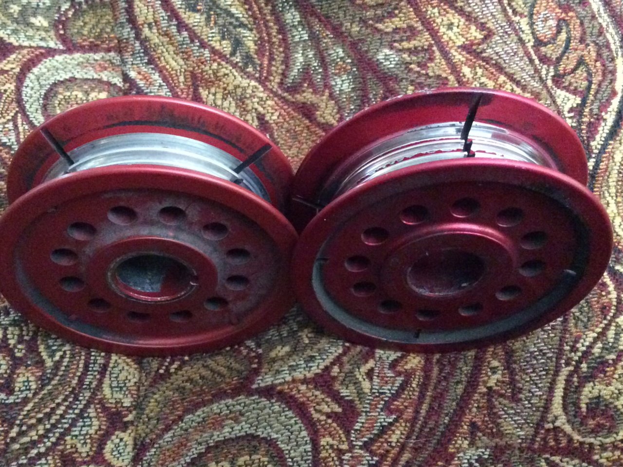

  13. Dec 26, 2019 at 1:41 PM
    #1493
    1997tacomav6
    1997tacomav6 V6 5sp,RegCab,TVS1320 Supercharger,Haltech, 800k
    Oct 5, 2013
    #113940
    10,386
    John
    Denver
    97 reg cab, v6 5sp 300hp supercharged, Methonal Injection, 800,001 plus miles, Original Owner
    V6 5sp,RegCab,TVS1320 Supercharger, 56mm pulley, methanol injected Haltech ECU, AC Tvs1320 supercharger,(MUST DO) every 125,000- 150,000 needs rebuild Projector headlights HID 5 speed manual Amsoil for all drive train Smaller 56mm custom pulley, (MUST DO) 2004 DESNO fuel injectors, zero ping ping, 2004 side door mirrors Dick Cepek Rims, Michelin tires LTX, ATM Pathfinders Dynopro ATM ( that last 100,000 miles) Now running Dynopro ATM mud and snow tires KN cold air intake Cat back dual exhaust with ss exhaust tip, Raised exhaust tail pipe to 2" below body line Optima*dry cell battery,red top Alpine sirius radio, 200 watt amp, focal is165 split door pod speakers Focal door speakers Subwoffer behind seat Viper alarm, Electric Locks Dark tinted windows, bucket seats corbeau lg1 Tacoma Rubber floor mats TRD fender extenders, Bilstien shocks, King shocks JBA UCA trailer iv hitch, electric brake control, Drilled slotted brakes, High carbon steel (MUST DO) EBS green stuff 7000 series pads(MUST DO) TRD engine oil cap TRD stick shift, Marlin crawl shift kit. Rear sliding window 2002 4Runner functional hood scoop cut into Tacoma hood, 4Runner dual overhead map light Gentex Auto dim + Compass + Temp, garage,rearview mirror Snow Methonal kit stage 2 Custom 3 core aluminum radiator Linex bed liner Haltech stand alone ECU, Intake supercharger gauge. Stainless steel brake lines, Custom leather wrapped steering wheel, Haltech stand-alone ECU,
    Both of these are shot and the belt has skid marks on the ears from slipping.
    It’s the pulley that’s the problem NOT the belt.
    If you see all the paint gone on the center rib area, that’s your problem

    TRD S/C, ADS coilovers.
    From The HSS? Are they using the Vulcan Grip? The website seems like it was reserved for OEMs
  19. Dec 26, 2019 at 2:19 PM
    #1499
    1997tacomav6
    Oct 5, 2013
    #113940
    10,386
    John
    Denver
    this is an example only but same process Im having done for a new pulley 4 myself, NOT this company
