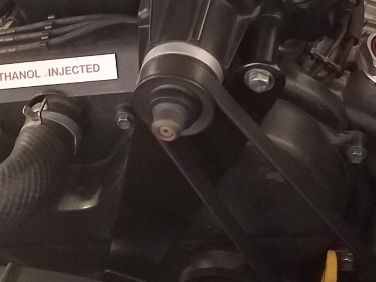

    You can sell you old tensioner bracket for 100.00 ,
    I paid that for one and cut it up to make a bracket support for the nose of the supercharger

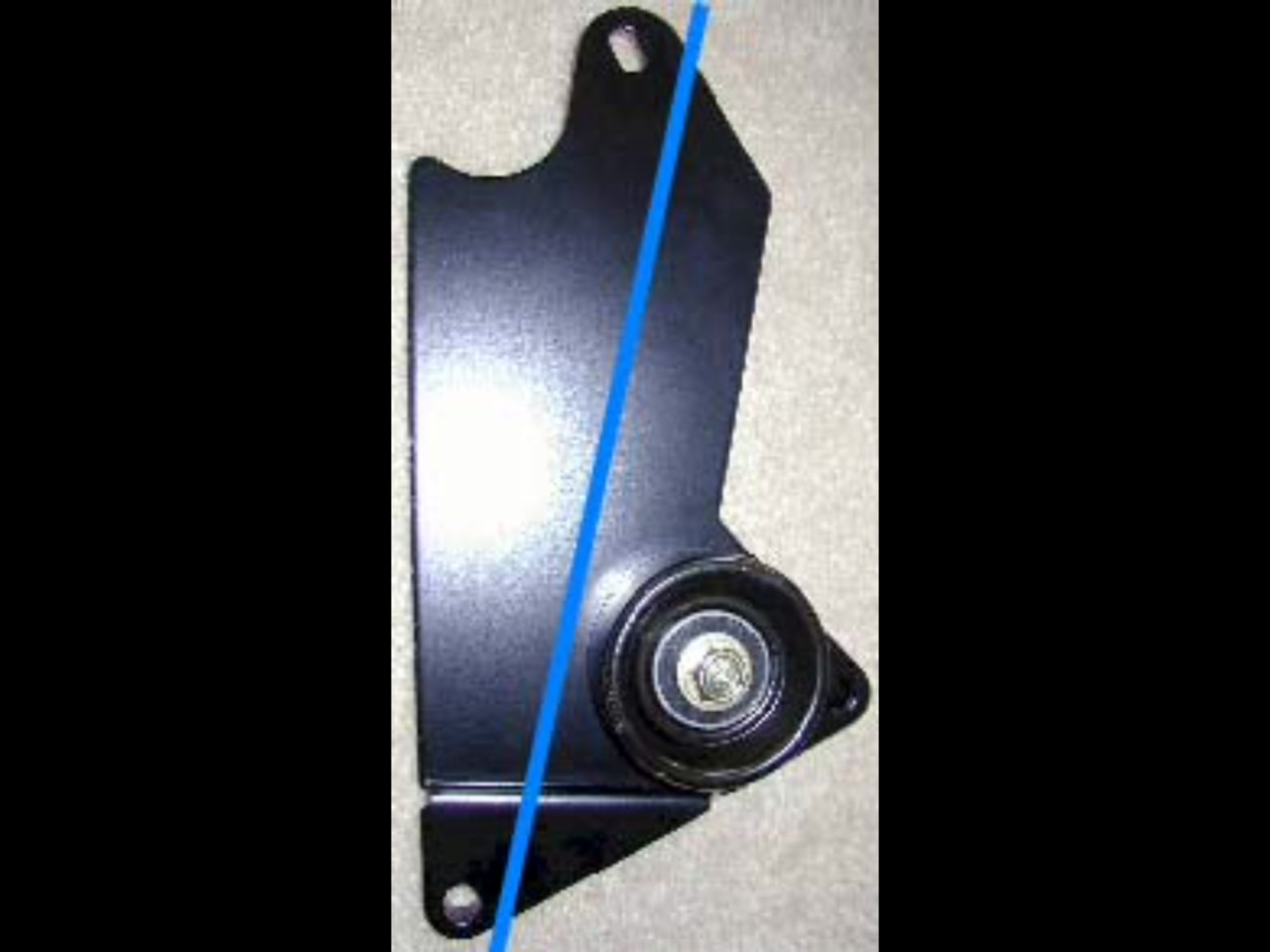

    Can you just get the tensioner and put it on the old bracket?

    Old bracket tensioner comes off, if you want the bracket you need to cut the old tensioner to make it into a bracket.

    ok, I assume it bolts to an already drilled hole, does it come with the bolt?

    The new tensioner kit I believe comes with all the hardware.
    If you cut the old tensioner into a bracket you use the bolts and spacer that’s being used now

    It’s best to buy the dynamic tensioner new, the spring does wear out and get the complete kit.

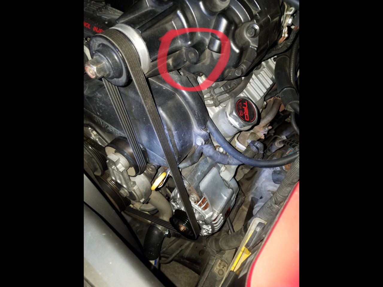

    Anyone know if the support bracket works on the newer magnuson SC

    Yes, he is, I gave him the copy of mine.
    If there is a threaded hole on the snout it will work.
    I don’t think the newer supercharger have the threaded hole, there’s a stub there that might be able to drilled.

    They don't, mine doesn't. You have to drill it if you want to add the bracket

    The TRD models I think do tho

    Mines a TRD model

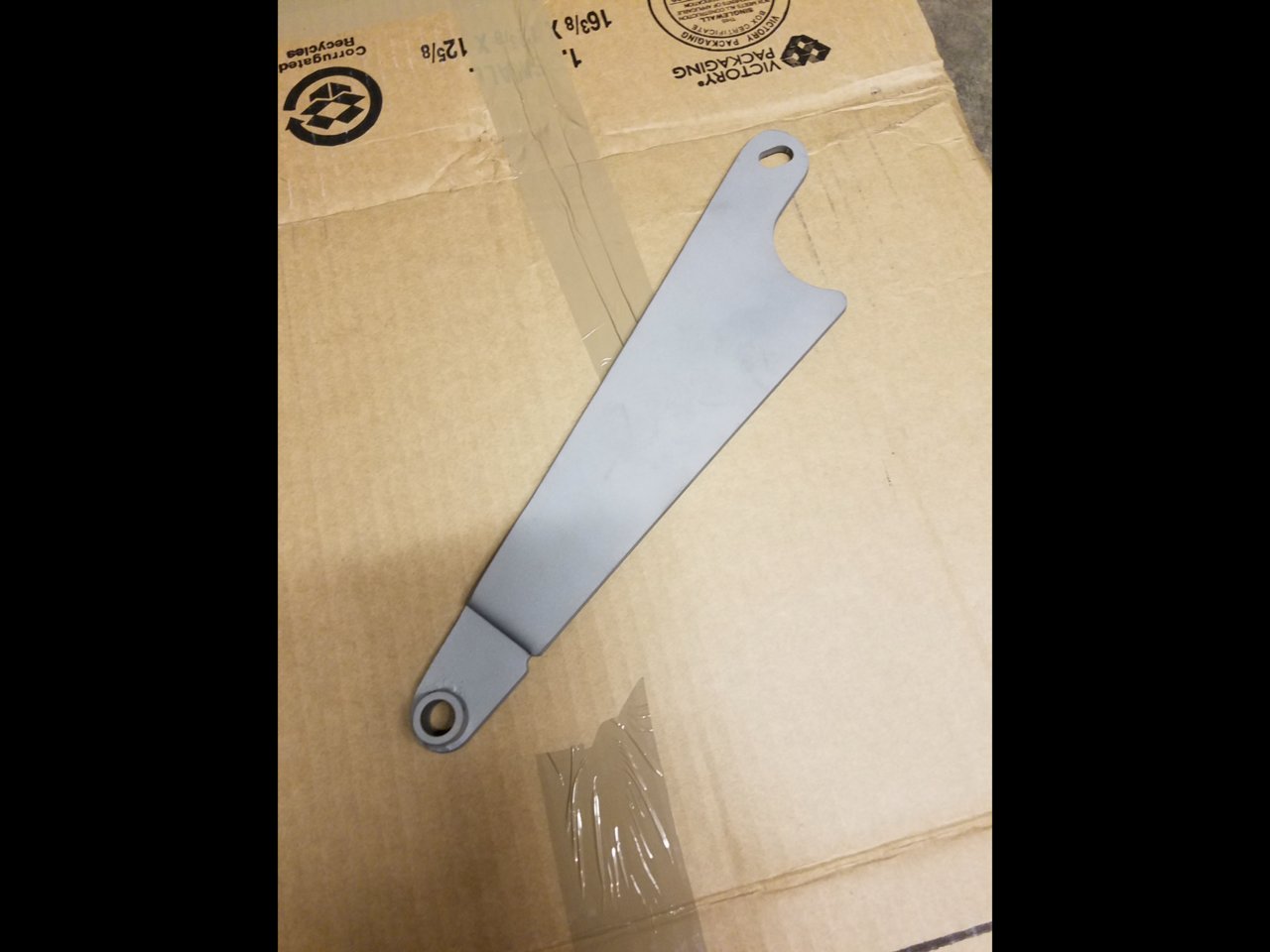

  15. Dec 30, 2019 at 8:48 PM
    #1555
    mechanicjon
    mechanicjon They call me "Jonny Stubs"
    Dec 2, 2016
    #203828
    10,151
    Jon
    Scottsdale Arizona
    04 Taco SC 4dr SR5 TRD Prerunner
    Supercharged, AEM FIC/6, Meth Inj, ION Alloy's, Radio & Phone steering Wheel controls,Fabtech AAL, Billie's wrapped with 880's , Tundra big brake conversion, bully bars and Pioneer DDin Stereo/dvd with exterrnal usb ports. 290K and going strong.
    Picked up the brackets today from the plasma cutter. :D:D:D:D:thumbsup:

    You have a stub that can be drilled or threaded then?

    Cool, did you get the top bolt, and bolt spacer too?

    Yeah the stub is there, just no pre-drilled/threaded hole. I forget who it was but someone here just drilled his to install the bracket too

    ahh ok thanks, i am looking at the Magnuson version right now, and dont see a tap/threaded area. maybe on the next rebuild, i have like 4k miles on this one and dont want to ruin it. I can do pretty much anything, but when it comes to drill/taping threads i am the worst at it.
