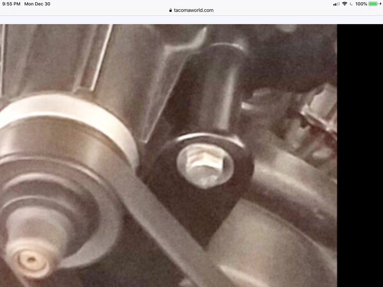

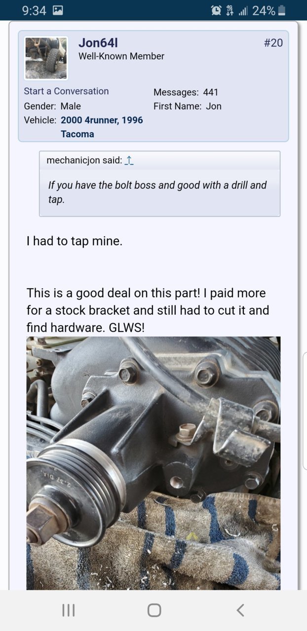

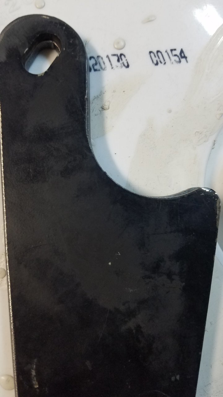

    You can always just take the snout off and take it to a machine shop. I don’t think the supercharger has to come off for that if you decide

    For the 2nd gen supercharger (black one), the proper way to utilize a modified 1st gen support bracket is to face the nub (make the front FLAT so the spacer sits properly on it) and then drill and tap the correct size hole/thread/depth. An "easy" job for a machinist, but it's usually not cheap for a one-off, custom job like this.

    Man I wish I could remember the guys username that just did it lol, he posted a photo in this thread I think or maybe another one...he just took the belt off and put a towel underneath the pulley and drilled/tapped the hole. Seemed pretty easy/straightforward

    yea, but you can ruin a thread real quick. has to be straight and dead on, aluminum inst forgiving.

    @Jon64l

    hmm so i am thinking... install the lower bracket bolt, then line up the upper bracket hole with the spacer and use the spacer as a guide for the drill..... hmmmmmmmmm

    Yep that's it

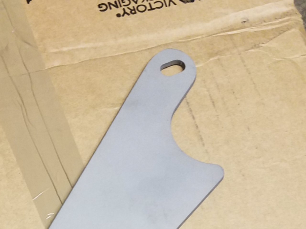

    The original bracket has an oval hole to suck up against the supercharger up tight, so there is room for play.
    Not sure how the copy is made tho.

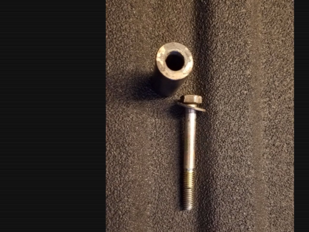

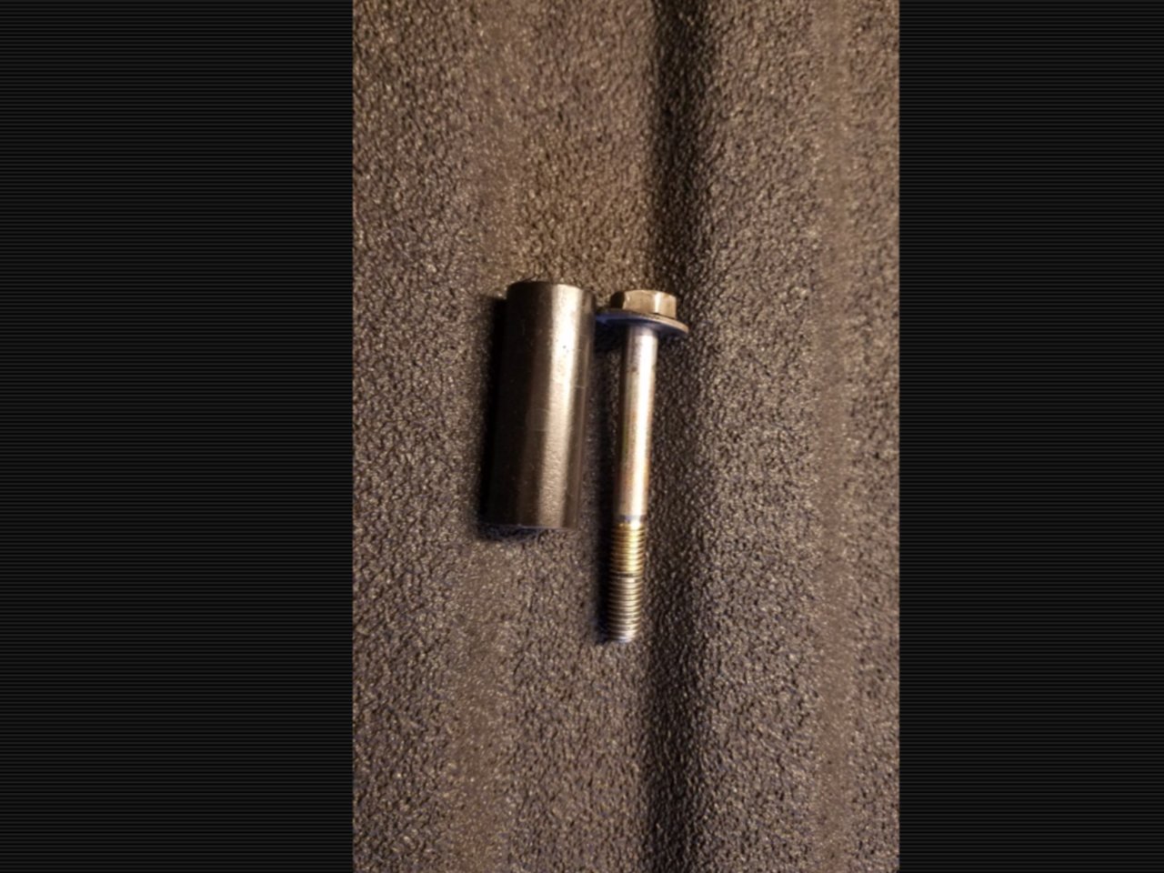

    Got top bolt also. Spacers will be here Monday.

    Oval hole.

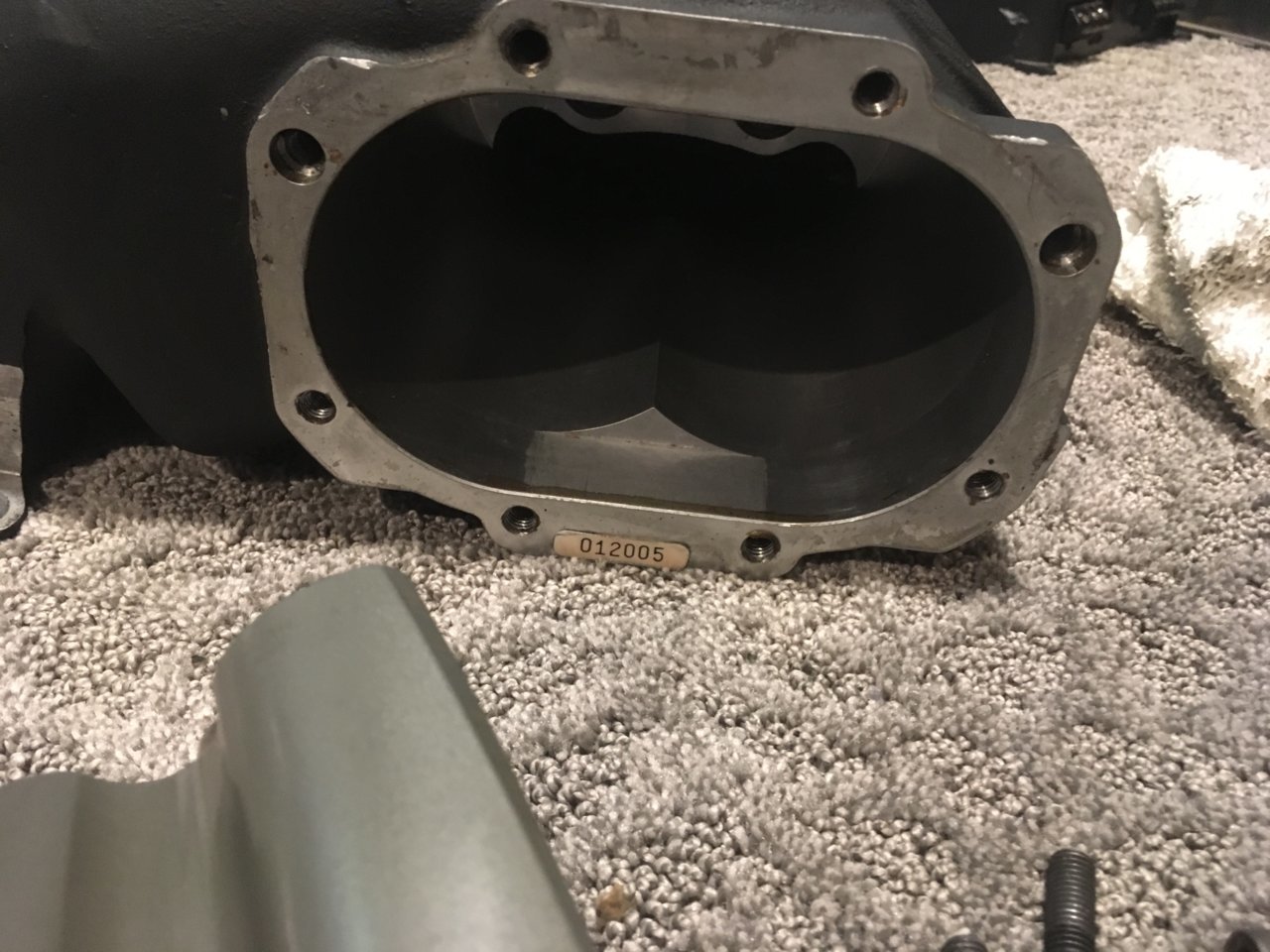

    image.jpg Also, do the trd sc’s have serial numbers?

    I think I remember a sticker with numbers on my rotor pack section at one time.
    Could be that or a rebuilds reference numbers.
