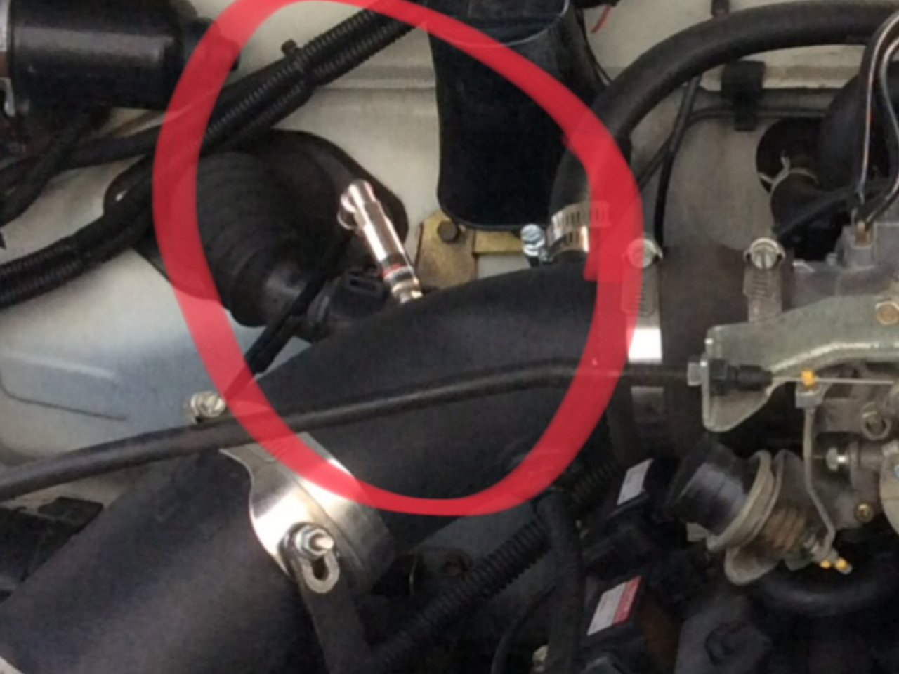

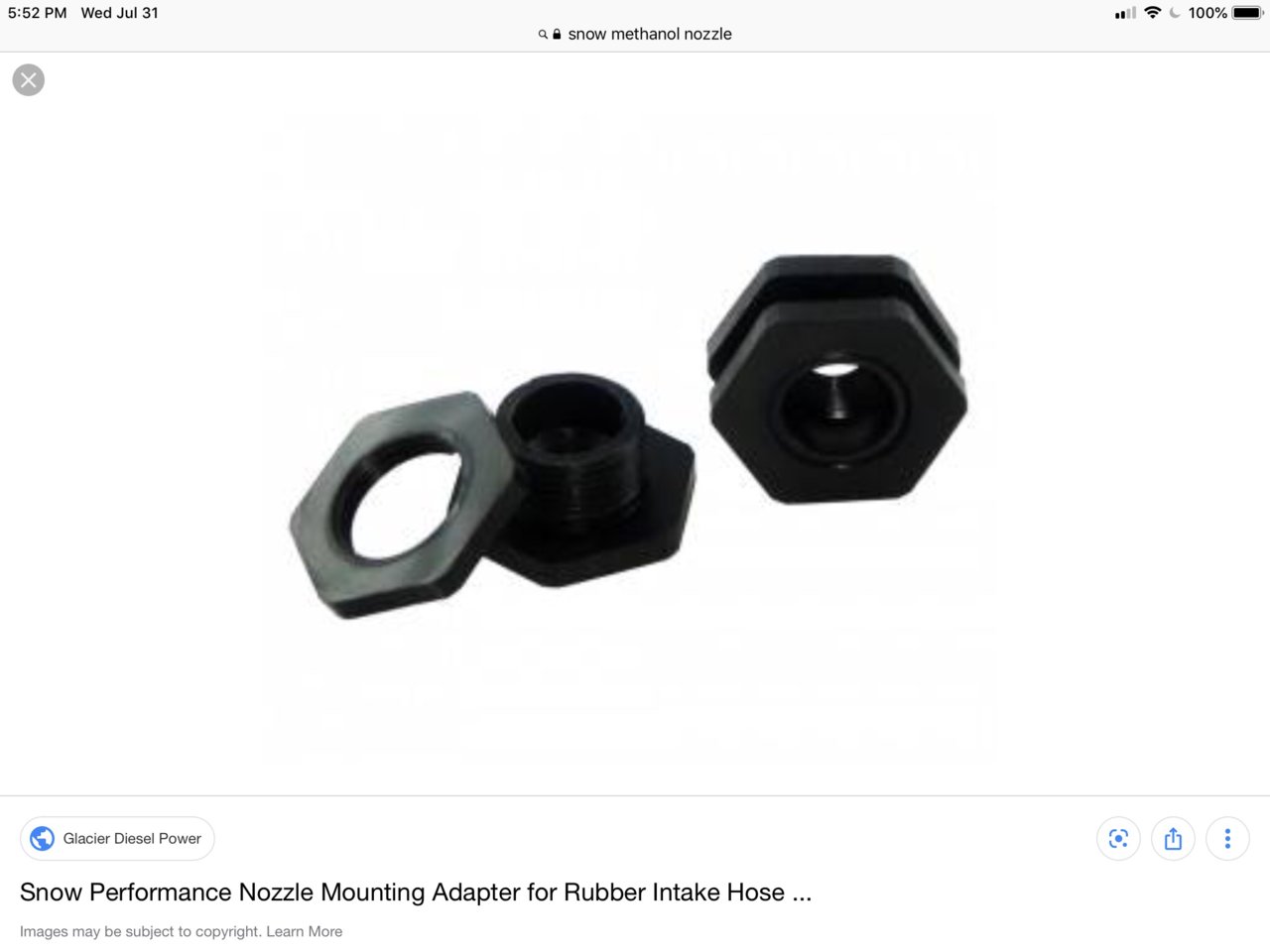

    For those of you that are getting the methonal kit the kit comes with nozzle that needs to be threaded
    into the intake pipe and sticks straight out. You have to drill a hole and tap and die the threads for the nozzle.
    I had this setup and later got the low profile nozzel and adapter that has two pieces that thread together.
    The low profile is a better setup but either will work.
    The low profile setup and stock straight profile setup here below.

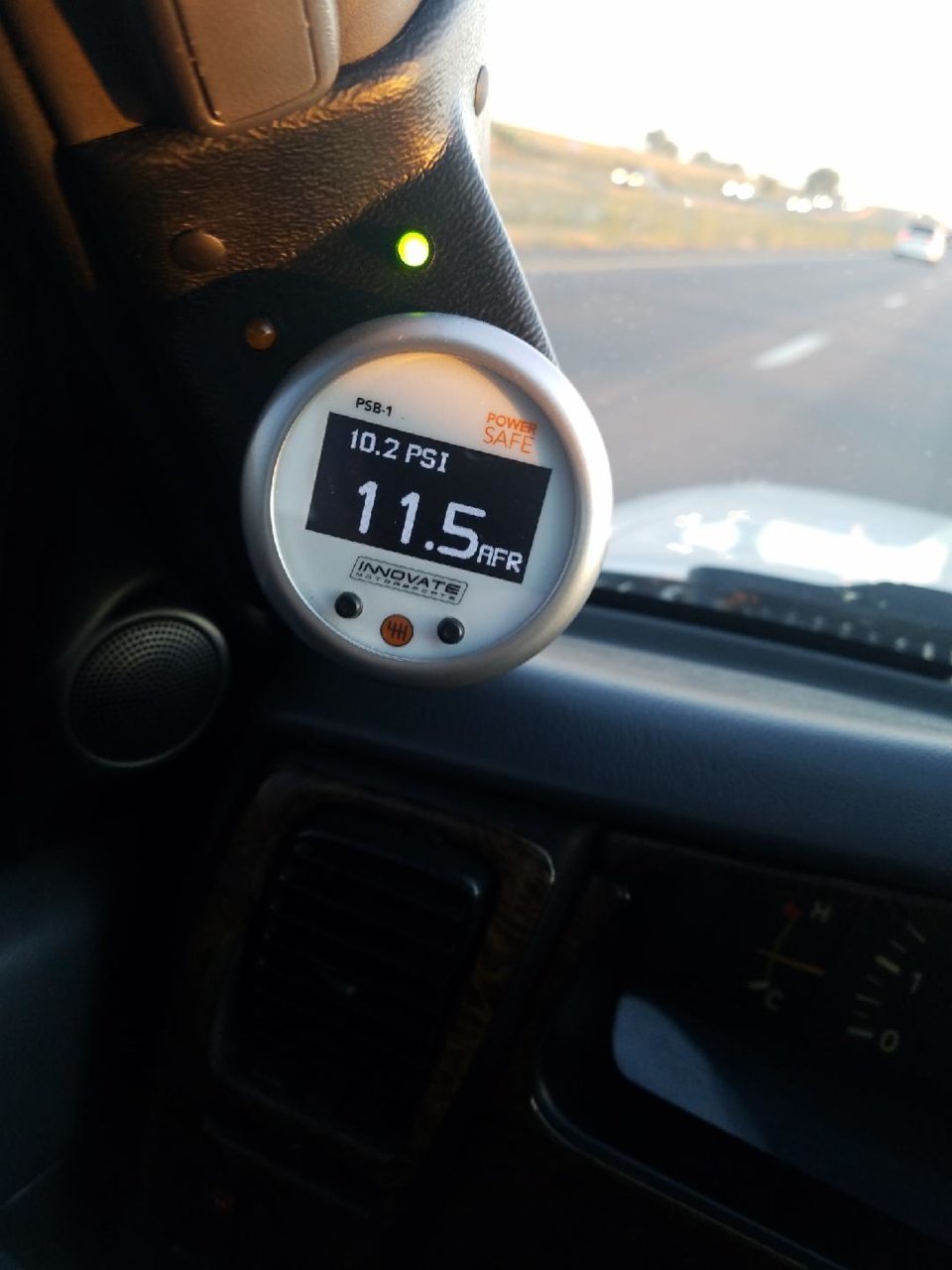

    Hey, how do you check if your engine is running too lean or too rich? Like a scanner/sensor, smell or something?

    With an AFR Gauge like this.
    On full boost you should be at 11.5-12.5

    Like John said you need an aftermarket AFR gauge with a wideband O2 sensor to truly know for sure, but if you're running really lean you'll be able to tell when you accelerate under boost when the engine starts to ping (sounds like marbles in a can, it's an awful sound). Too rich and you'll probably smell a lot of fuel, tons of black soot on the exhaust, etc. Running rich isn't as bad as running too lean though, too lean can destroy an engine in short order if you push it too hard.
    AFR gauges are good to have because you can monitor it closely by numbers

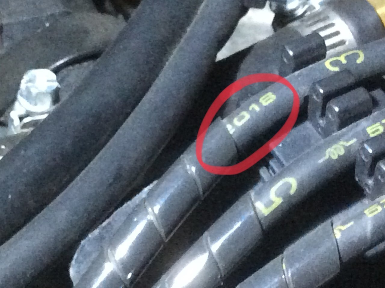

    Johns truck was awesome.
    These 5310 IK22s are showing they don’t fit. I’m guessing they do right?

    They do fit, others here run the same plug besides me too.

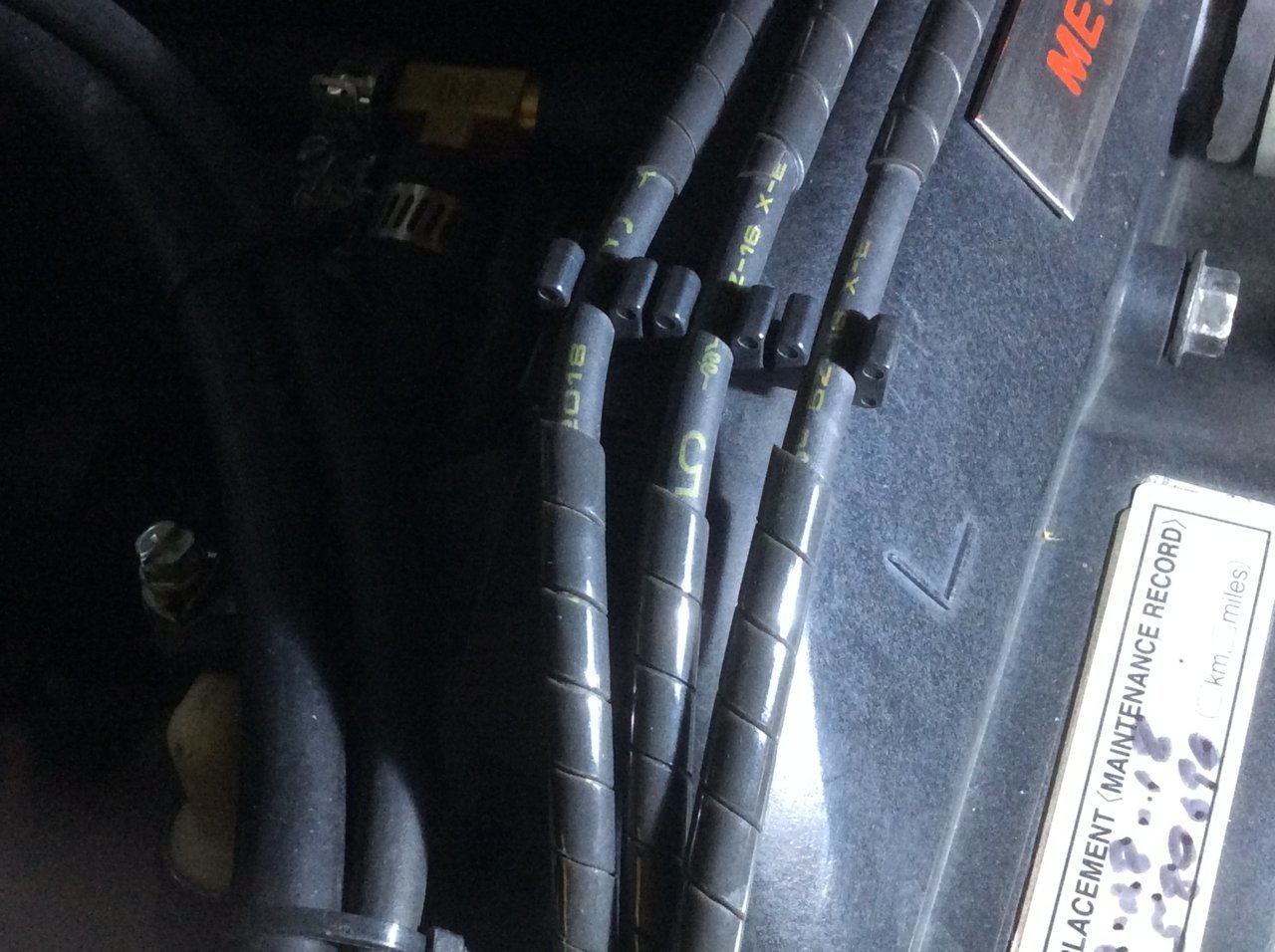

    Ok. Is there a set of wires you recommend with the plugs? Thanks

    Stock is all you need. Just look at the date code on them
