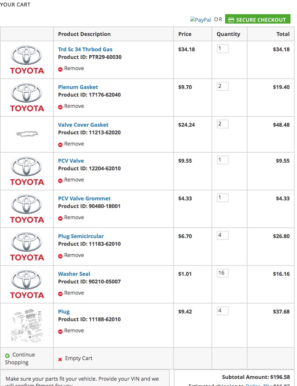

    This may be silly, but I just want to make sure...When I install my supercharger, I'm going to basically reseal the top end of the engine. This is my parts list that I have for that job, but I just want to make sure that I do or do not need the two new plenum gaskets. Also I need to check and see if my supercharger came with a new throttle body gasket or not. I don't have the box with me currently.

    supercharger kit if new, should come with the throttle gasket. its specific to a SC engine. the lower plenum can be reused if the metal type, but better to just buy a new oem metal gasket.

    Good deal, thank you for the reply
