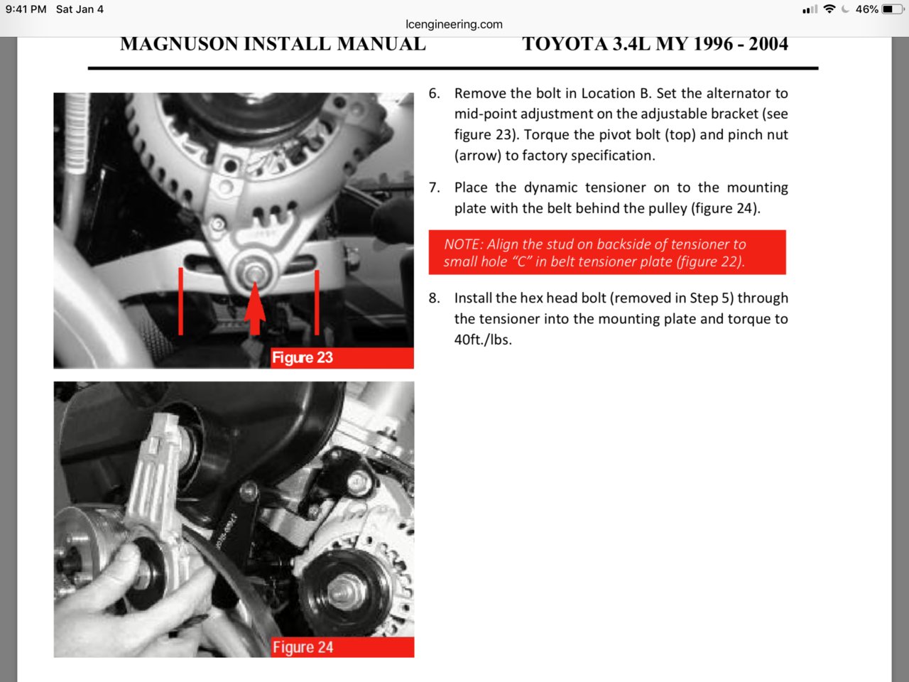

    It shouldn't really matter where they say to put the alternator at with the dynamic tensioner, belt tension is only as strong as the spring in the dynamic tensioner. pretty sure they say the center because of belt size and where the dipstick location is

    Yup, the dynamic tensioner for the most part should keep the belt tension correct.
    I had the stock pulley 2.4” or something like that and now I’m using the 2” pulley and I did not have to make any belt adjustments with no belt slipping.

    It definitely puts more tension on the belt. There’s a thread about it on custom tacos and I I’ve had less slip when the pulley is more to the right side.

    you sure that thread is about the dynamic tensioner? i cant see how it would put any extra tension

    The alternator adjust all the way to the end causes the tensioner to pull farther on it's spring (winding it tighter) adding more tension.

    i checked out my belt and its 5/8's longer than the normal supercharger belt.that paired with the smaller pulley, for me to get the same tensioner tension my alternator has to be further to the right forit to avoid the dipstick. but if i had the normal size belt and I had to choose from the belt always slipping a little or run it tighter, I would gladly run it a wee bit tighter wear on things a little more and rebuild it sooner than deal with it working shitty

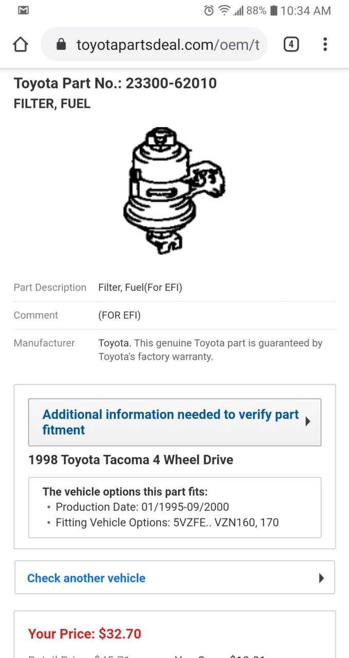

    According to what I found that's the PN for the 1995 - 2000 Tacoma fuel filter. I guess 01-04 is different

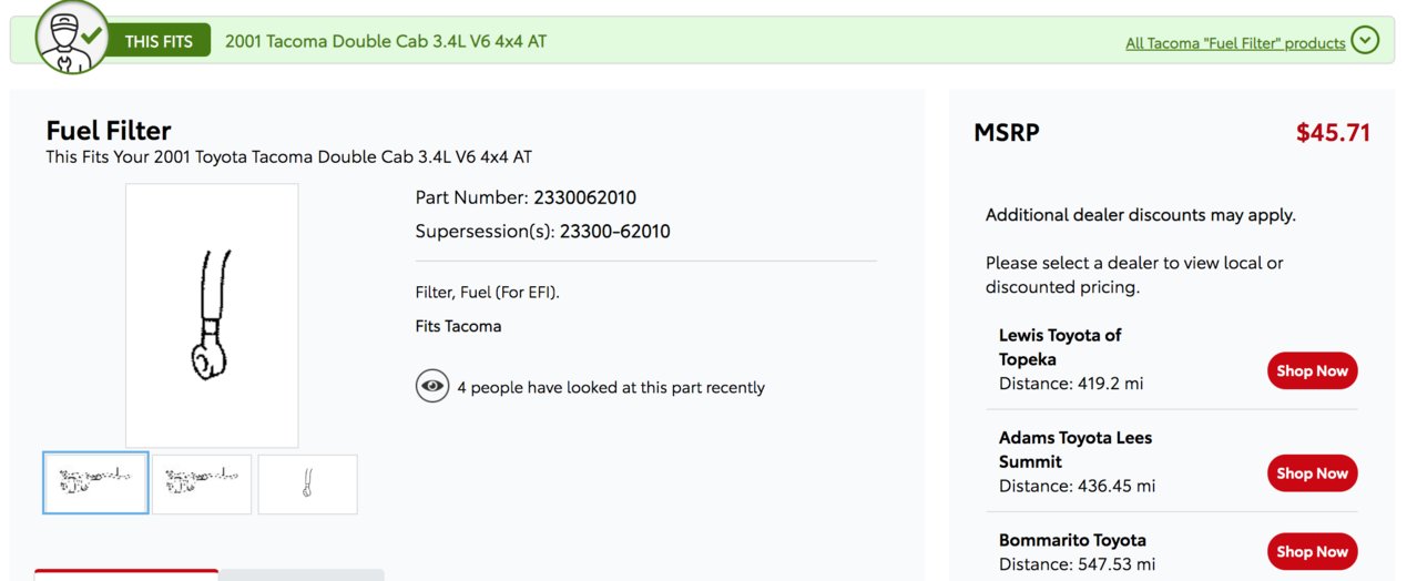

    That might explain the discrepancy. I have a 2001

    Here I see the same part number saying it will fit a 2001 and the first picture looks nothing like a filter... :confused:

    Haha yeah sometimes the Toyota illustrations of parts look waaay off. Their tie rod one does too. I would maybe confirm it with other OEM parts suppliers but yeah some of their drawings are whack

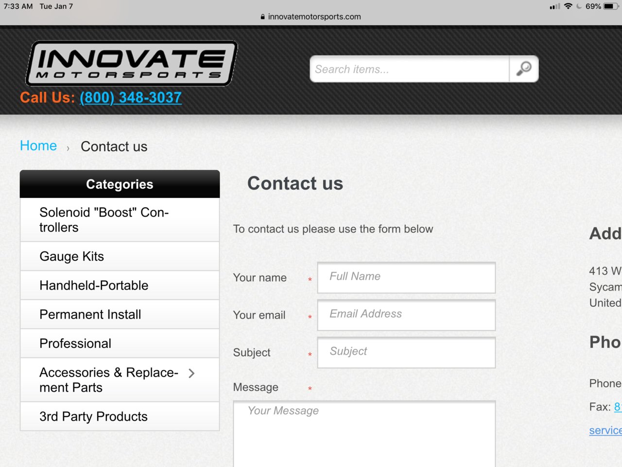

    My AFR gauge went whacked. This time it’s the boost part. It’s reading 46.5 psi. AFR is good. Called the performance shop. They never heard of such a thing. So I thought I’d mention this on here. I have an appointment Monday to figure what’s up. It could be a bad boost sensor? Not sure.

    Probably the sensor maybe, call innovation tech support line. They should know and possibly they can send the part out on warranty.
