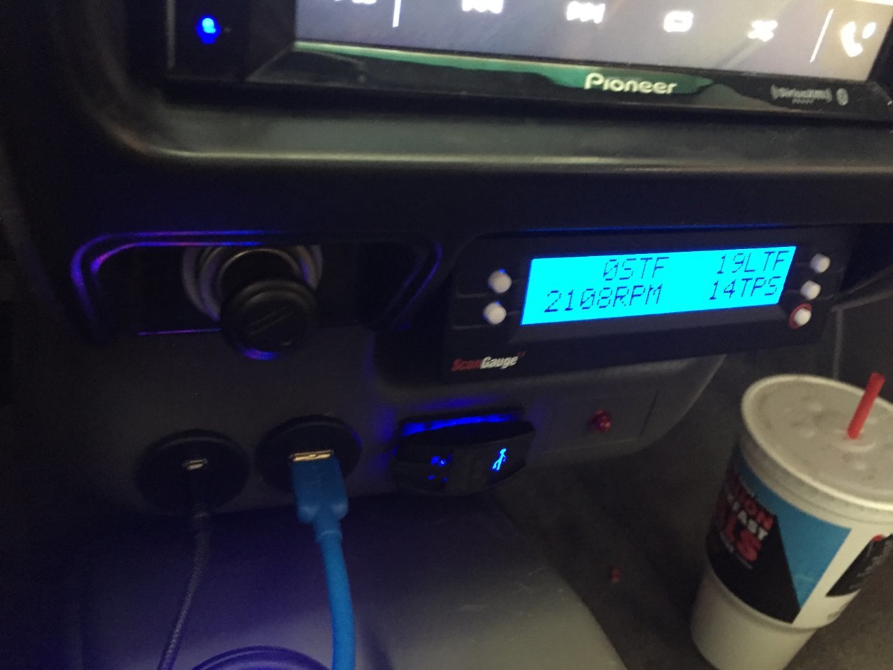

    You have to go to setup and click calibration
    Select an RMP and hold it there of 10 seconds
    For TPS you put the truck in on position with the engine off
    Click ok with no pressure on the pedal

    Good. Now set the closed loop enrichment to come on sometime between 1-3psi. Maybe aim to ramp to 13-12.5AFR

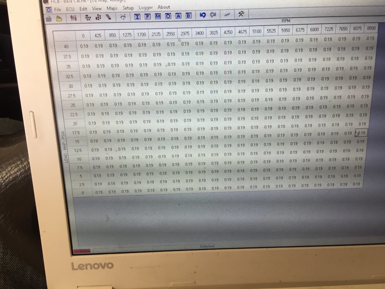

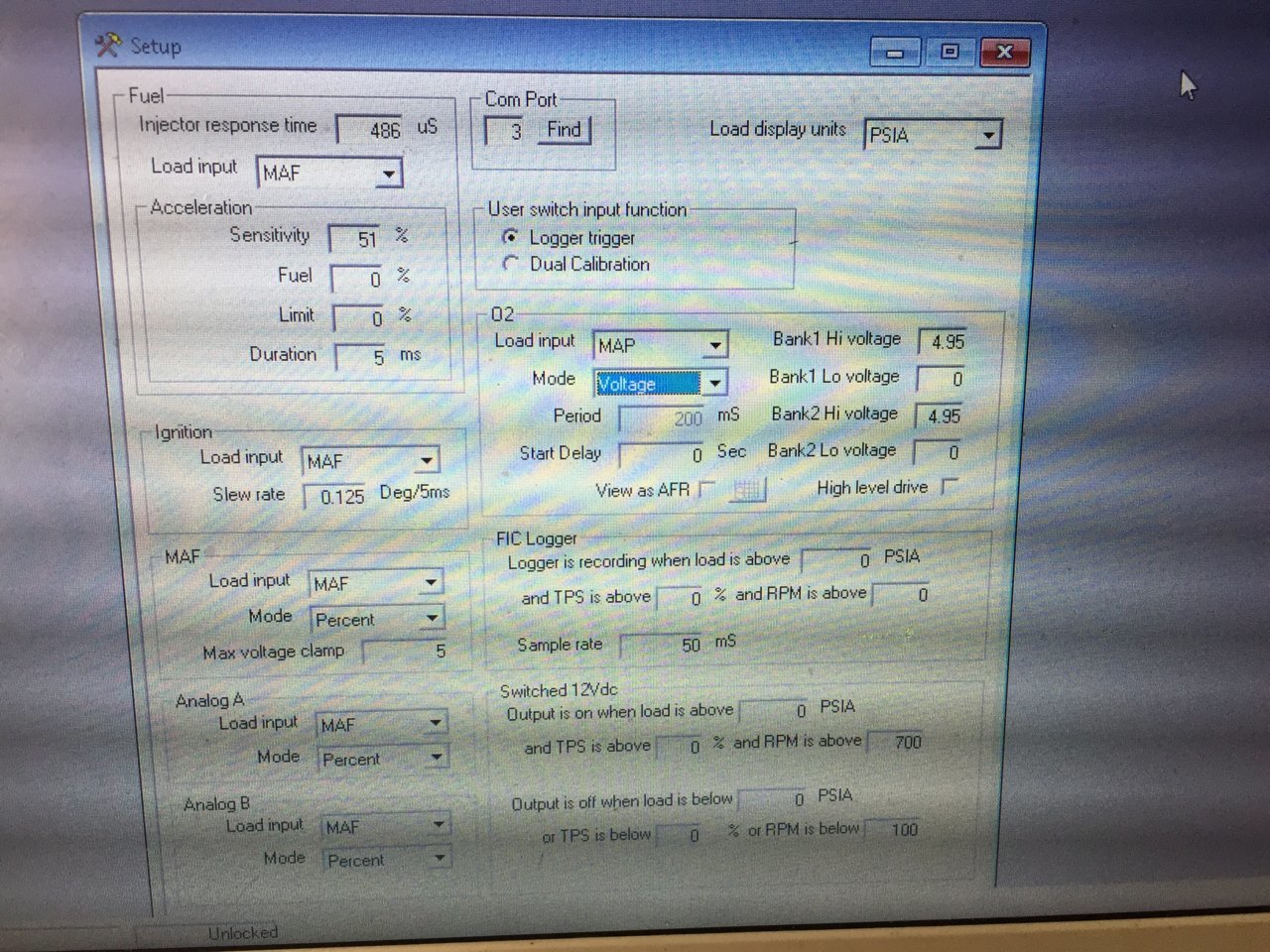

    ABCD547A-05CD-4B13-8E53-CAF5994B83DF.jpg ABCD547A-05CD-4B13-8E53-CAF5994B83DF.jpg BD36F5BE-1BFC-4010-A75D-844E045146B0.jpg
    Truck at running temperature
    O2 table at 0
    Nothing
    UPDATE: I had to check the High Level Dive box...it worked

    Unfortunately I don’t know what I’m looking at. I’m not familiar with the AEM software and tables.
    Are you still trying to figure out how to enrich the closed loop areas?

    IIRC you you need to switch the o2 to “AFR sensor” somehow because you have the factory AFR sensor. then there should be a way to just choose a target AFR for a boost level and it will self populate.
    There’s a thread for this but I’m not 100% sure.

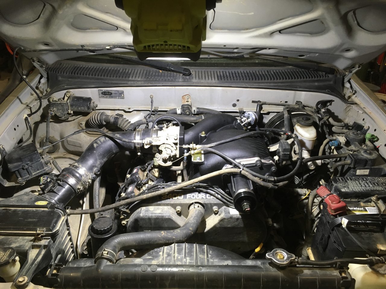

    Finally started this project on my truck. Valve cover gaskets and spark plugs were changed yesterday. Now on to more fun things!

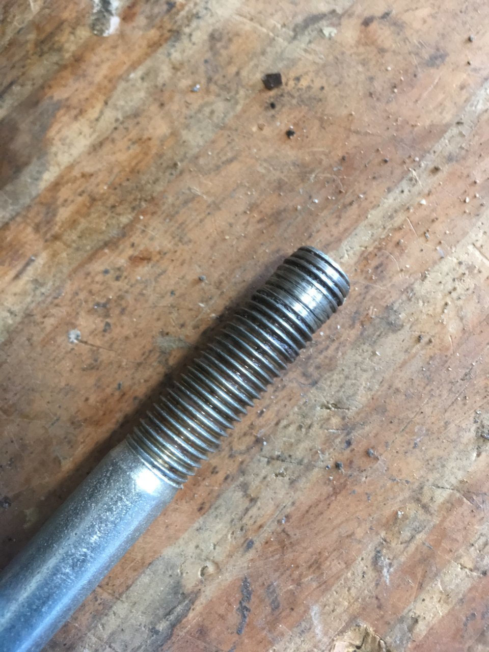

    Already ran into a problem. The belt tensioner bolt jacked up on me...after I ran it in and out a dozen times to make sure the dirt was out of the hole. I went to tighten it with the torque wrench and that’s all she wrote.

    That same bolt has always been kinda hard for me the last threads.
    I ended up putting grease on it and that helped a ton.
    Time for a new higher strength bolt

    It wasn’t tough to thread on, that’s why I’m so puzzled. Now I’m trying to find a replacement

    Will you have to use a tap and die set to clean the threads in the block?

    Most likely. Of course I don’t have a tap that size.
    Edit: Turns out I do have an M10x1.25 tap! Ran it through and cleaned the threads. Now if I could only find a new bolt....
