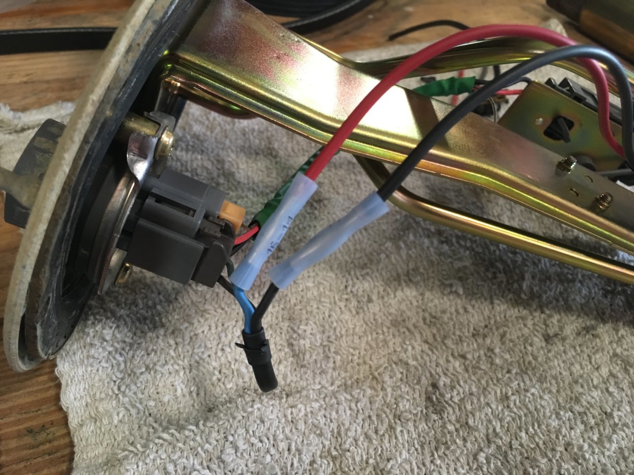

    First of probably many questions for the 7th injector kit.
    I’m wiring the new fuel pump and am concerned about the connectors they provided and said to use. The directions say “these connectors are designed to be submerged in gasoline.” Are y’all applying liquid electrical tape to the ends? I thought they would be heat-shrink connectors but they did not shrink. I would have put a heat shrink sleeve over them had I known this, but they’re connected now. They don’t seem waterproof to me, but what do y’all say? I’m not sure if the liquid tape will deteriorate being submerged in gasoline.

    mine have been just fine like that. Make sure you use the proper crimpers though so that they’re good and tight.
