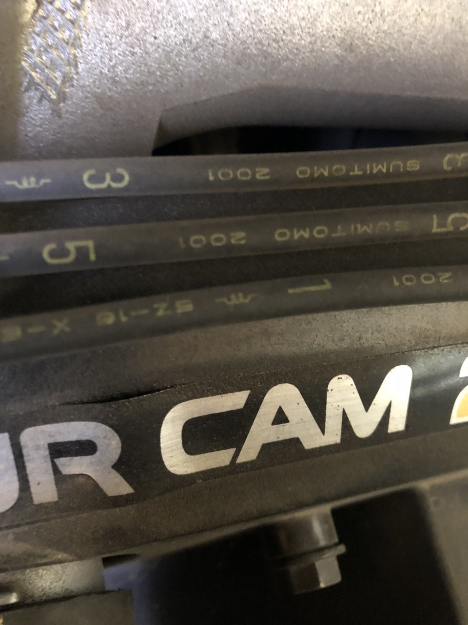

    image.jpg That then? I’m over at the Parker parts store.

    Time to change those wires for sure:)

    I think so, get 6 of them, that’s a 4 pack

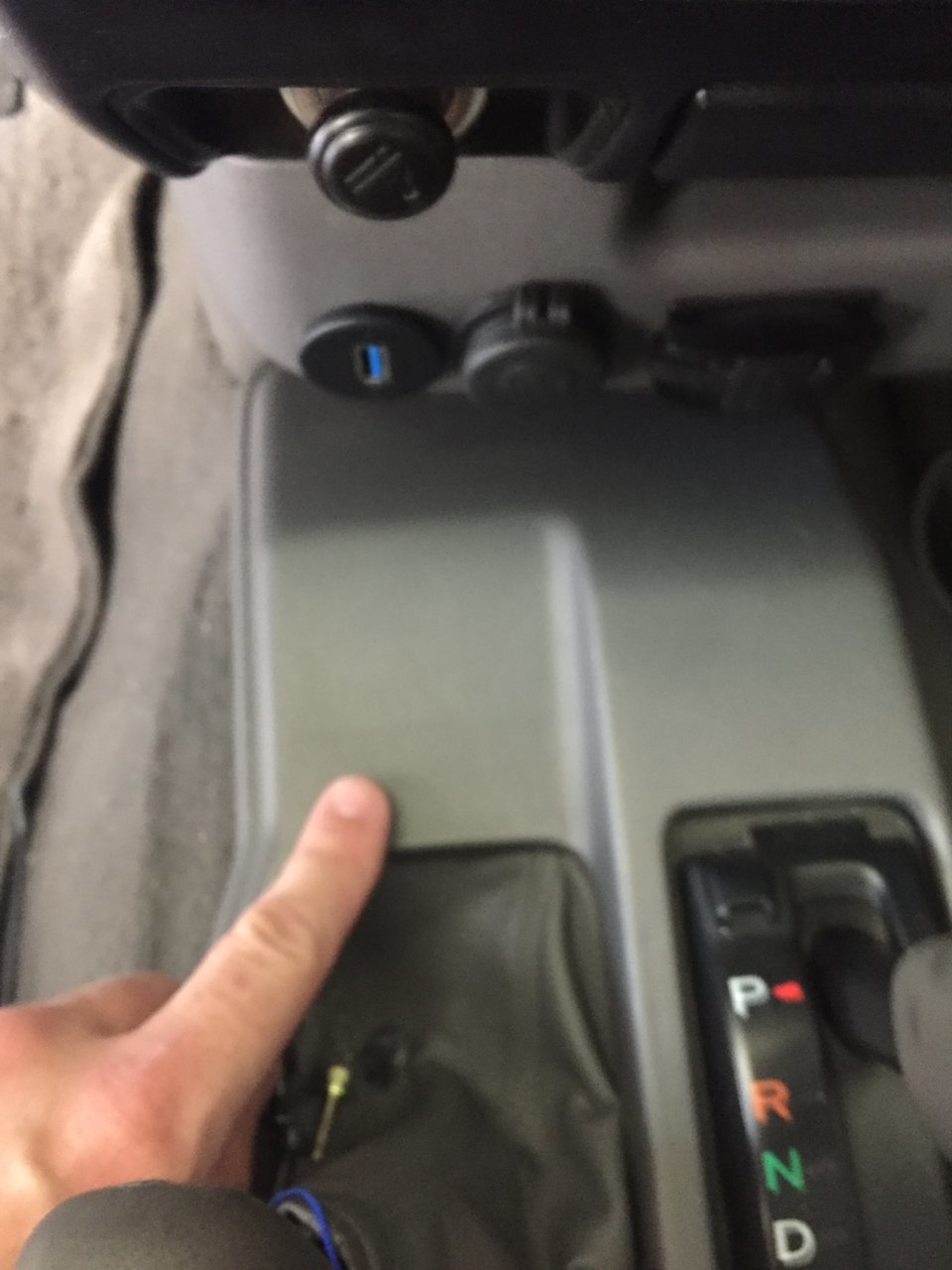

    Anyone put a gauge here? My pod is full
    Need to move transmission gauge

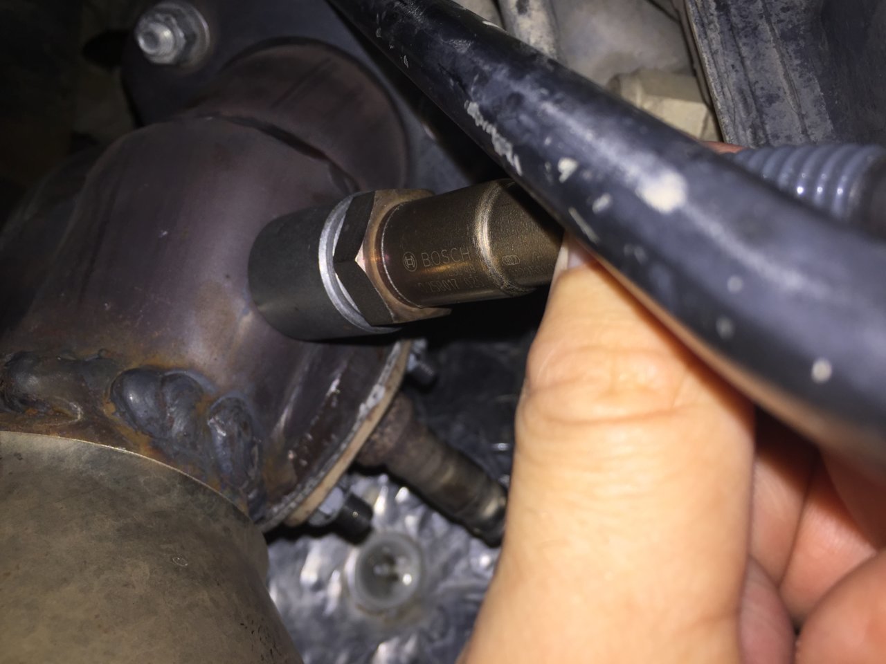

    I recommend taking off your front Cat and taking it somewhere to have someone weld a bung on it. The rest of the install it pretty straight forward.
    Once you install headers, it becomes a more difficult process.
    When you do get headers, you need to weld on another one as the headers for our trucks have some required welding. Mine was welded on from under the truck because I didn’t what to go though the Pain staking process of unbolting my cross pipe..really tight spot.
    Needs to go pre both cats
    That’s the transmission dipstick tube in front of my Thumb

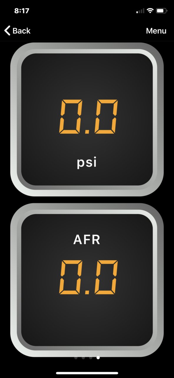

    Not sure how accurate this will be but it’s for “in the meantime” type deal. It’s bluetooth to the OBD. 98064DD6-3E56-42E3-A534-1A4F36B609A1.jpg

    Our trucks don’t provide a AFR or Boost reading through the ECU to the OBDII as far as I know.

    Hmm. It’s showing numbers LOL. Something like 14.5 AFR in idle and minus something in boost. I’ll test it out and see if it makes any sense.

    Don’t think its accurate in boost.
    I don’t think it reads boost maybe vacuum tho.
    Not sure how accurate these are.
    My scanguage has a bunch of options and I know they are not correct that correct to the same port.
    So don’t know

    If your wanting to know 100 percent the correct readings for AFR and boost I would want a dedicated
    gauge specific. Any error with AFR could be a disaster, with boost not so much

    You’re right. It seems a lil dicy. Especially when accelerating. Gotta look where you’re going.

    Those are your narrowband AFR numbers which is what the stock ECU reads from your OEM o2 sensors. To properly and accurately monitor your boost AFRs you want a wideband o2 sensor reading from before the catalytic converters which is what the aftermarket AFR gauge/sensor provides.
    Those AFRs from your ECU are helpful in monitoring closed loop AFRs...but what you really want to monitor are your open loop numbers (wide open throttle and high boost) and for that you want the wideband sensor, the ECU won't let you know if it's concerning or not in open loop.
    Basically if you're not boosted then using that AFR reading from your scanner is fine, but if you are boosted then that reading is not sufficient.
