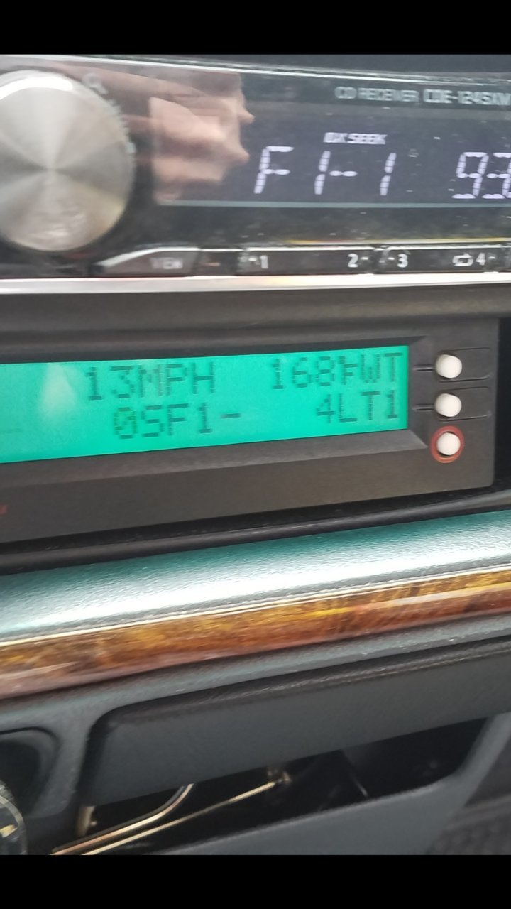

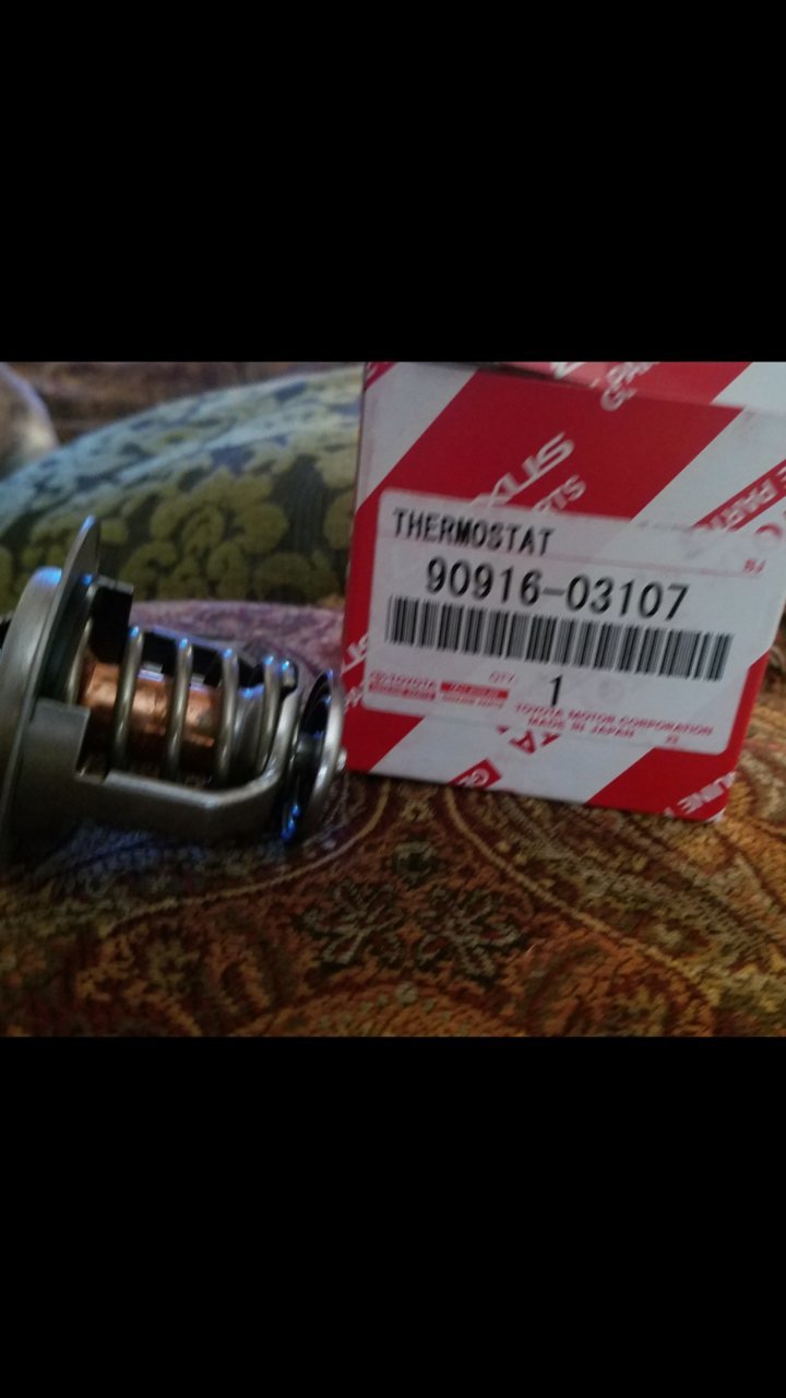

    1997tacomav6
    1997tacomav6 V6 5sp,RegCab,TVS1320 Supercharger,Haltech, 800k
    Oct 5, 2013
    #113940
    10,386
    John
    Denver
    97 reg cab, v6 5sp 300hp supercharged, Methonal Injection, 800,001 plus miles, Original Owner
    V6 5sp,RegCab,TVS1320 Supercharger, 56mm pulley, methanol injected Haltech ECU, AC Tvs1320 supercharger,(MUST DO) every 125,000- 150,000 needs rebuild Projector headlights HID 5 speed manual Amsoil for all drive train Smaller 56mm custom pulley, (MUST DO) 2004 DESNO fuel injectors, zero ping ping, 2004 side door mirrors Dick Cepek Rims, Michelin tires LTX, ATM Pathfinders Dynopro ATM ( that last 100,000 miles) Now running Dynopro ATM mud and snow tires KN cold air intake Cat back dual exhaust with ss exhaust tip, Raised exhaust tail pipe to 2" below body line Optima*dry cell battery,red top Alpine sirius radio, 200 watt amp, focal is165 split door pod speakers Focal door speakers Subwoffer behind seat Viper alarm, Electric Locks Dark tinted windows, bucket seats corbeau lg1 Tacoma Rubber floor mats TRD fender extenders, Bilstien shocks, King shocks JBA UCA trailer iv hitch, electric brake control, Drilled slotted brakes, High carbon steel (MUST DO) EBS green stuff 7000 series pads(MUST DO) TRD engine oil cap TRD stick shift, Marlin crawl shift kit. Rear sliding window 2002 4Runner functional hood scoop cut into Tacoma hood, 4Runner dual overhead map light Gentex Auto dim + Compass + Temp, garage,rearview mirror Snow Methonal kit stage 2 Custom 3 core aluminum radiator Linex bed liner Haltech stand alone ECU, Intake supercharger gauge. Stainless steel brake lines, Custom leather wrapped steering wheel, Haltech stand-alone ECU,
    Have to add this stat here for the supercharger guys,
    I ran a super stat 170, it failed 6 months later,
    Got a 170 from advance auto and it failed 2 months later,
    Both of these looked cheaply made.
    Just found out the Corolla OEM 170 thermostat fits the 3.4 motor, got it installed, everything's working perfectly
    Highways temps are 168-170
    Idling is 170-172
    jdmstuff, MatthewMay1 and Dalandser like this.

    Interesting. The thermostat temperature rating only dictates the temp that it opens at. A fully open thermostat (regardless of the temperature rating) should keep the engine operating at whatever temperature it normally operates at, right? I think I have a 10° cooler thermostat in my truck and it runs about 190° on the highway. I suspect mine may be slightly higher than some because my winch blocks a lot of airflow through the radiator.

    Been running stants for years. No issues. My 170 keeps my motor at 180-185 on hot days.

    I have a custom aluminum radiator, so it can keep the temperatures very low to the stat regardless

    Yup, the supercharger will be 20 degrees cooler with a 170 stat, win win, in summer less chance for heat soaking, more power, air will be more dense.
