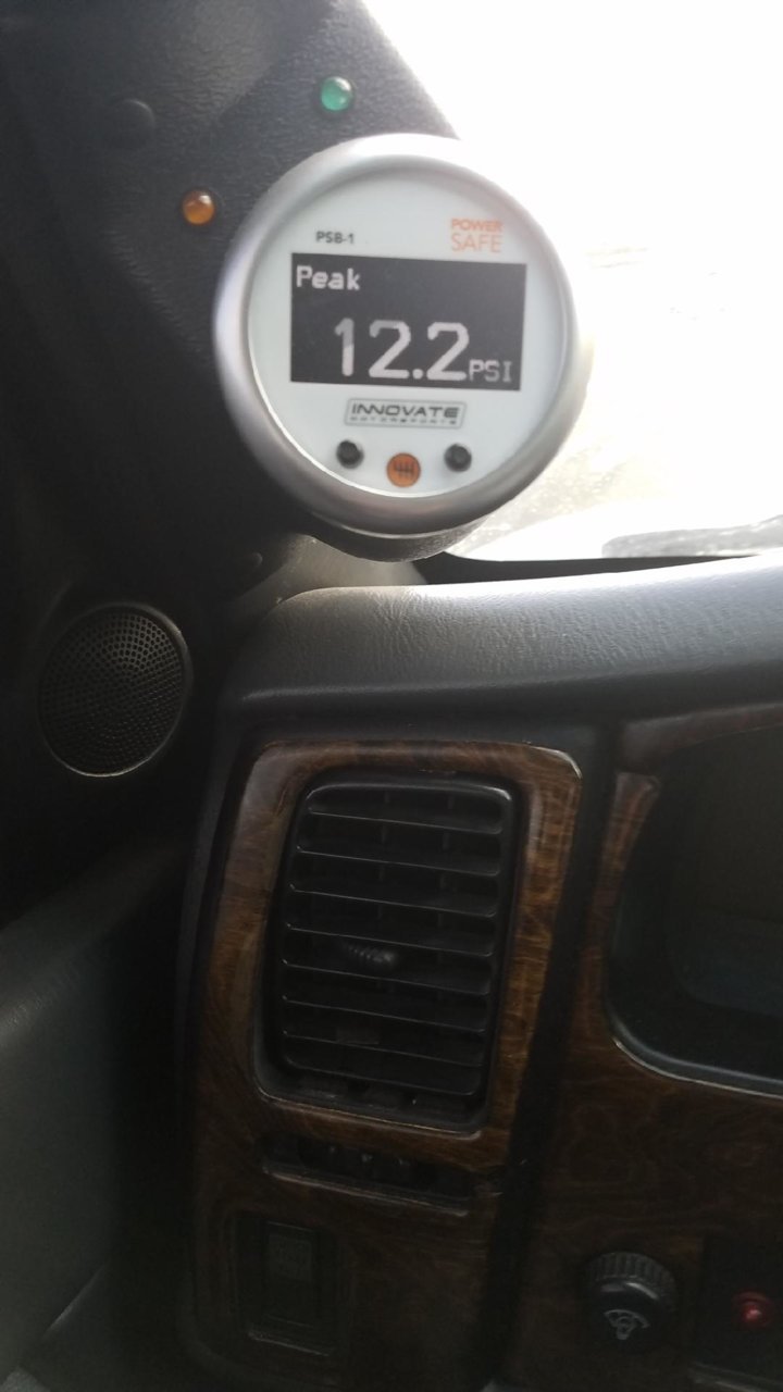

    If you have a vacuum boost gauge, any vacuum leak on the boost line will throw off the gauge and boost too.
    All connections and lines need to be 100 percent sealed from the gauge to the supercharger

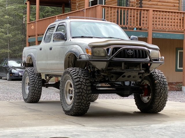

    This thread has been great, thanks for all the info. I just finished my suspension work and now I’m going to start fine tuning my supercharger, so far I have the 2nd gen with a 2.2 pulley, 7th injector setup, ordered the Gates belt and am going to swap thermostats. It runs pretty good, there is hesitation when I go from low throttle to heavy throttle but I don’t have a wideband on it yet. I’m not looking forward to trying to tune the injector setup by myself. @1997tacomav6 did you post your numbers from the headers dyno test? I read this whole thread in the last few days but may have missed it. I’m on 37’s with a manual (was an auto pre-runner) and 5.29 gears. :mudding:

    Yeah ive tested the boost gauge line and 0 leaks and it will hold a reading of 15+ psi. Thats kinda why im leaning toward the SC no longer making the boost. Still need to check the EGR port.

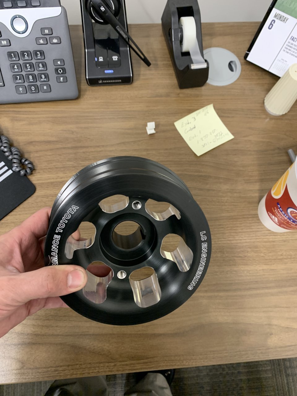

    Going to make a commitment to put the controversy to rest once and for all
    going to do a Dyno with all my upgrades
    Install this:
    Pay for another Dyno
    Just to help to TW Community (well... And and my own curiosity)
    Just so you know the dynos will cost as much as the part
    anyway... you’re welcome
    lol

    You won’t make more power. The point is to reduce rotational mass at the crank. Which should help you accelerate faster. I didn’t notice much of a difference.
    EDIT: Save the cash for more mods.
