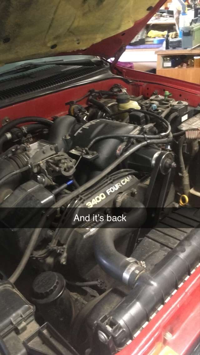

    And I've got it all back together, sounds good to me, makes ~5 lb of boost constant (I'm using a d shaped thr body gasket while the good one is in the mail.) And it sounds good, except for the idler which is yelling at me lol. Really happy to see the engine bay cleaner and spicier today. Can't believe I completely took it apart and off just to realize that the boost gauge was hooked up incorrectly from the factory. Loving the sound coming back to me from up front and the extra punch.

    Pretty! That’s a clean engine bay! I wish my blower had a cool TRD logo on it
