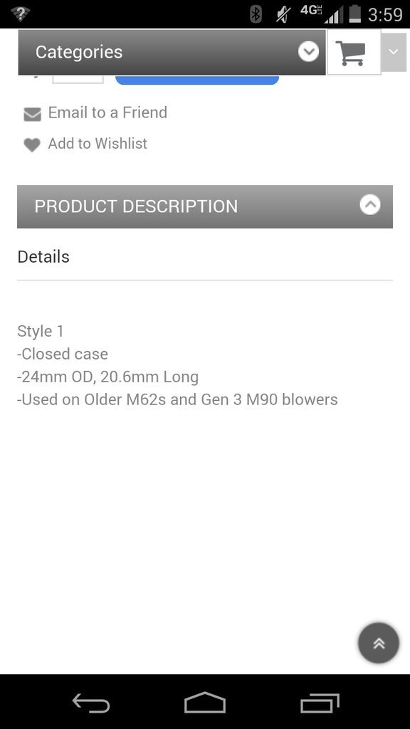

    These are the ones
    Those are them, the ones at zzp are a bit more expensive, but they come packed with higher temp grease.

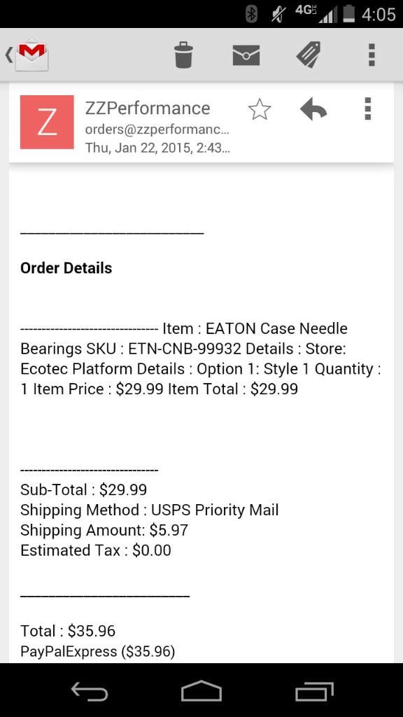

    Good deal! Here is my invoice from when I got mine.
