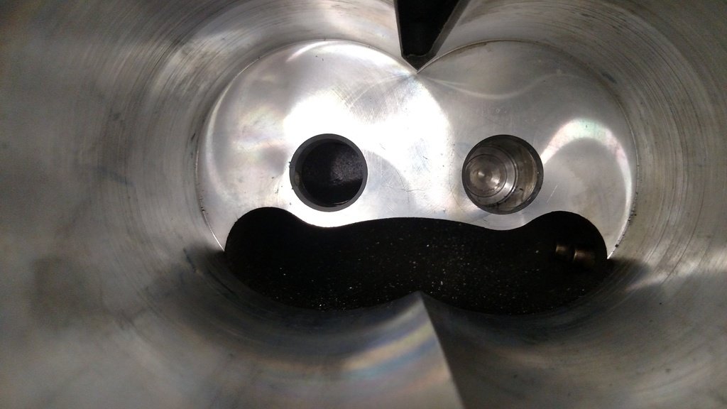

    Just going to throw this pic out there as a heads up. I guess not all the S/C rear bearings will just fall out the back. I ended up having to take mine to a local race shop to get them pulled and the new ones seated. These bearings had ~175k miles on them.
    But you can easily see that right side does not go through the back into anything. Even the left side would be a little tight IMO. This is a second gen supercharger.

    They definitely fall out if pressed through. They will come out of the third intake manifold after you shake it around. Scared the poop out of me doing it for the first time but it does work. I will be doing mine soon and can take a video for reference.
