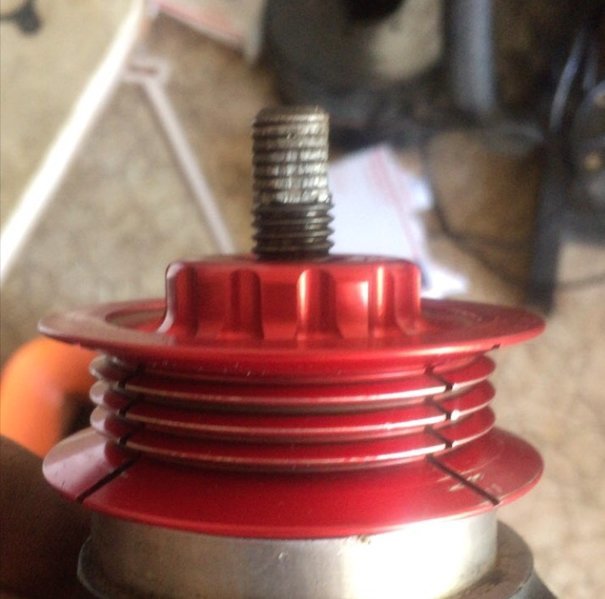

    Anyone here replace the nose cone and have a spare shaft ?? I kinda destroyed mine. Fixed it slightly but would like to put a new shaft if i can find one for cheap

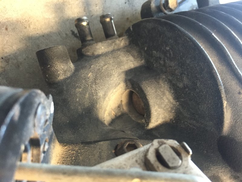

    Hey folks, 1st time poster here, but I have tried searching high and low for this answer but I need help with removing the bearings at the back of the supercharger. I read that you can tap them out.......that failed on the first bearing I tried. It seems to be stuck on the back of the supercharger housing itself. Not to mention my dumbass punched out the back of the bearing while trying to tap it out.......so thats all jacked up for now.
    Onto the second bearing where I tried pulling it out with a slide hammer.......the damn bearing will not budge what so ever.....
    Any thoughts, suggestions. At this stage I am open to just about anything.
    Thank you in advance for any help.

    Do you have this hole?
    They press straight out
    TashcomerTexas likes this.

    Apr 16, 2014
    #127853
    10,104
    2003 TRD DC King Ranch Edition
    :popcorn: I will be at this stage on my grey charger when I get home.

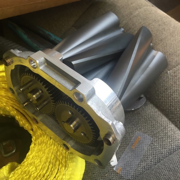

    Just got this from them ;)

    Also this ended up wrking out fine
