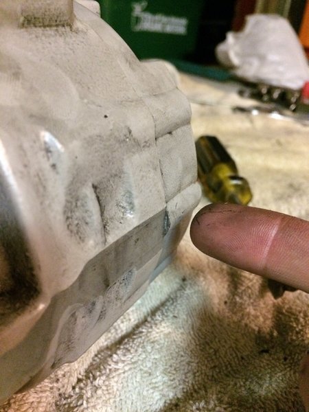

    Used a pry bar with the sc on the floor
  2. Jun 22, 2016 at 6:20 PM
    #302
    Aodhan18
    Aodhan18 Member
    Jun 22, 2016
    #190291
    7
    Yep, you guys are of course, right. I managed to get them out. I was wary of using to much pressure and that was my problem. Like what Anthony250f was saying, it did marr the out side of the housing a bit, but they did come out! Now to press the new ones back in at start buttoning every thing up again.
    Thank you for all the fast responses!

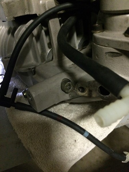

    Helpful question of the day: does this bolt need to come out to take the intake part off?
    I finally managed to grind down a 10mm wrench to fit on the screw back here. But this bolt is a real bitch. @SCRunner12 i know you've rebuilt these
    Trying to get to the needle bearings
  7. Jun 24, 2016 at 9:59 PM
    #307
    SCRunner12
    SCRunner12 Tundra Troll
    Aug 8, 2011
    #61363
    9,115
    Robert
    Santa Cruz, CA
    2006 Tundra DC, TRD, 4wd
    Yeah you do. That 10 mm on the back is a giant pita. I do not miss that bolt at all.

    @SCRunner12 how are y'all getting the rotor plate off? I've been trying to hit the edge with a screwdriver and mallet but no dice.
  12. Jun 25, 2016 at 8:01 PM
    #312
    TashcomerTexas
    TashcomerTexas My truck is a whiner
    Apr 16, 2014
    #127853
    10,350
    2003 TRD DC Supracharged
    And I still have the gears on, don't think they need to be pressed out to get the rotor plate off
  13. Jun 25, 2016 at 8:02 PM
    #313
    anthony250f
    anthony250f Well-Known Member
    Feb 18, 2012
    #73066
    16,774
    Anthony
    San Diego, CA
    2008 dcsb trd offroad 4wd
    No don't remove the gears. Just pry
  14. Jun 25, 2016 at 8:08 PM
    #314
    TashcomerTexas
    Apr 16, 2014
    #127853
    10,350
    Where should I be prying? These flatheads are too thick for the gap.
  15. Jun 25, 2016 at 9:07 PM
    #315
    SCRunner12
    Aug 8, 2011
    #61363
    9,115
    Robert
    Santa Cruz, CA
    I hit mine with a rubber mallet pretty hard all around. Then took a spackle knife and lightly tapped in between the rotor plate and housing. Took a bit of persuasion but worked.
