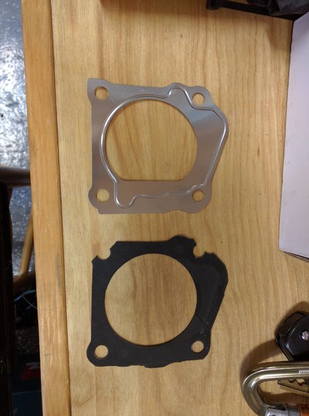

    image.jpg Alright I swear my final question on this subject. I have the supercharger back on and connecting the throttle body but the gasket that the toyota dealerships gave me looks wrong, or at least I think it's wrong. They swear up and down its fine, but what are your thoughts about using the one they gave me.

    Like normal the dealership is retarded. I took the metal gasket and opened it up to a full circle for the proper airflow. Toyota started putting out the full circle gaskets later on. I wonder why the dealership is still putting out the old gasket.

    The silver is wrong, it's the old non-SC one and will cause vacuum leaks.

    Yea that's exactly what I thought too. Went and got a sheet of that cut your own stuff. Will do that later tonight.
