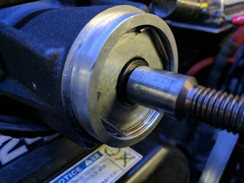

    Hey guys,
    Can anyone help me out with my problem? I just rebuilt my supercharger, everything went back together great, but the nose is leaking oil...I assume from the bearing. Any thoughts as to why? Did I not seat the bearing enough or forget something? Has anyone had this problem?
    Any help or insight is appreciated.

    Either you messed up the seal, or the seal surface is "grooved"

    What kind of seal did you use?

    I used the kit from Rolling Performance. Could it be the seal and not the bearing?

    So where is it leaking from, the front of the nose cone or the back?

    I've heard of people having issues with the viton seal being too stiff and causing leaks. It is most likely that and not the end of the world as long as you add oil from time to time.

    Here is the front where it is leaking.

    Is that the oem seal or from rolling performance?

    OEM I believe.

    Yeah I would order a new seak and install it. Just remove the oil with a syringe and pull the seal out by puncturing it. Then press the new one in. No need to remove the SC.

    I can't remember why I reused the OEM one. I got one from rolling performance... Maybe I damaged it. Oh well, I'll try that.

    Yeah they get wonky when removed. Try that and see what happens.
