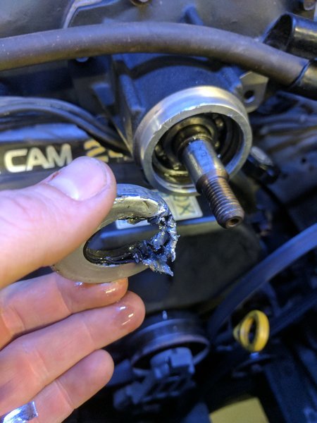

    Sooooooo, what happens when the old leaky seal won't come out?!IMG_20161230_212003.jpg

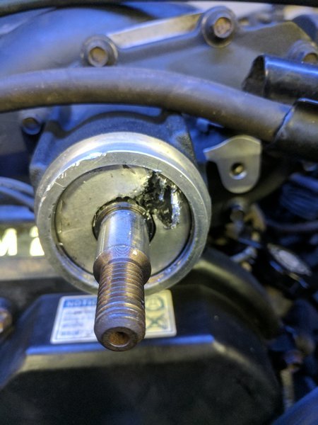

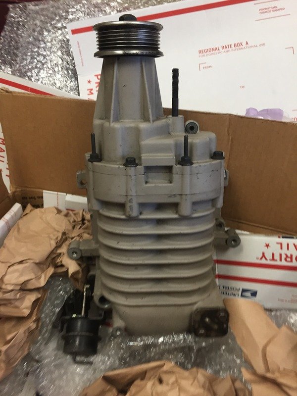

    I have some potential great news for anyone with a 1st gen SC. I was doing some research and found that Pontiac used a similar M62 supercharger back in 92-95. So I went to ebay and found a used SC and placed my order. I bought used as it was $220 shipped to my place, but you can find completely remanufactured ones for $700 all over the place ($500 + $200 core charge). I went used because this was an experiment and I didn't want to pay a $100+ restocking fee if it didn't work out. Also you should be able to find these any salvage yards all over the place as they aren't a highly sought after SC. Based on first impressions and review it looks like this will work perfectly. It is indeed a M62 and looks to be the right dimensions and an exact copy of the 1st gen SC. Also, even better news, the nose cone and drive direction of the Pontiac SC is the same as the TRD. That means you simply just pull the rotor pack and nose cone out of the Pontiac SC and place it right into the TRD SC. No other modifications needed.
    I will be doing a full test fit this weekend and verify my findings, but this could be a very beneficial route for anyone with a 1st gen supercharger as nose cones are discontinued and rotor packs are only available rebuilt and expensive.
    Details on the supercharger:
    Pontiac Bonneville 1992-1995 (this is important as they switched to the M90 in 1996)
    There may be other years/models of Buicks and Pontiacs that run this SC, but I'll have to do some research.

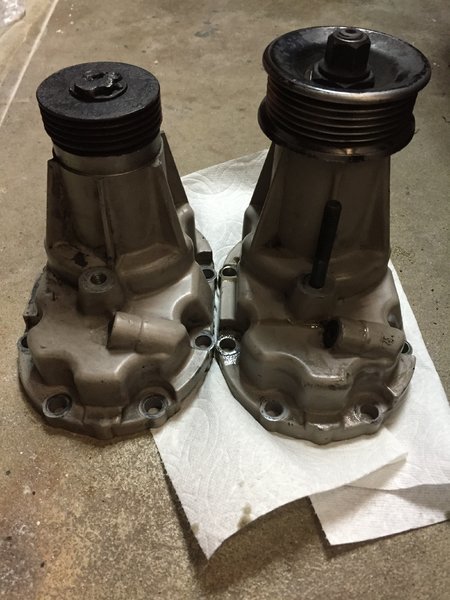

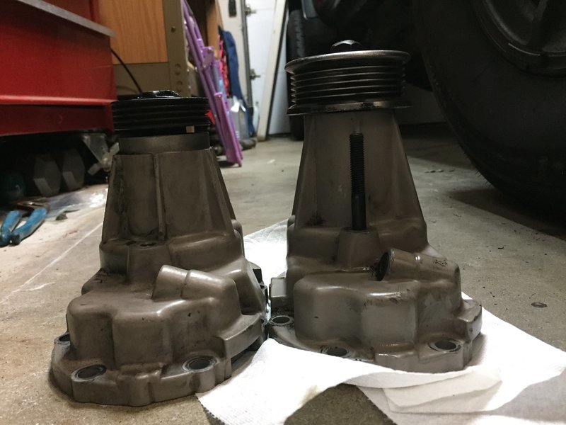

    Update, i got the Buick SC apart and the rotor pack fits like a glove lines up perfectly and drops right in correctly to the TRD housing. The nose cone is also the right rotational direction and thus no need to repress and gears. One thing about the nose cone is the shell is shaved down at the top by the pulley. Not sure the reasoning but the Buick is a complete shell and this may cause rubbing on the pulley potentially, will find out tomorrow. Also the shaft looks longer since it has a larger pulley but my busted TRD nose cone isn't a good judge for that.
    Overall though, they are a great source for rotor packs and should work perfectly with the nose cone.
